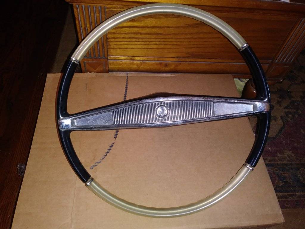

The steering wheel i got from member boltupal is in way nicer shape than the pics suggested. Of course, the '64 metal ribbed center is different than the '65-'66, I'm hoping the later woodgrained center trim swaps to the early wheel.
Hmmm...I found out something new today while getting ready to install that new '64 steering wheel. The wheel diameter is a full 1.65" larger on the '64 wheel, so the horn arm is longer, as well. So, for now, I'm gonna install that earlier wheel and the ribbed horn bar as-is. The '64 wheel is in way better condition. Might look odd to us, but 99% of people out there aren't gonna know, unless it's pointed out.
This week, the weather is gonna be in the mid-'80s, so this will be a perfect opportunity to get all that installed.
Would have never guessed in a million years that they changed the wheel that much between '64 and '66.

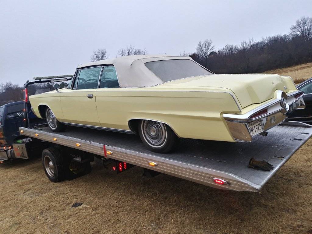

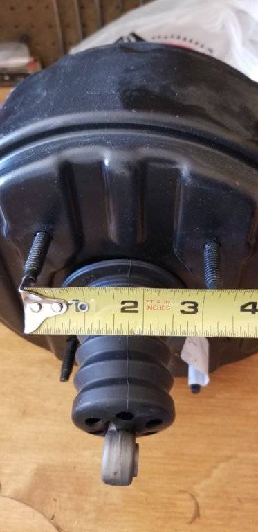

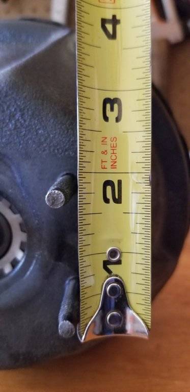

What was supposed to be a day job on the Imperial work (shocks, brake booster, oil change), is now a wait for a proper booster. The one in the car was wrong to start with; and the replacement, though identical, had the brake rod 1-1/2" too long and the mounting studs 1/4" too close. So, for now, the shocks are in, and the oil changed and fluids checked. Got a line on a '66 booster from OR, I'll know tomorrow if it's available.
Pictured are the removed part and the planned replacement. And my car on the rollback.
This booster was rebuilt, by booster dewey, and has been on a shelf waiting for the rest of the parts gathering for my 70 300 build. That's still on the horizon somewhere, so I'll offer it up if it will work on your 66, as I have several cores. Ben
Measurements of the back and front.

-Steering wheel removal and installation of the restored wheel ($$$!): I found from Boutupal, a very nice'64 wheel assembly. It is 1.65" larger than the '66 wheel. I'm going to run that this Summer, and maybe I can get the old one restored...for $1,600 and change(!!!)...but it'll be perfect!
