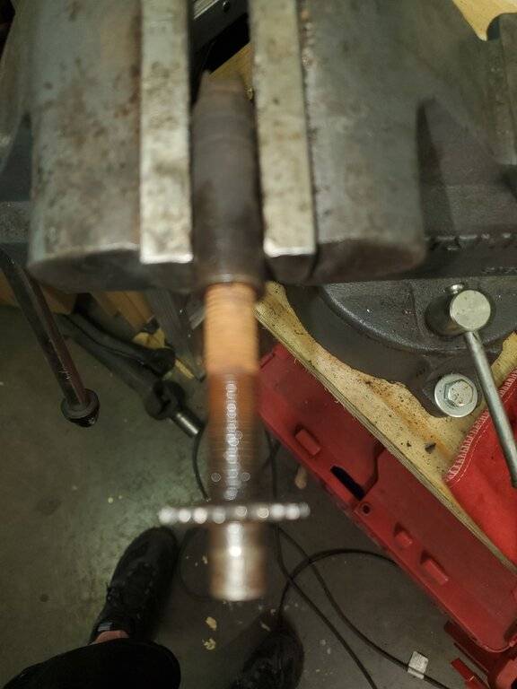

There's a trick to getting those P/S pumps tight again, but I don't remember it. Back when my '66 New Yorker was a daily driver I jammed a chunk of wood down in the bracket to keep it tight. It had been fine until I loosened it for some repair I was doing, then was never able to get it tight again. I may have just not had the right tools back then to crank down hard enough on the bolts. There's also a rubber bumper on the bracket that wears out/falls out.
Jeff
Here ya go:

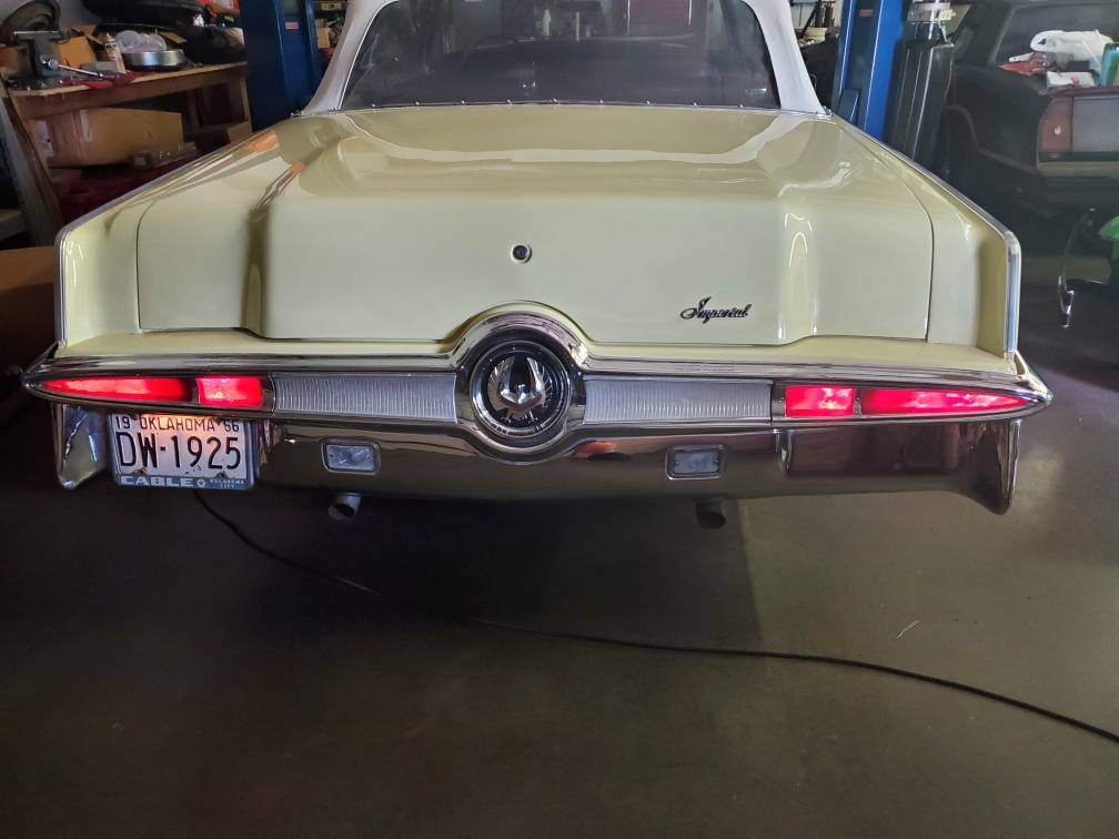

Great news! My light problem is solved. A combination of wrong bulbs, a loose wire at the column, and a new brake switch that failed to engage when the brakes were applied (installed at the booster/dual master install) all contributed to the no light/no turn signal problems. The grounds were fine. Plus, the front brakes needed a better adjustment, which is done. He is going to do a NSRA safety inspection tomorrow, and I'll pick it up Tuesday. Now, to finally enjoy the car after 19 full months of inactivity!
