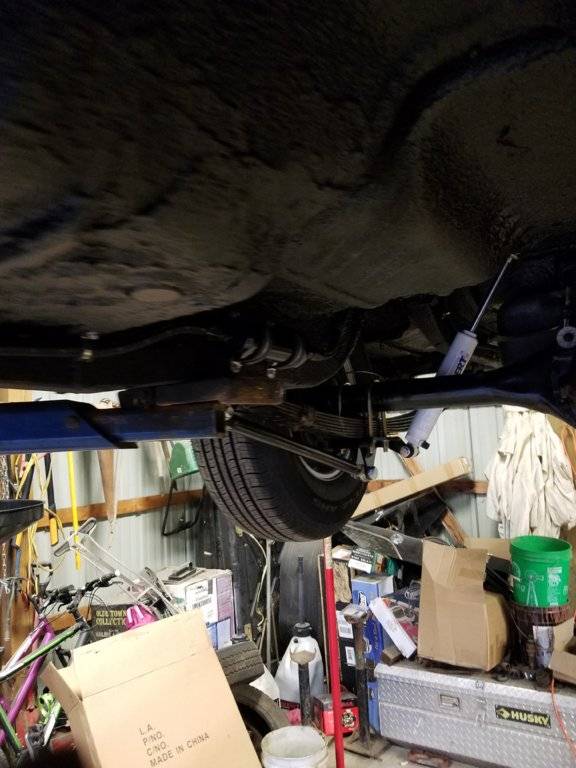

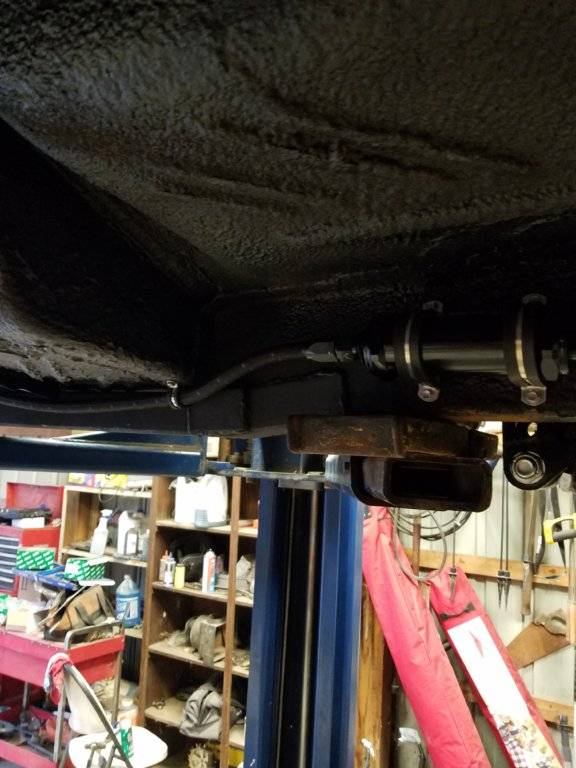

I'll have to grab some more pictures. It' finally sitting back on all four wheels. Got a new fuel tank and welded in a sump. New sending unit installed and blocked off the factory feed. Also undercoated the underside of trunk and frame rails before installing tank. Will be running -8an from tank to fuel pump. With a filter in between.

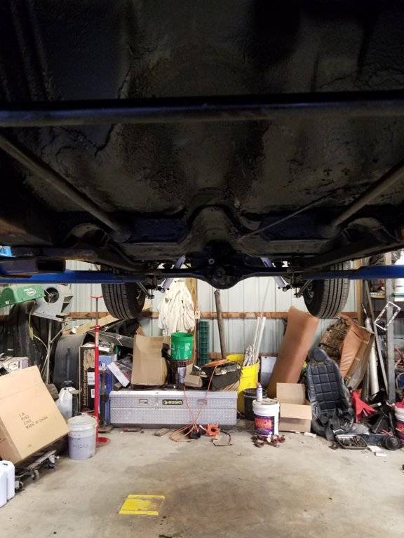

Actually got some work done. And snapped a few pictures if they load. Got the subframe connectors in, fuel filter mounted and line ran to engine bay. Grille swapped to a undamaged one. Also finished undercoating. Seemed easier to recoat wear spots than strip it all.

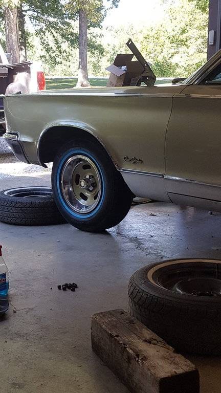

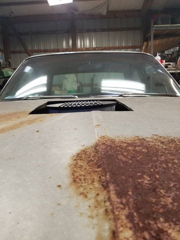

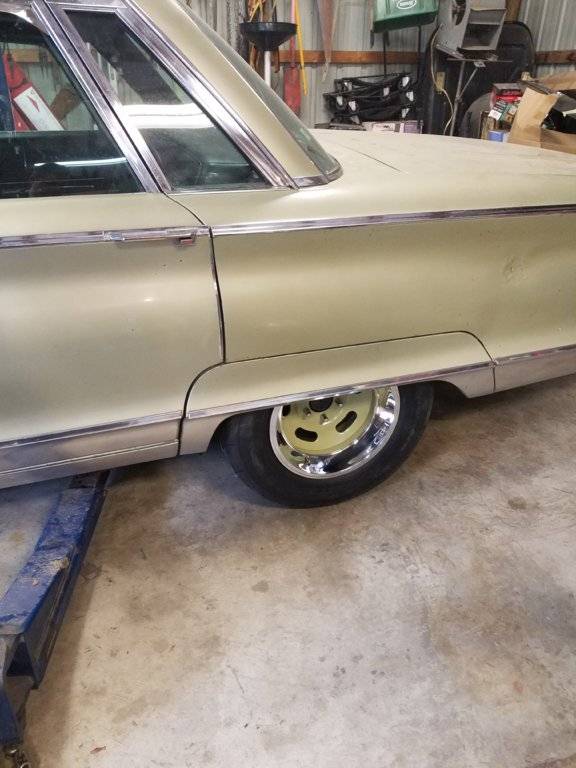

Weekend wasn't as productive as I hoped. Started with finding a leak from the Master cylinder. Ordered a new one. I installed the mock up block and transmission. Got the driveshaft in and test fit the tti headers. They mention in instructions you may have to slot the motor mount hole. I did not need to. Routed shift cable and it is too short so ordered a 6'. Mounted up my go fast tires on matching 8" wide wheels. 255/60/15. Fits well and I can still slide my hand between sidewall and skirt. I still have a full set of street tires on the 7" wheels. Then I stuck a intake on and spacers to get the height of my combo the real engine will be and determined a scoop will be necessary. So I cut a hole in the donor hood and got a scoop ordered. Will have to cut hole bigger once I get the scoop. Sounds more productive than reality. But I spent saturday at the track watching a friend of mine.

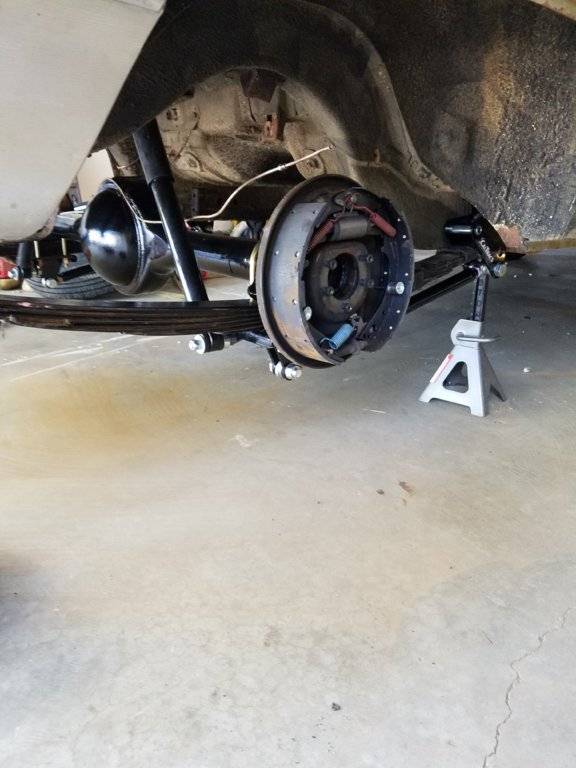

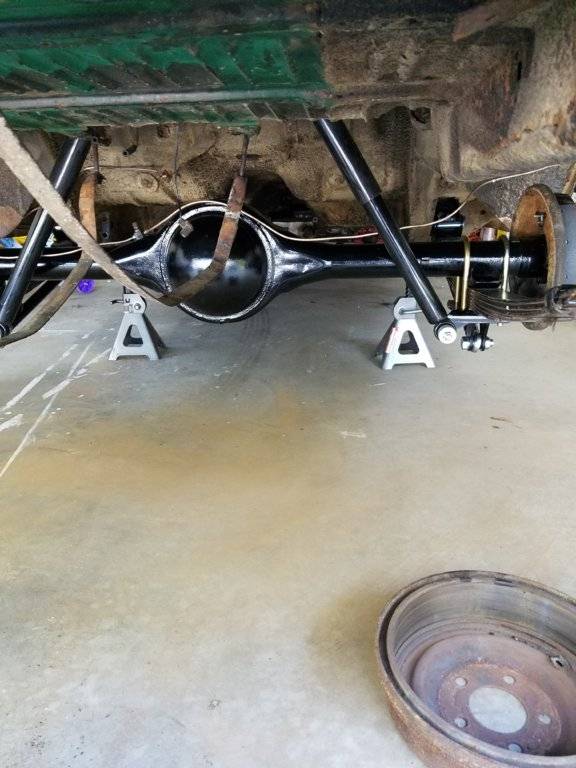

I used caltrac shocks to go with the caltracs in the rear that we pulled off my father in laws car when he backhalfed. The front has something new nothing special. But the ball joints and tierod ends all have the boots cracked and since everything else is new the frontend needs adressed

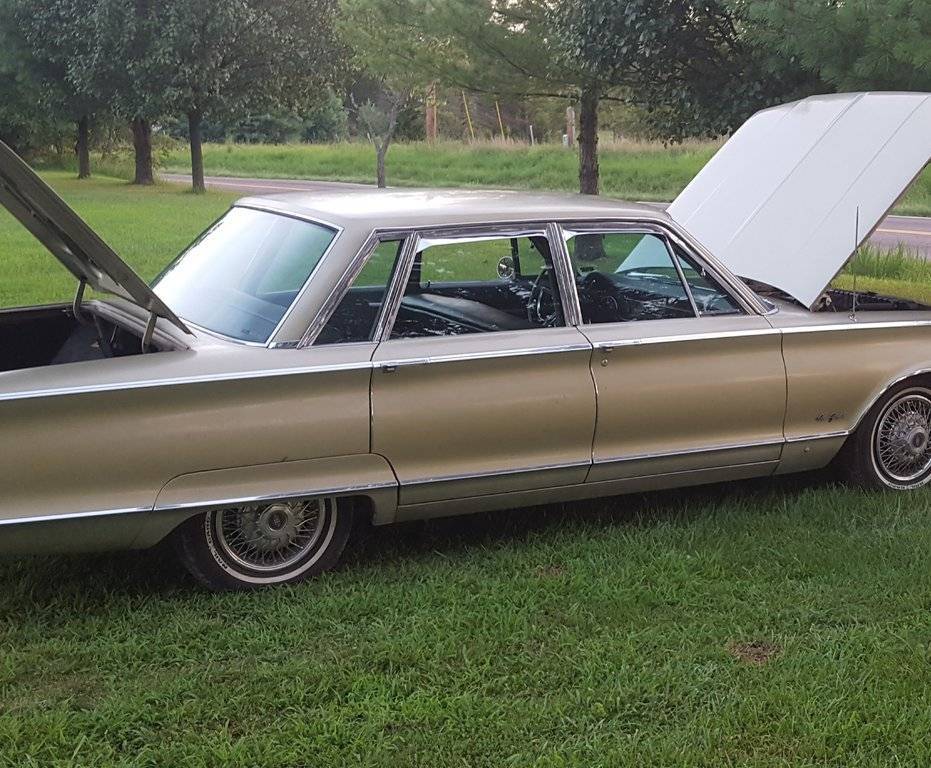

So i decided a formal build thread would be good. Wont be completed until spring time is my best guess. But here it is. Starting with a 66 new yorker with clean interior clean exterior ran pretty rough. Motor is half apart and getting ready to head to the builder. Transmission is almost done. Updating to front disc brakes and redoing all the lines and rear drums. Got some swap meet wheels powdercoated to match the car and some new cheap rubber. Enterior is original and in excellent shape and will remain untouched aside from a floor nounted cable shifter. A lot of parts stacking up with much more to go. Ill post later to update the plans on the engine, and specs on transmission
