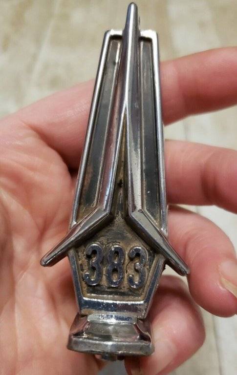

1966 Fury and Sport Fury with a 383 owners.
If you have the original hood ornament .
What color is the mylar insert on the backside.
Im finding 2 different ones. A gold one with black letters and a silver one with blue letters.
Which is correct
I just looked up part numbers in my book and for a 1966 Fury with a 383 # is 2579765 , for 1966 Satellite / Belvedere is # 2579874
So Im thinking the difference is the body style determines the color???????
The front side should look like picture #3
FYI, 1967 cars used a completely different style ornament
Without verification in the parts book . . . first thought is that the "gold" background would relate to a 4bbl engine and the silver background would be for a not-4bbl engine?
Just a gut suspicion, all things considered,
CBODY67
CBODY67
Parts book doesnt specify engine rating.
Just different number for the different body style
