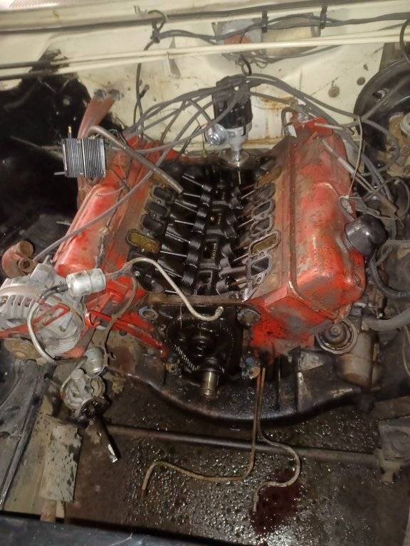

I haven't gotten to the under side yet, But I've basically stripped down to top side. here's a few pics of my progress.

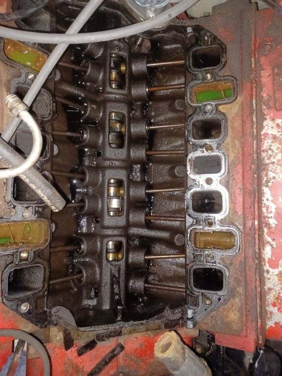

intake off, driver side valve look ok, passenger side are pretty oily and got some carbon build up.

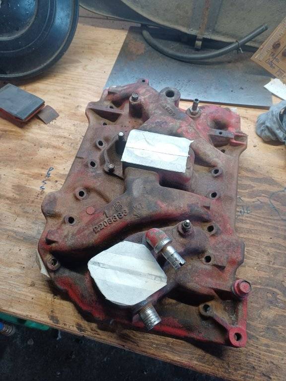

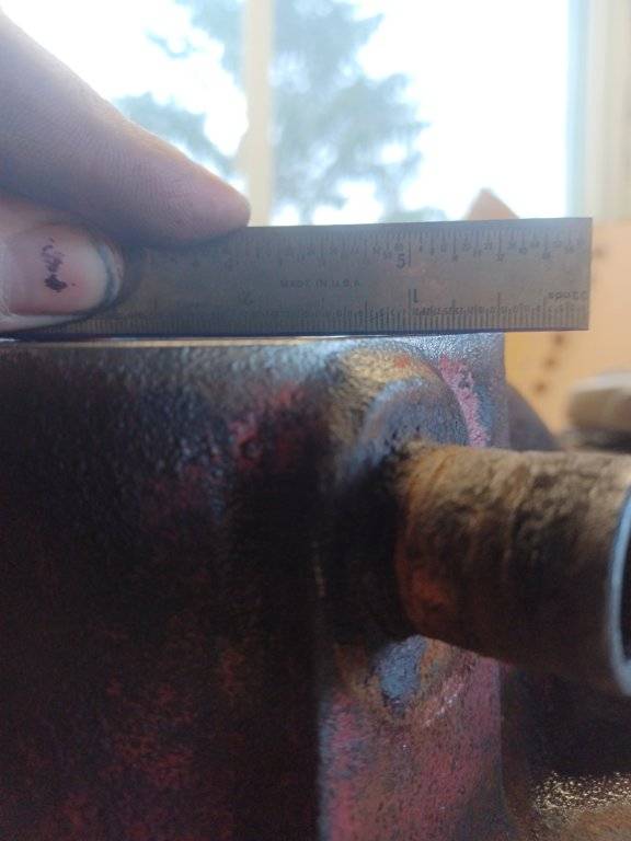

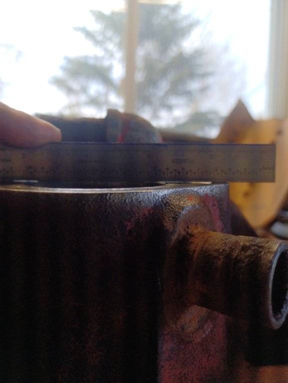

thermostat housing surface is still pretty rough and uneven after cleaning off the gasket material.
Took some very high grit sand paper on a block to smooth it out. Not that you could tell with my super pro photographer skills
All mating surfaces and hose barbs nice and cleaned up.

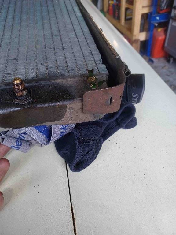

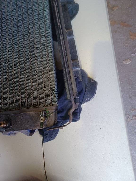

then I pulled the rad to make getting the rest out easier.
where I discovers that one side has come apart, guess I'll have to try my hand at soldering it back together when I start putting it back together.

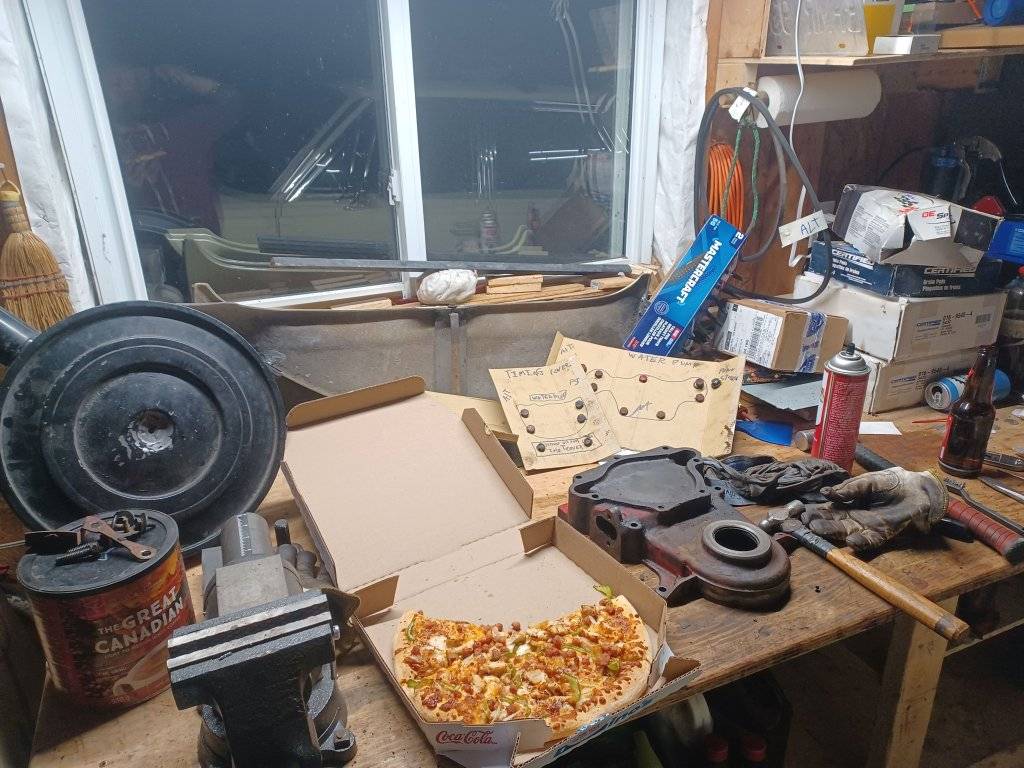

got the whole front of the engine off now.
then I took an all important beer and pizza break.
I've also got the timing chain and valve covers off, but looks like I didn't get any pics of that.
