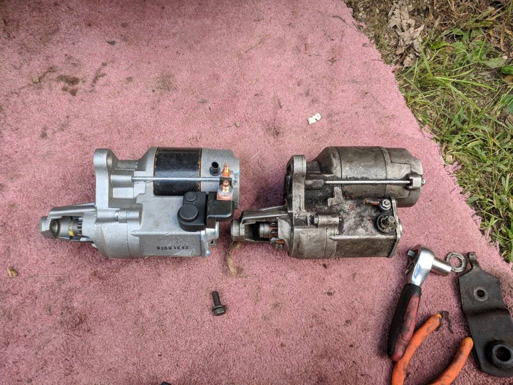

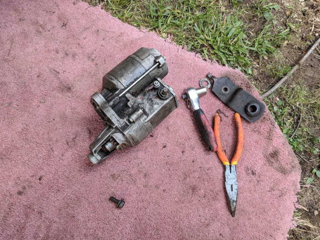

I suppose the old one has to go back for a core? The most common problem I see with the Nippondenso is the solenoid plunger and contacts. You can get a kit for the contacts, clean and reuse the plunger or get one from a rebuilder. The small wire stud may be a little bit trickier.It's out, I had to remove some of the linkage for the transmission to get it out the backside of the engine bay, along the frame rail all the way to the firewall.
The little nut is stripped, and won't tighten or loosen, a quick crimp of a terminal and back in the new one will go.
It's always been like that, since I installed it, it's been loose. It always spun and started well, until the wires melted!I suppose the old one has to go back for a core? The most common problem I see with the Nippondenso is the solenoid plunger and contacts. You can get a kit for the contacts, clean and reuse the plunger or get one from a rebuilder. The small wire stud may be a little bit trickier.
Dorman Products - 02349
I have had a couple of the motors apart and the bearings were always good and brushes looked good.

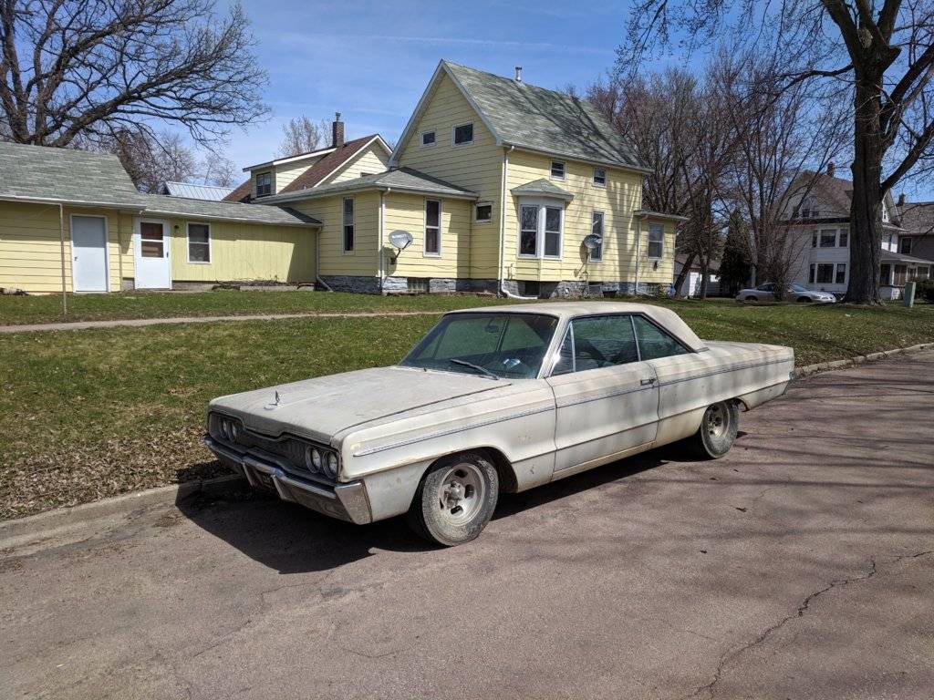

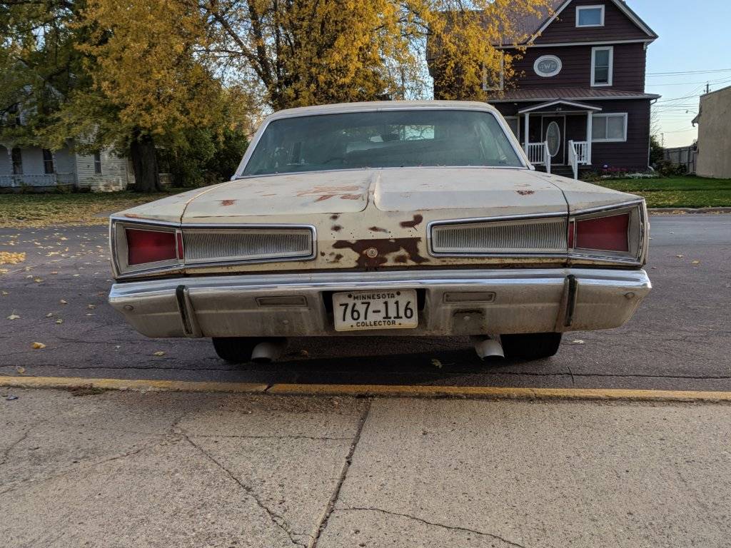

She sure is pretty though. Are the brakes a vacuum issue or are they just physically spent?It's home for now. Runs like crap below 3k RPM, have to go through carb first, see what sediment is in it, and go from there. Runs awesome over 3k RPM, but chug-a-lug under it. Brakes are sketchy as all get out, but in the ten mile drive home, it all came back to me, pump, pump, pump, pump, and pump some more. Going to find me some rear drums to slap on to keep it on the road, and I should have better stopping power. Then it's back to storage, and get the 500 home, and ready for the open road.Tomorrow I'll be returning the messages left by the building suppliers I've contacted, try to get the ball rolling on my own building.
The rear drums are way beyond max wear point. The brakes have always been an issue, but what fun is driving an old car without being on the ragged edge?She sure is pretty though. Are the brakes a vacuum issue or are they just physically spent?
I should fix most of the issues in one shot.Tell me about it. Mine doesn't know which line in the road it likes best ... like a dog on a lawn of treats.The rear drums are way beyond max wear point. The brakes have always been an issue, but what fun is driving an old car without being on the ragged edge?I should fix most of the issues in one shot.
