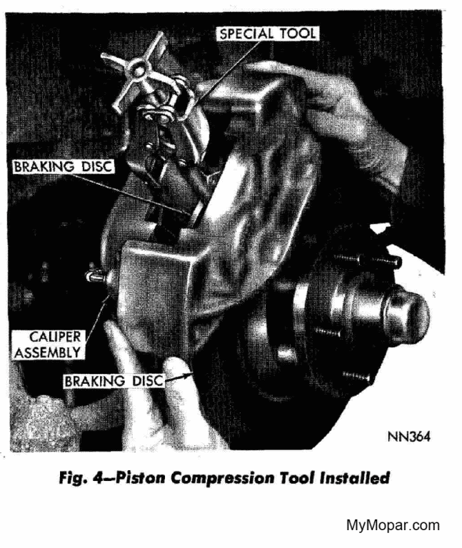

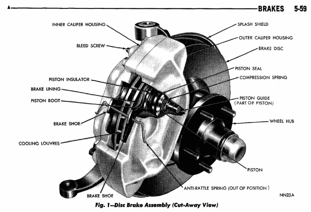

Hello all, I'm currently redoing the front disc brakes on my 1967 Chrysler New Yorker 4 door. It uses the Budd disc brakes. Craig from Mobileparts saved me, and provided me with NOS pads. He's very cool. I have NOS rotors, that had some rust, so I had them turned. I have rebuilt calipers that I have been running on the car already, and they work well. I had a heck of a time getting the calipers with the pads back on the rotor. In fact, I had to separate the two half of the caliper, put the pads in, and bolt the two halves back together! In the 1967 Chrysler manual, it says to use a Chrysler tool, Piston Compression tool C-3992, which I do not have. There was no way I could get the caliper back onto the rotor with the new pads. I got everything together on the driver's side, and it seems very tight! Basically, the two halves are together, pads are in there, but dangit, are they supposed to be that tight? oof!
