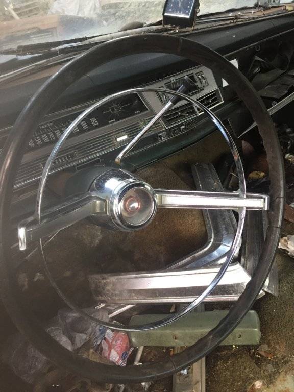

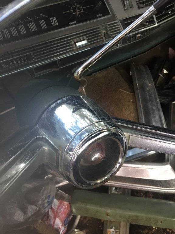

Dec 21, 2017 #1 mindshark13 Active Member Joined Dec 8, 2014 Messages 373 Reaction score 251 Location tampa fla. Can anyone tell me how this horn ring comes off ? I'm trying not to break it.
Dec 21, 2017 #2 detmatt Old Man with a Hat FCBO Gold Member Joined Nov 14, 2010 Messages 28,559 Reaction score 28,437 That center cap might pop off similar to the tilt/tele wheels.
Dec 21, 2017 #3 Polara_500 Senior Member Legendary Member Joined Apr 17, 2011 Messages 3,193 Reaction score 3,144 Location MinnieSnowta Try rotating the outer cap ccw a little bit and it may come off in your hand, then there should be 3 screws down inside the opening now revealed.
Dec 21, 2017 #4 OneEyed Active Member Joined Mar 30, 2014 Messages 440 Reaction score 197 Location Iowa Center cap pops off like a Pringles lid. There should be a notch or slot on the seam to show where to pry at. Use a plastic pry bar if you have one...
Dec 21, 2017 #5 mindshark13 Active Member Joined Dec 8, 2014 Messages 373 Reaction score 251 Location tampa fla. Ok I'll give it a whirl.... Thanks everyone

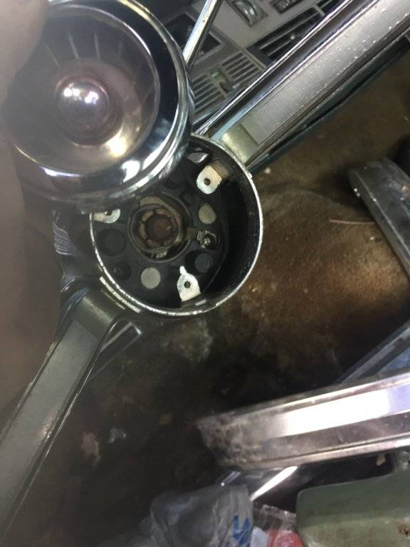

Dec 21, 2017 #6 mindshark13 Active Member Joined Dec 8, 2014 Messages 373 Reaction score 251 Location tampa fla.
Dec 21, 2017 #7 detmatt Old Man with a Hat FCBO Gold Member Joined Nov 14, 2010 Messages 28,559 Reaction score 28,437 There you go, just like downtown!
