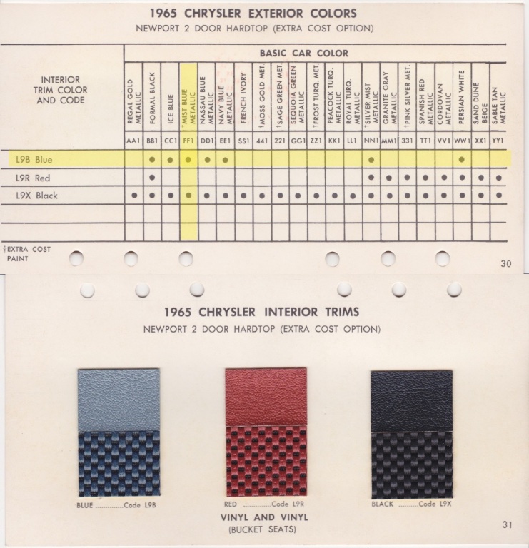

Under TRM R=9 which says special order or leather. Was leather an option in the Newport this year?

L9B is an optional vinyl and vinyl bucket seat interior for a '65 Newport. It is compatible with FF1 exterior.
