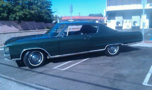

Rare 1967 Mopar 2 door- Dodge Polara 500 with original 383 big block and automatic 727 transmission with floor shifter. This vehicle is all original with factory air conditioning and new black interior with bucket seats. This mopar is a beautiful dark green (GG1) and it just needs new paint. It has some minor rust by the rear window. Comes with the original build sheet and has a clean title (not salvaged). This vehicle is not perfect that's why the price is $6,000.
Nice looking Polara, but 6,000 with rust issues?
Nice Polara 500. Too bad there wasn't better pictures.
Yeah I like this one too in spite of the green.
I'd like to see the extent of the "minor rust" by the rear window, potential issues there....and what is called a "minor" issue on the CL ad is in reality a sizable problem when you go see the car in person.

All the pics showed a great looking survivor but three pics were puzzling.
How does a trunk (as well of the rest of the car) look this good and the Dutchman panel and trunk lid be so bad??
Also asked him to look at the pic he posted on CL and what was going on with the right C-piller. He said he didn't see anything...
Without a personal inspection which is impossible, this ain't going anywhere.
The car is not that valuable where it's feasible to hire an appraiser...
The trunk has been sprayed over I'd say but seems to be solid, you see the welding spots clearly for example. As long as the trunk has no water leakin in it's possible, other explanation would be some old collission repair that wasn't done too well you often see rust in the seams or along the spot weld areas, but not to tell by the pics.
It has been sprayed, I'd like to see the underside, it doesnt look replaced to you?
Looks like some sprayed over rust around the spare tire area.
