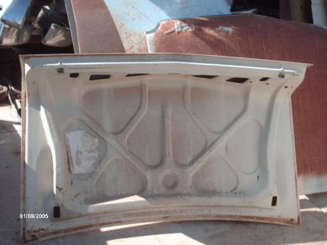

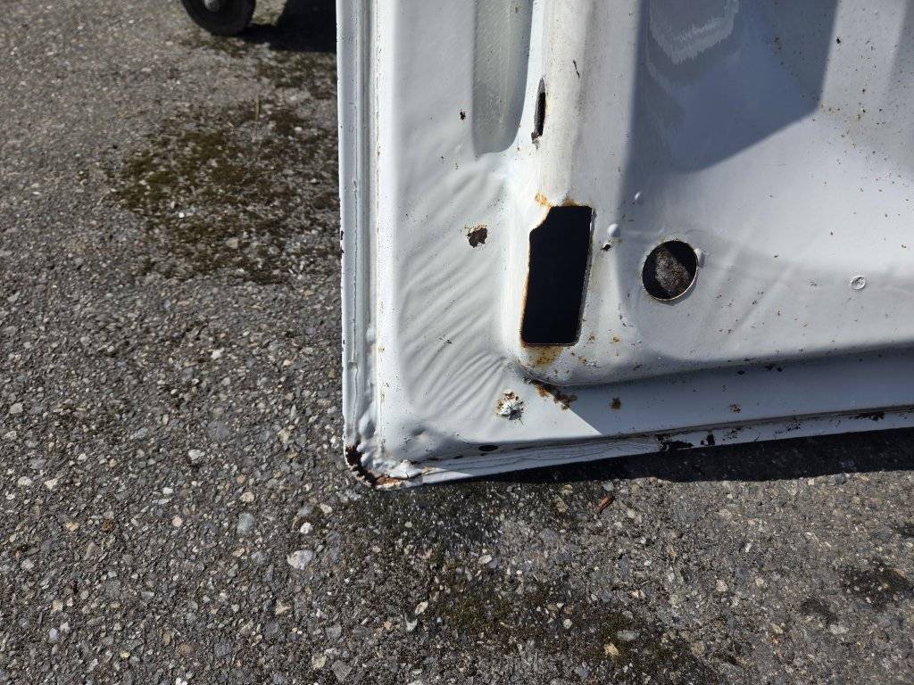

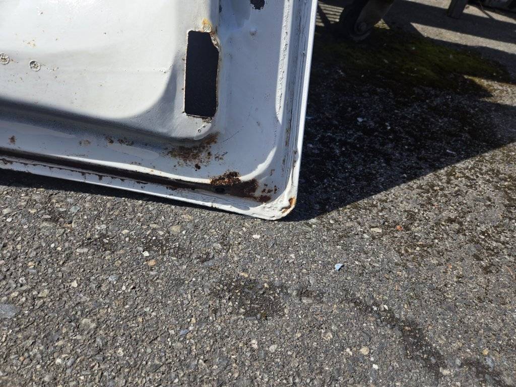

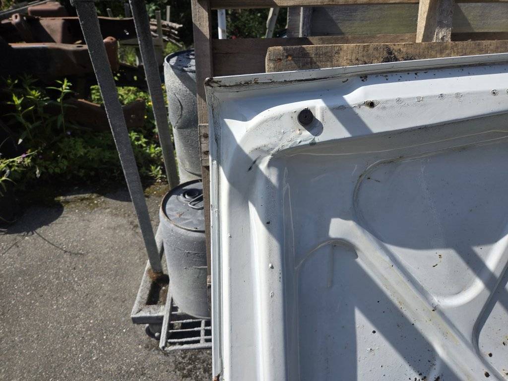

I think these are the Achilles heel of this design for rot. I have seen many a 67/68 Imperial that were overall rot free, except for the trunk lid...my 68 convertible included... the corners were just gone on mine and I was lucky to find a rot free replacement.
I have one available. Imagine how nice it was when I put it outside years ago? ( under cover)

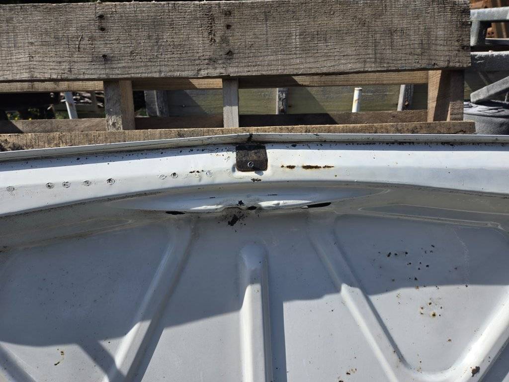

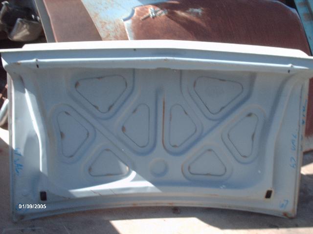

I don't know about these but on other Chrysler products they started NOT punching out the areas in the inner trunk lid panel. I know on the 67 A-Bodies the panel was cut out, in 68 they were not, this if the case may make a difference in weight.
In my 40+ Mopar years I just learned of this a year ago or so.
