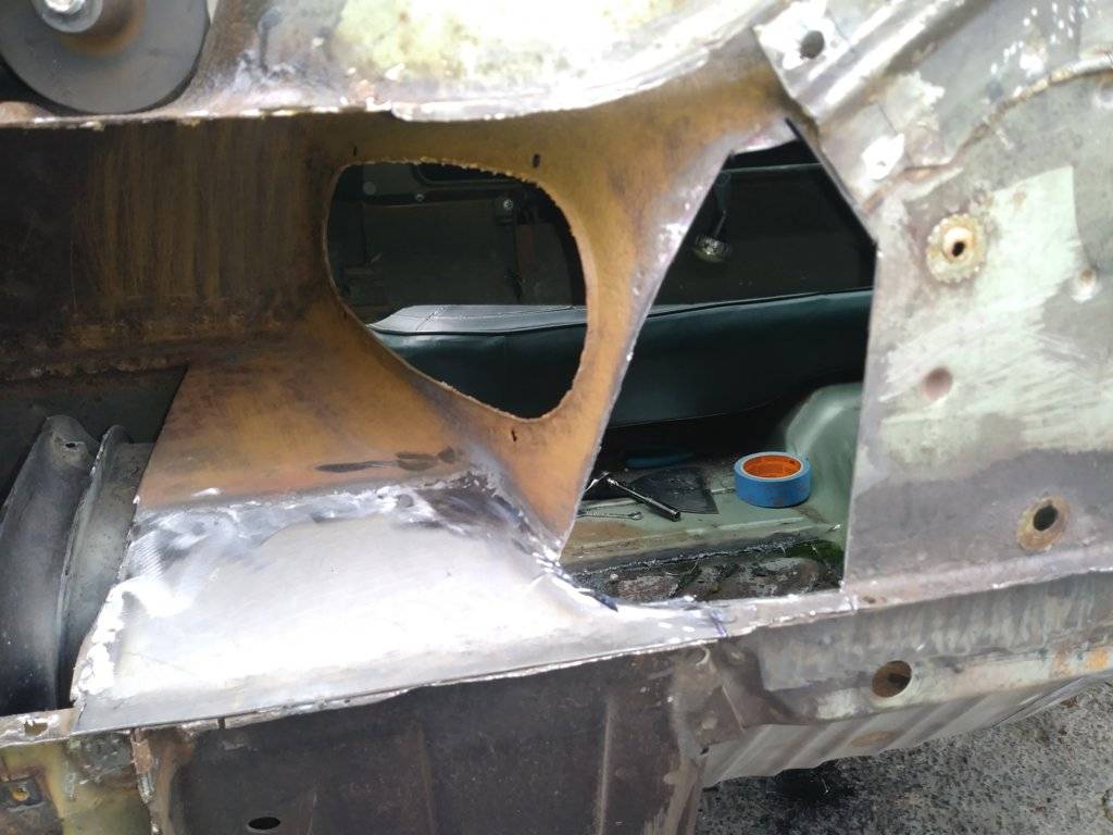

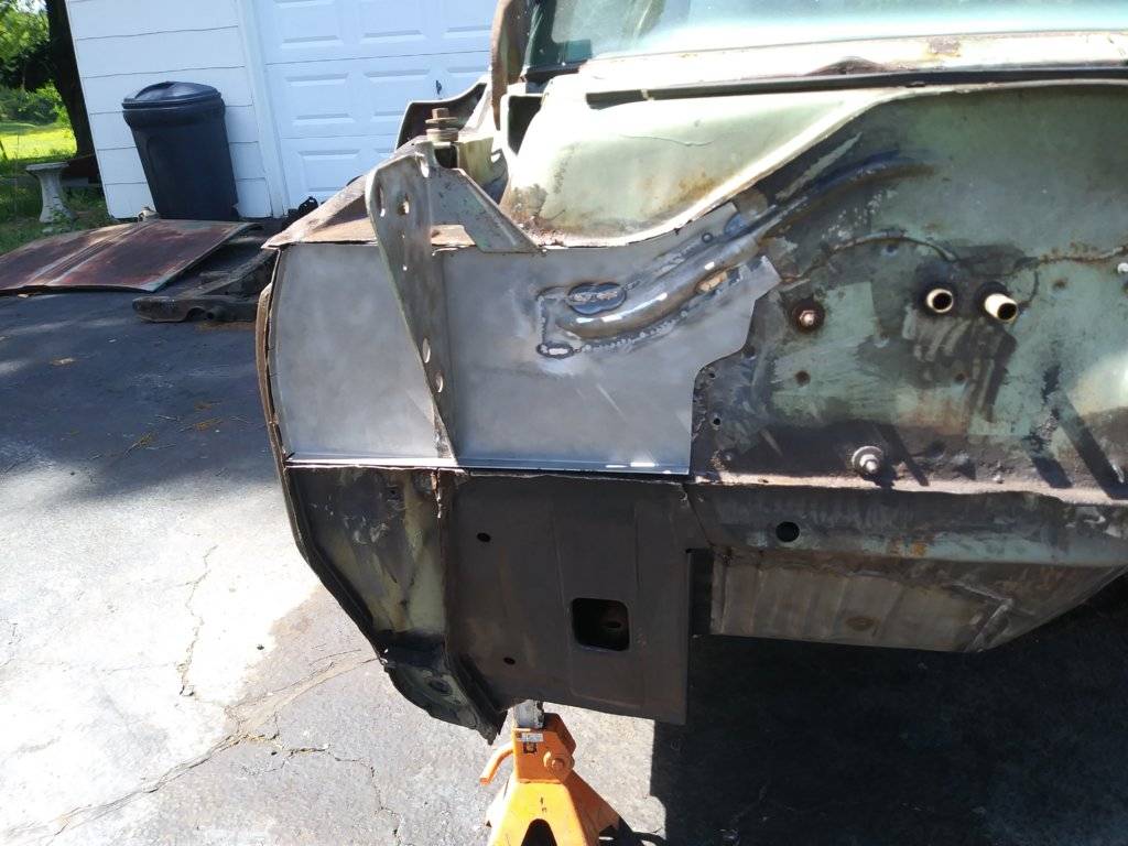

There were a few minor holes in the replacement pans that showed up during blasting but I was able to braze those shut. Should outlast me.
And the drivers side is in. Just have to clean up all the welds.

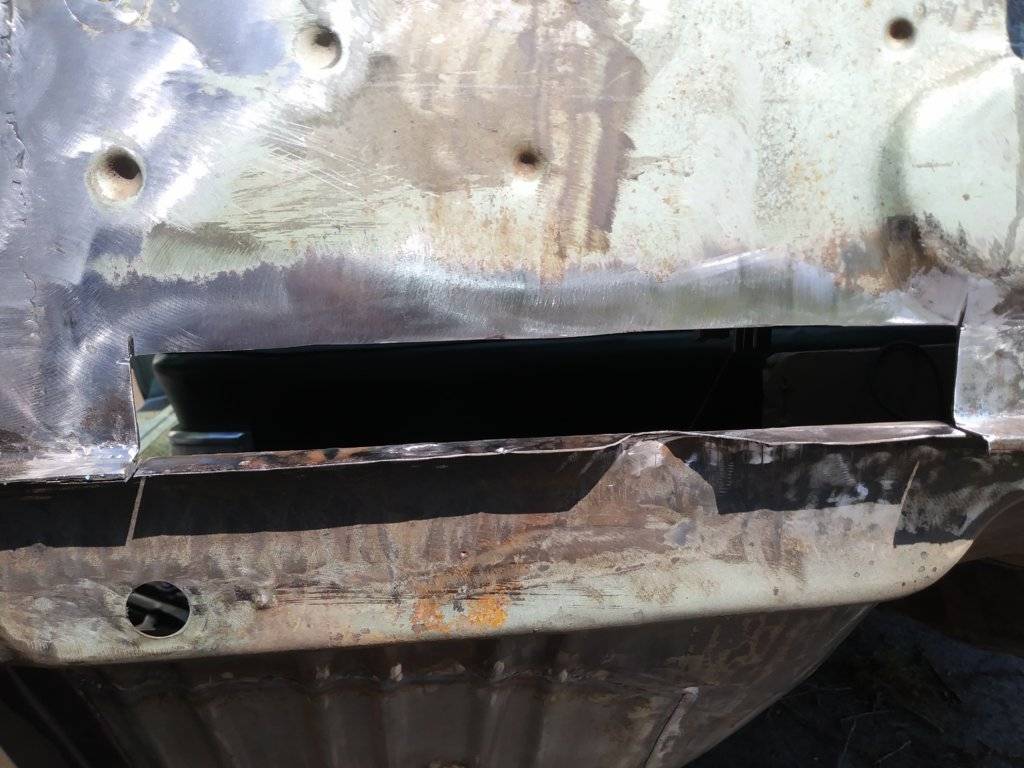

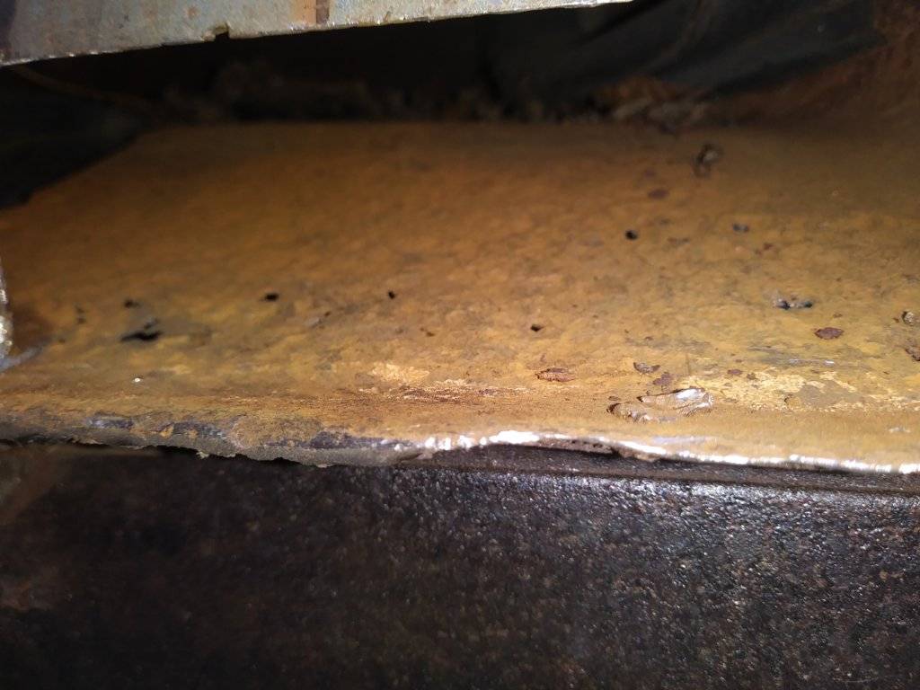

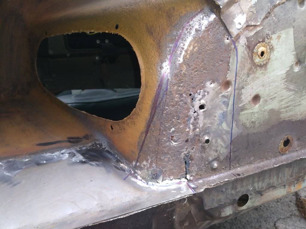

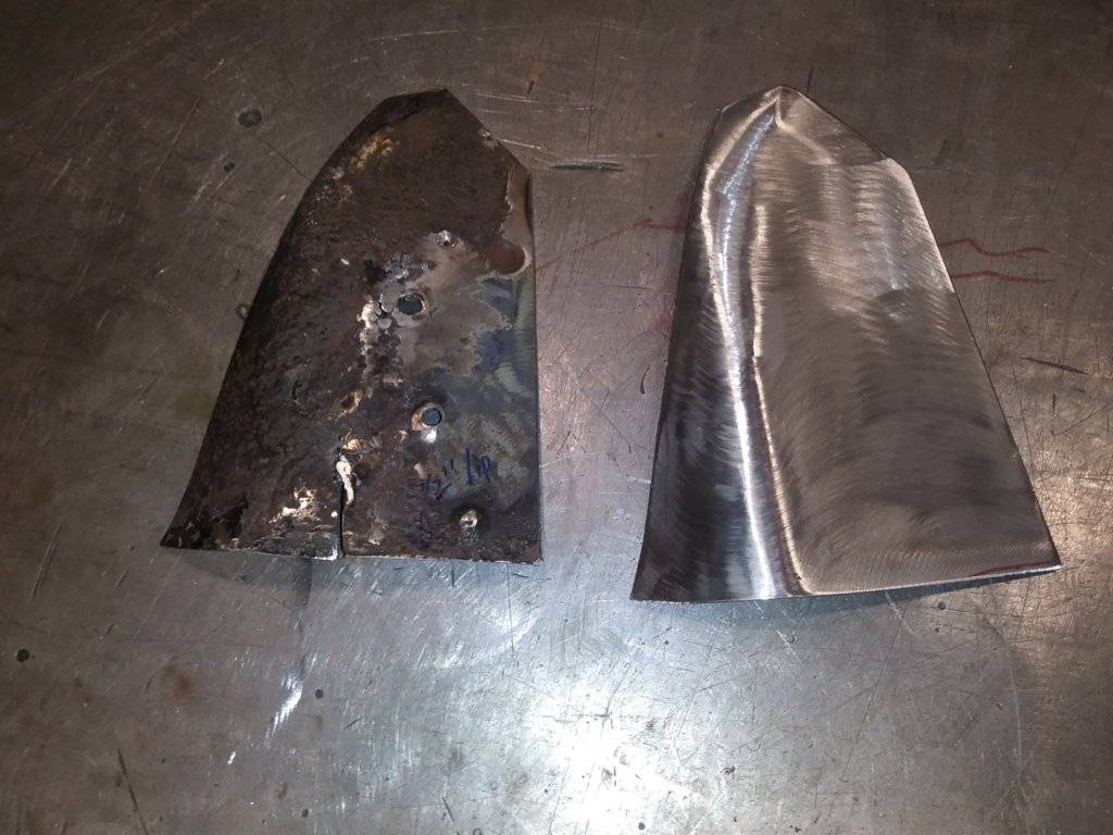

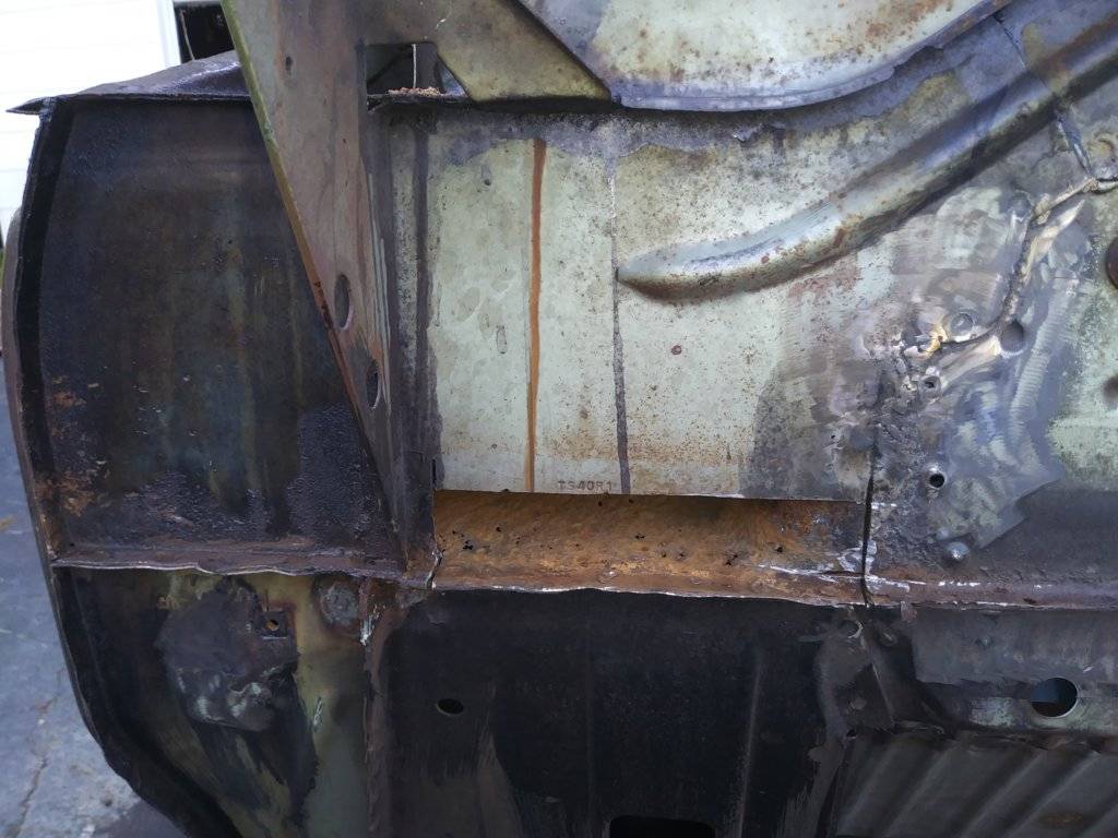

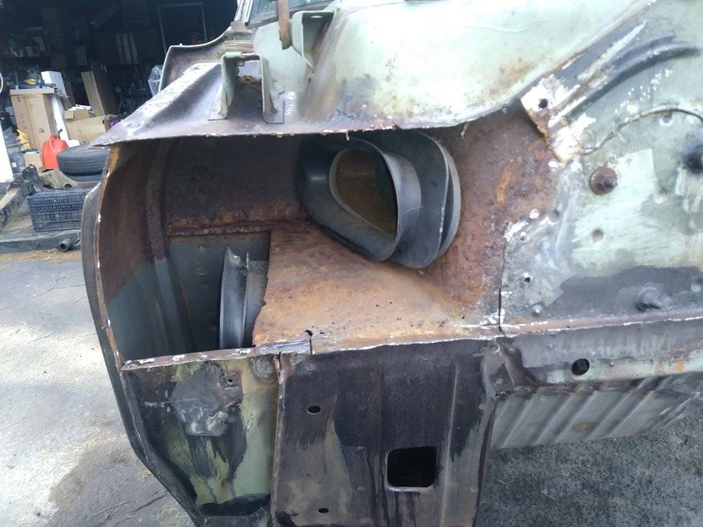

Yay.....look what I found when repair the firewall...going to have to remove that panel so I can repair the inside. I guess this is where my water came from that rotted the floor board.
Removed the panel...this I can fix...weld in a patch then spray it all with chassis saver...repair the external paneland weld it back in with new seam sealer.
