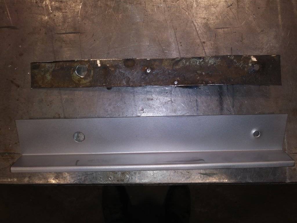

    Replacement panel is made.
    • Like Like x 4

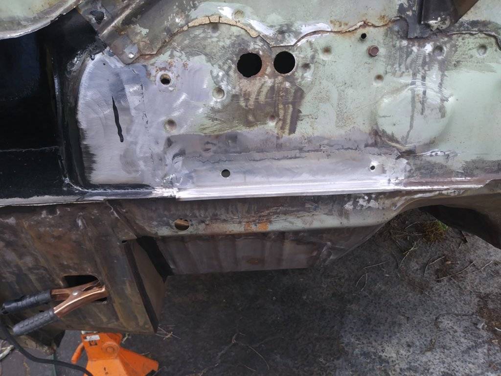

    Got the other panel in.
    • Like Like x 3

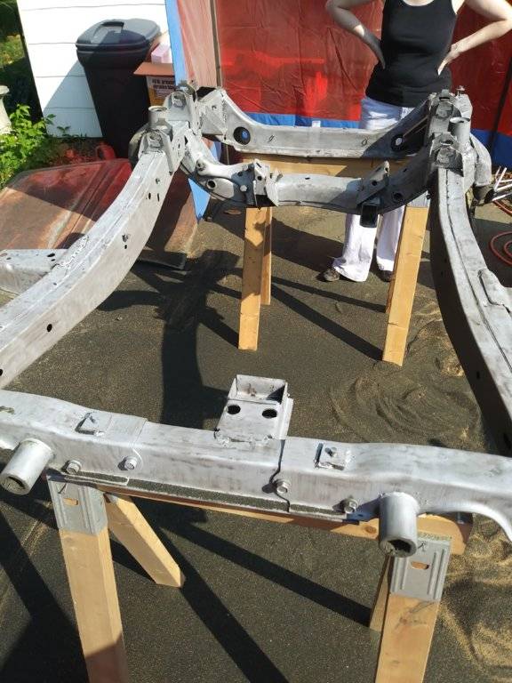

    Ok...so I bought a sandblaster and some walnut shells...have to say the walnut shells did a good job but Damn are they expensive for nonrecovery....$25/25lbs did 1/3 of my frame. Going to try coal slag @$7/50lbs...may not be good on sheet metal but fine on the frame.

    I have never used walnut shells, but have used sand and coal slag. The blasting sand works ok on rust, but the slag (ours is black beauty I believe) works great on rust. Ours is in the cabinet at work and sometimes you will get a chunk of the rust from previous blasting in the nozzle. It wont be a concern for you because your not recovering it like in a cabinet.

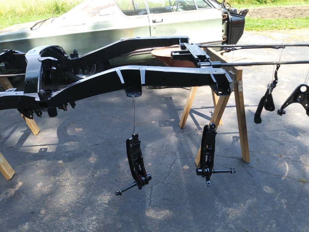

    Frame and bits are blasted cleaned and painted.
    • Like Like x 10

    There's no Love button so I could only click on Like.
    Beautiful!
    • Like Like x 2
    • Agree Agree x 2

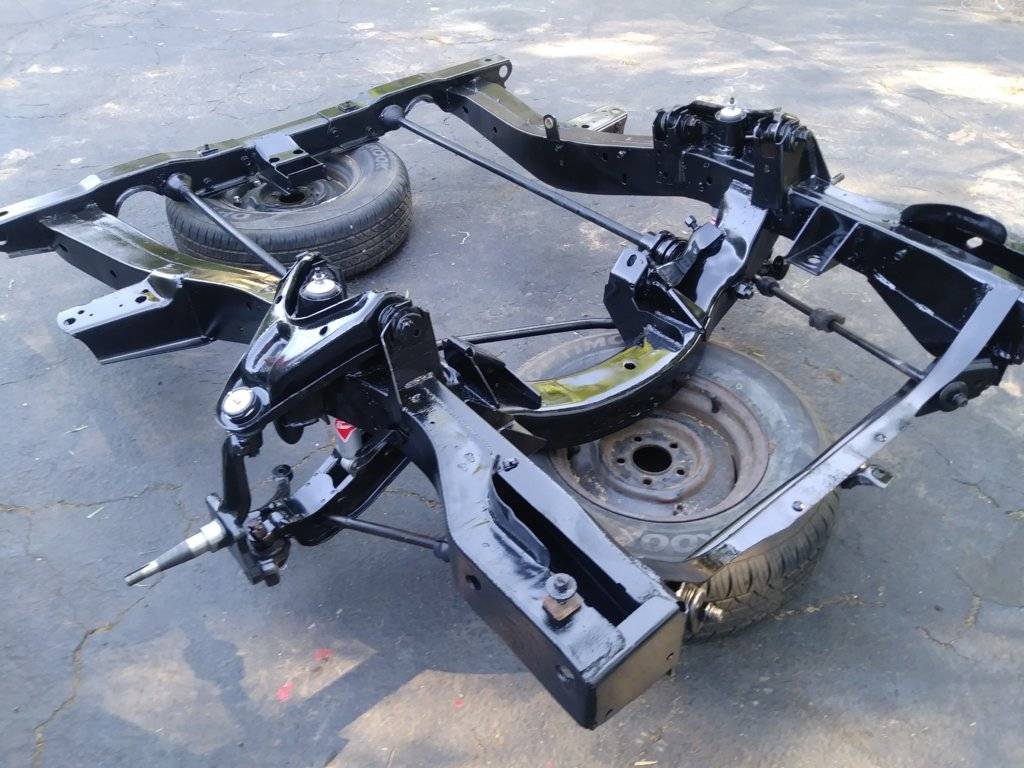

    Almost done with the stub frame. All new moog bushings, upper ball joints, kyb shocks and anything else I could replace. Still have to clean up the brake hubs and sway bar...install the tie rods and steering gear. Then I have to finish the transmission seals and paint so I can mount the motor and get the rest going. The front of the car is all patched up and just needs to be cleaned of the undercoat residue from stripping that so I can paint the underside with the chassis saver before painting the firewall purple....unless I go with black for the engine bay. Still undecided on that, but the car will be the same metallic purple as the motor.
    • Like Like x 5

    Almost done blasting the front of the car...engine bay area and underside...will paint that and install the frame...then work on the rest
    • Like Like x 2
