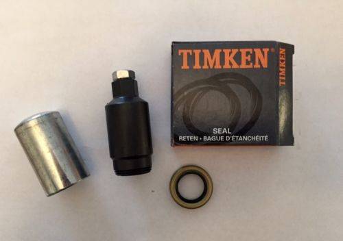

The leak on the shift selector is a very common one. This can be repaired with the transmission in the car and there is an inexpensive tool to remove the old seal. There are several posts by member MBar regarding this operation. Search posts: Trans seal by MBar.
Dave
Can his way do it without removing the valve body? That would be nice. I was doing it removing the valve body which is time consuming.
Yes, that is the whole point of the special tool, big time saver.
Dave
Here's what you need. Transmission shift shaft seal tool 46RE 46RH 47RH 47RE 48RE shifter mopar jeep | eBay Shop by category
