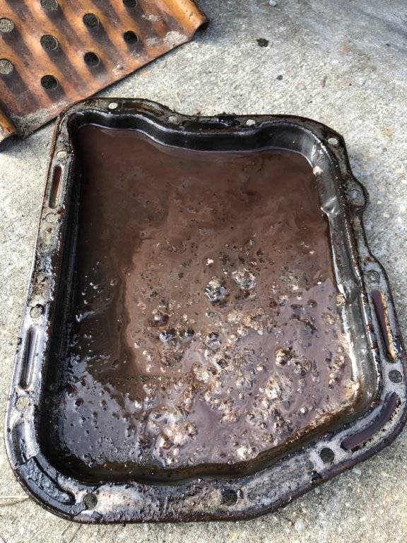

  20. kenfyoozed
    kenfyoozed Member FCBO Gold Member
    Messages:
    131
    Likes Received:
    35
    Joined:
    May 25, 2018
    Location:
    Mobile, AL
    decided to et the car up and pull the pan. This is the results. Not sure what all this is but I assume its not good. The filter seemed completely clogged with this as well. I am headed to the store to get a new filter and gasket just to try and see if this works.
    the gasket itself seems very thin, almost as if it was just some sort of RTV as there are places that looks as if it has squeezed out at the edges. Also the gasket is coming off in pieces and chunks. Not how I would have imagined the gaskets to have come off......
