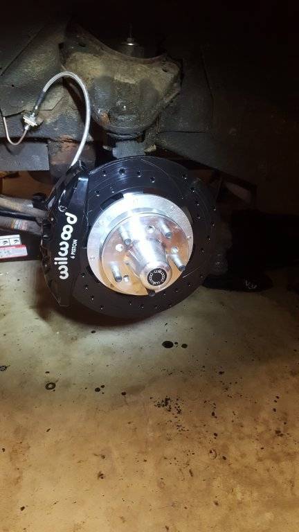

Thanks everyone. The Kit I bought was this http://www.summitracing.com/parts/wil-140-15198-d.
The Hp Manifolds match the HP motor!!

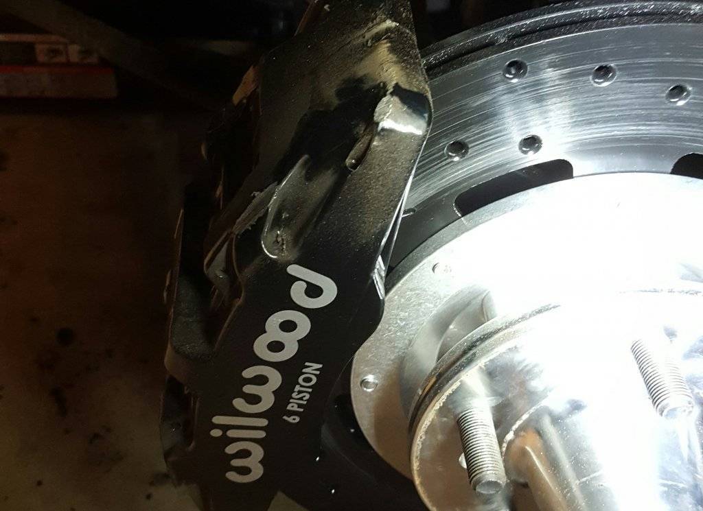

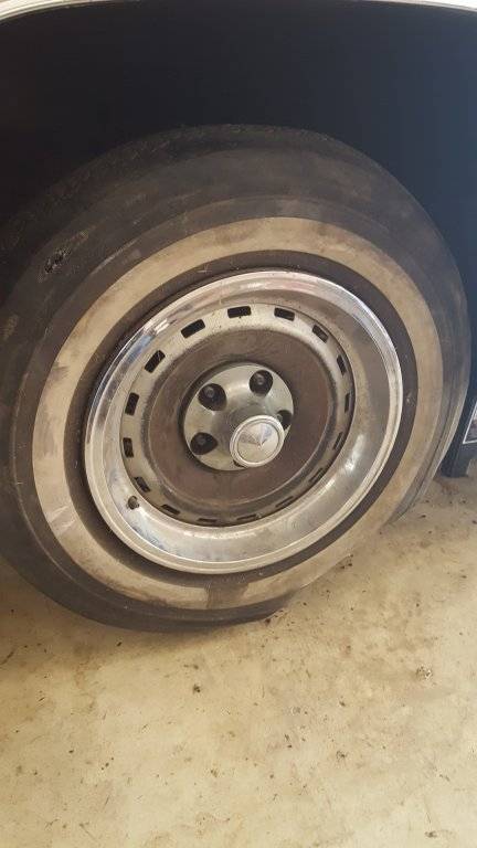

I finally got the brakes installed and man are these things massive. I found out the hard way that the 15s I have will not clear the caliper, ignore the tire on those wheels they were used for mock up only. So i had to buy bigger wheels to clear the wheels pictured did the damage to the caliper. So I have some touch up work to do. So my note to anyone looking to put this kit on is watch your wheels.
Got the new wheels and man does this thing stop. This is hands down the best thing going I have done, taking off the ssbc kit and putting the wilwoods on.

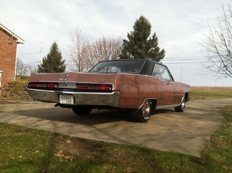

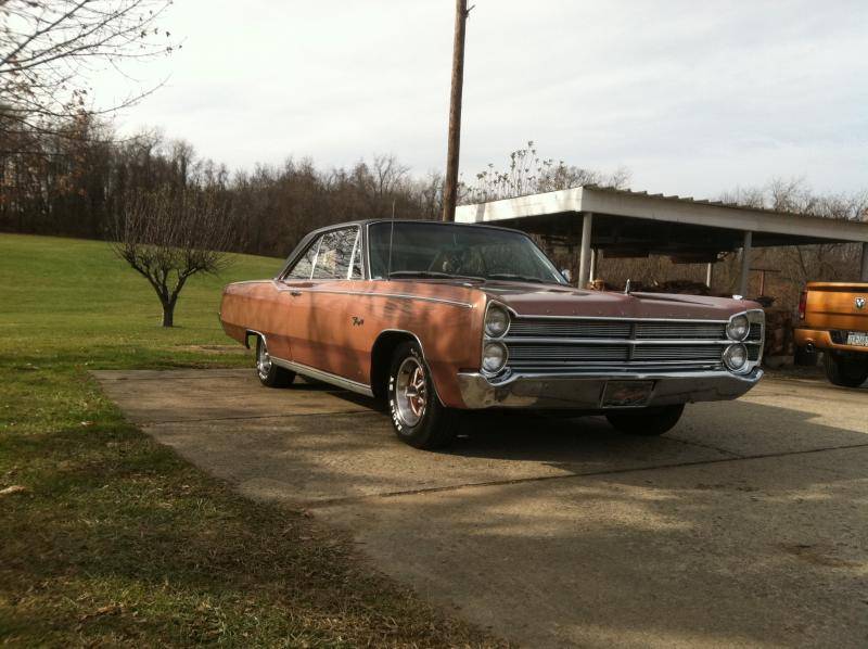

This is My Baby, My father just passed away unexpectedly and left me one of his prized possesions. It is a 1967 Plymouth Fury III. He bought it off a little old lady in 1990. (For reference I was 5). Since then I have been a Die Hard Mopar Guy. It was a factory 318 with 2.76 gears. Then in 1991 I remember helping drop in the mildly built 440, 727 trans with shift kit, and 4.10 suregrip. This car means alot to me. He let me use it on my Wedding Day instead of a limo. ( my wife is very understanding) But I will post more after work. But It is still sporting its factory 67 paint and interior!
