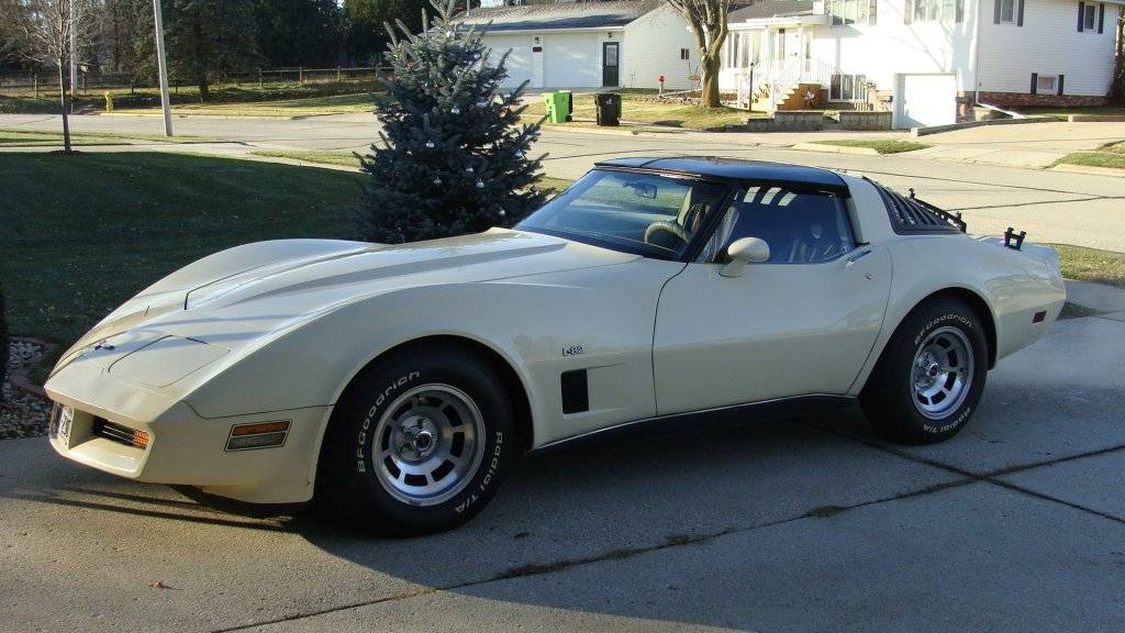

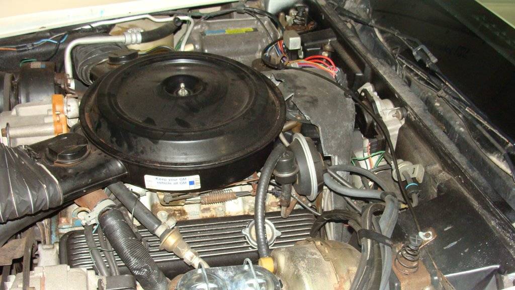

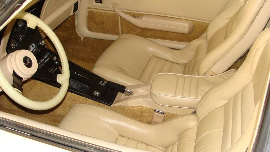

Here's my orphan, Bought it from original owner 49K miles L-82, last of the carburetor cars, every options except trailer tow
