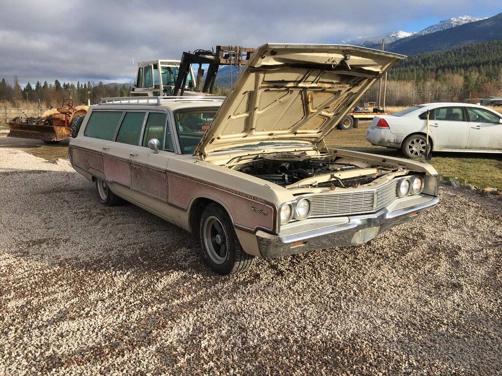

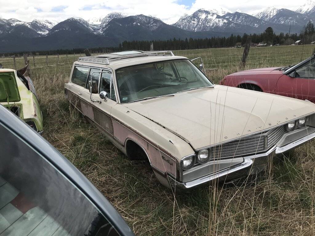

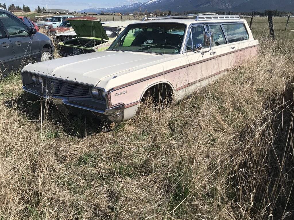

Here is my wagon. I never actually intended to buy it. Just saw it and had to have it. Best part is it was surrounded by Cudas, Challenger RTs, Roadrunners, Superbees, and GTXs and it is what caught my eye. I see those popular cars so often ( this guy has a ton of them) that I hardly notice them anymore.

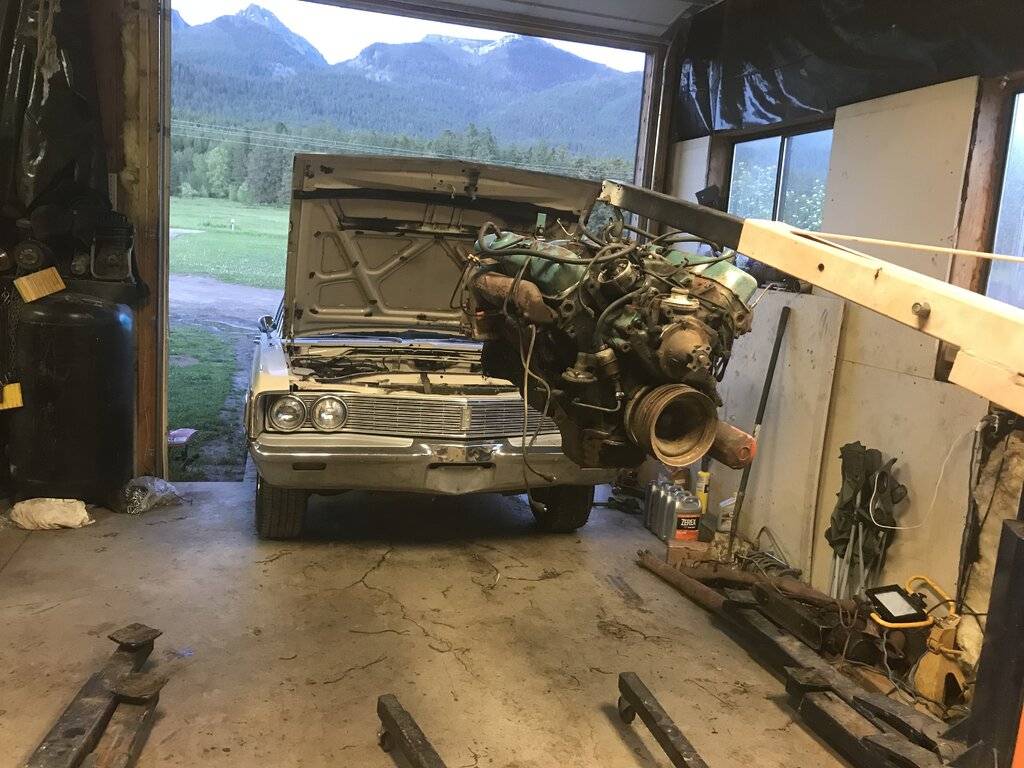

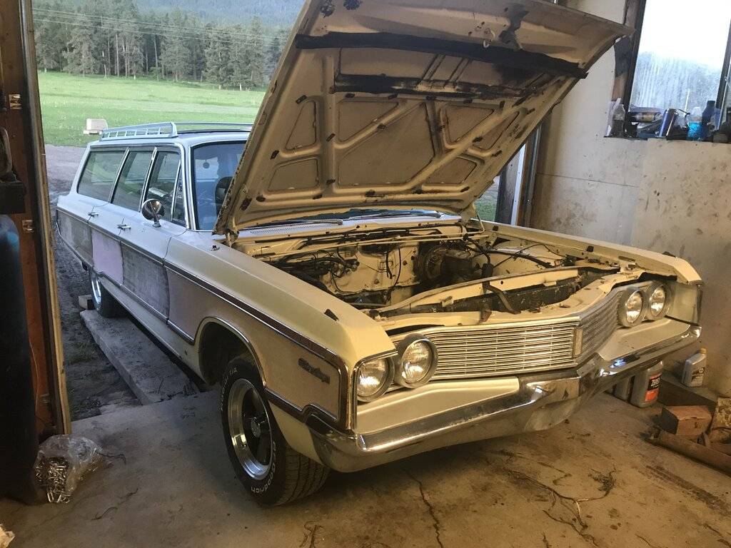

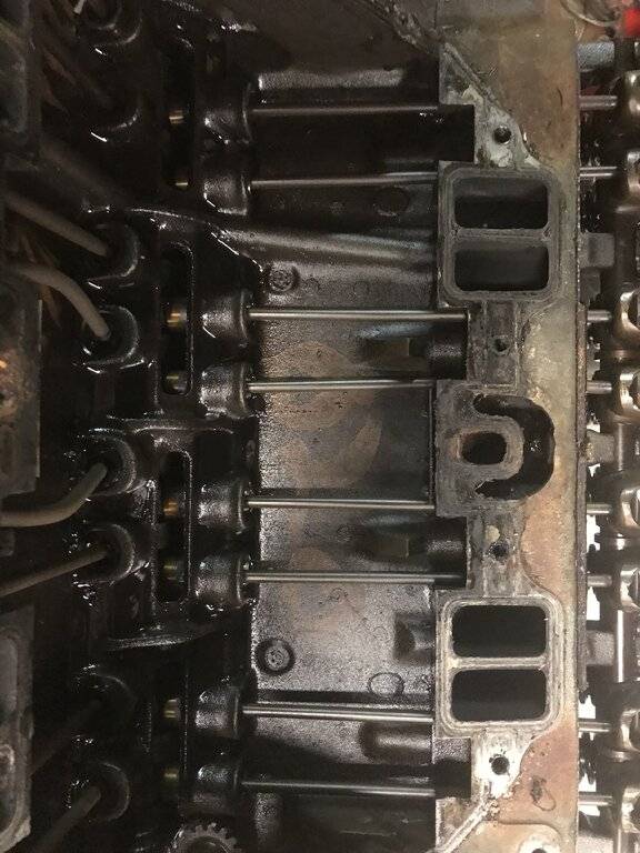

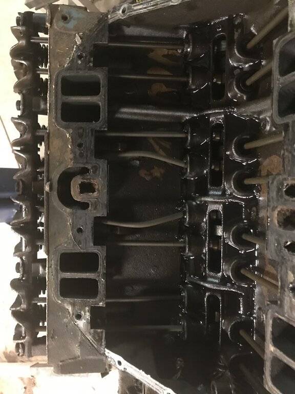

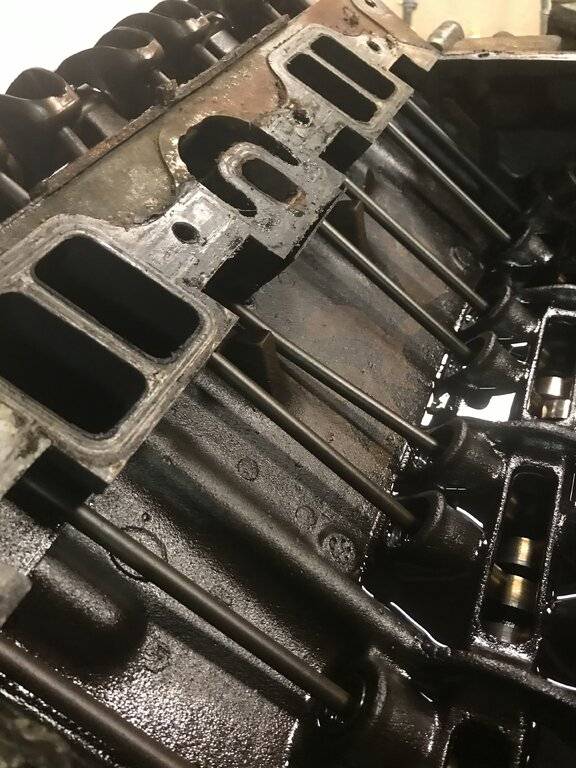

The car was complete and fairly original when I got it. Apparently it towed a horse trailer for the last part of its previous life. Ended up in the wrecking yard with a bad trans. I decided to just completely go through the drivetrain and add EFI. I want something I can just hop in and drive anywhere I want when it’s done.

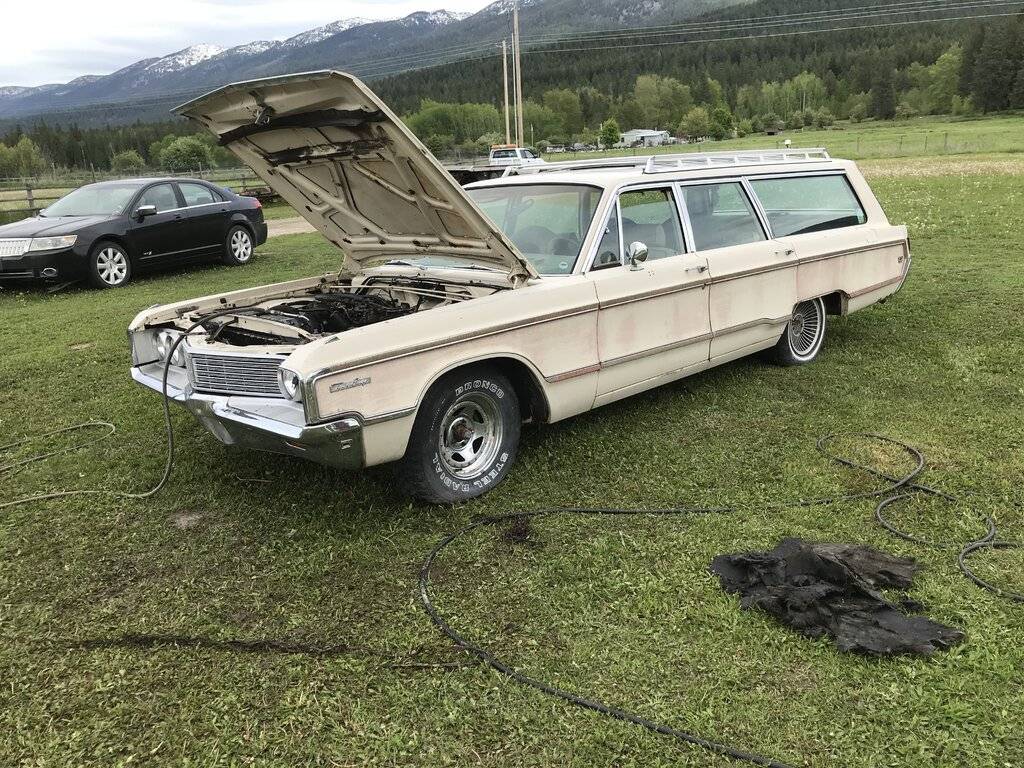

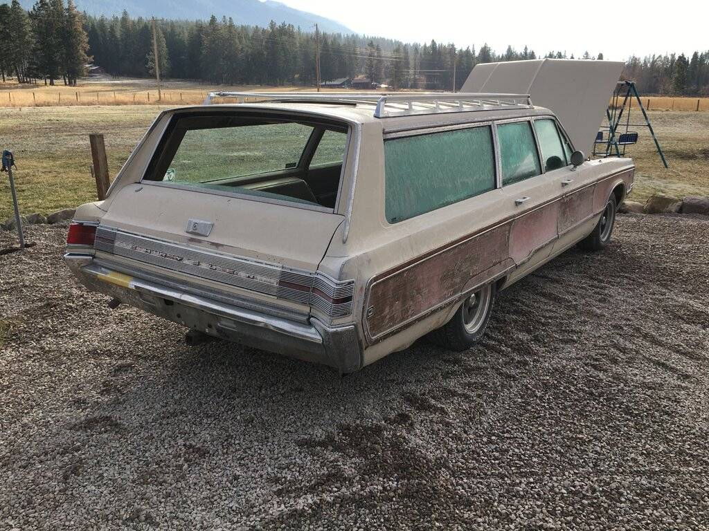

Here are some pics of where I found it and where it is today. Not a lot of difference but progress is progress. Only have had it for about 3 months now.
Nice clean straight T&C Wagon! One thing you can count on in Montana,virtually no rust! I'm just getting my 66' 300 back on the road, it came from Park City, Mt. I reside in B.C. Canada, but most of my Chryslers came from Wash. or Montana. I'm also on the hunt for a 60' New Yorker, if you know of one, I would love to hear from you. Cheers, John.

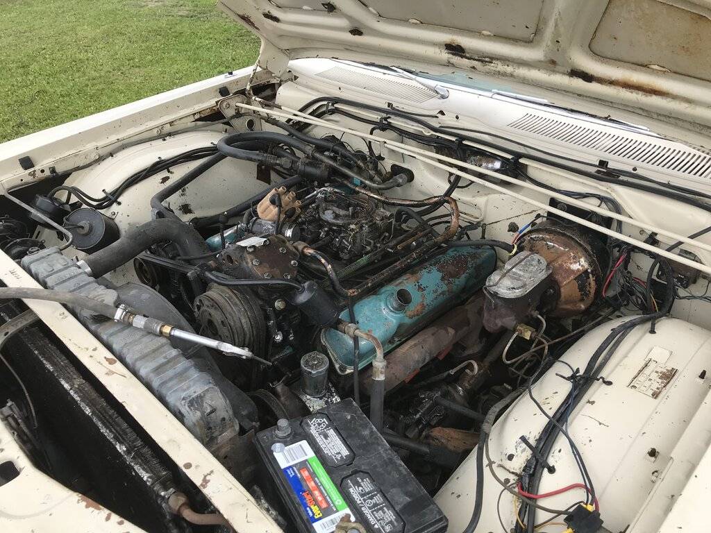

Here are some update pictures of the car. I finally got to drive it. I absolutely love the fuel injection! The only issue I have is I need to find a wire that keeps 12 volts while cranking. I thought I had one but it drops out while cranking.
Now I just gotta get the cosmetics sorted out and start driving it next spring!

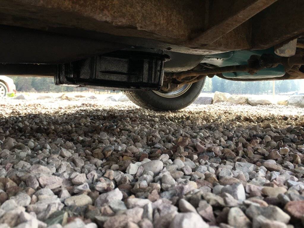

I think my tranny pan is the lowest point under the car. Lol
