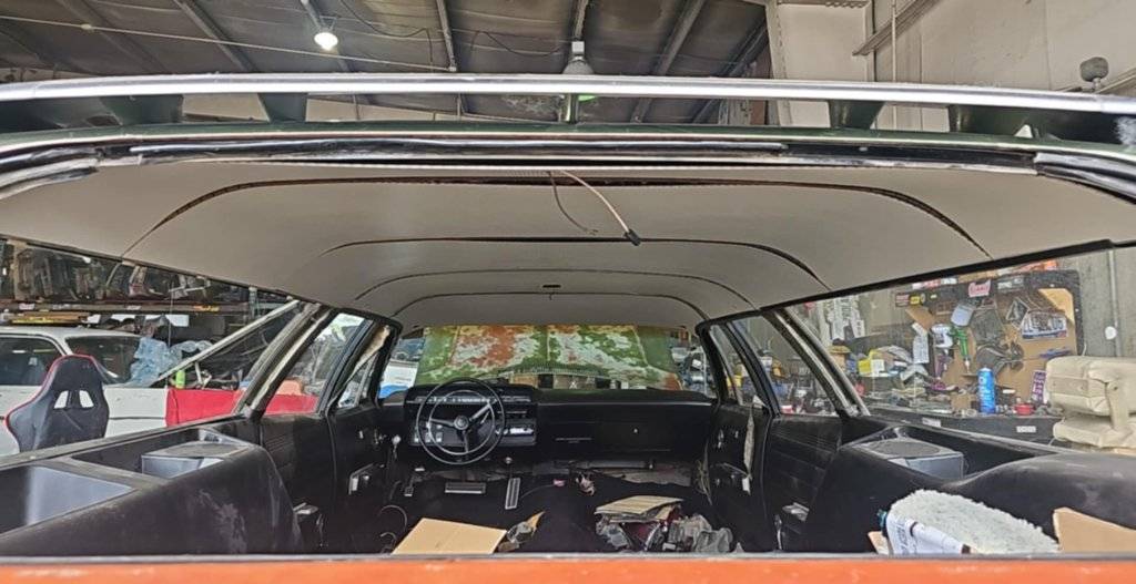

I’ve been working on reproducing my panels here in Australia using 3mil flexi ply. An absolute pain in the but. For me to purchase and have them shipped out was over $2000. I have glued the white perforated vinyl to the boards. Does anyone sell the chrome plastic that covers the metal strips as mine are very brittle.

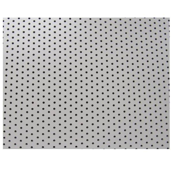

I contacted REM
They do produce the panels
They distribute through Dante’s Mopar parts.
I could not find on their website
Here’s a sample pic of product.
