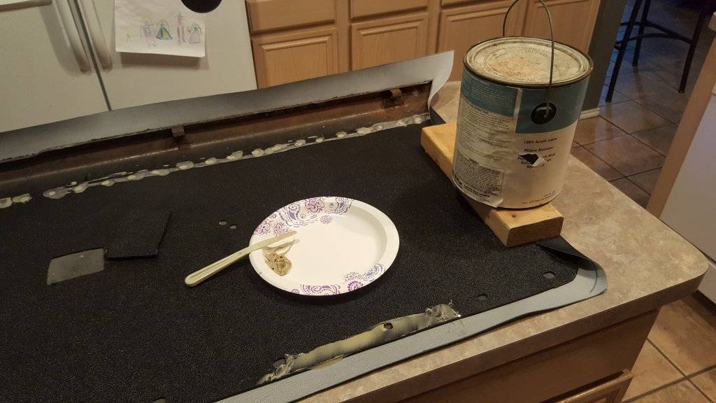

here is a shot of using PL Premium to attach the vinyl to the backside of the panel. there may be better stuff than PL premium for this. it did not want to stay without help. the PL comes in a grease gun tube, so i shot some onto a paper plate and used a plastic knife to spread it.
today ill be able to see if this is gonna work or not.
oh - a pro tip - the wife says stick the middles first, so left side middle, right side middle, bottom middle. then half that distance and do it again. hope that makes sense...
try not to glue yourself to the door panel -

test fitting

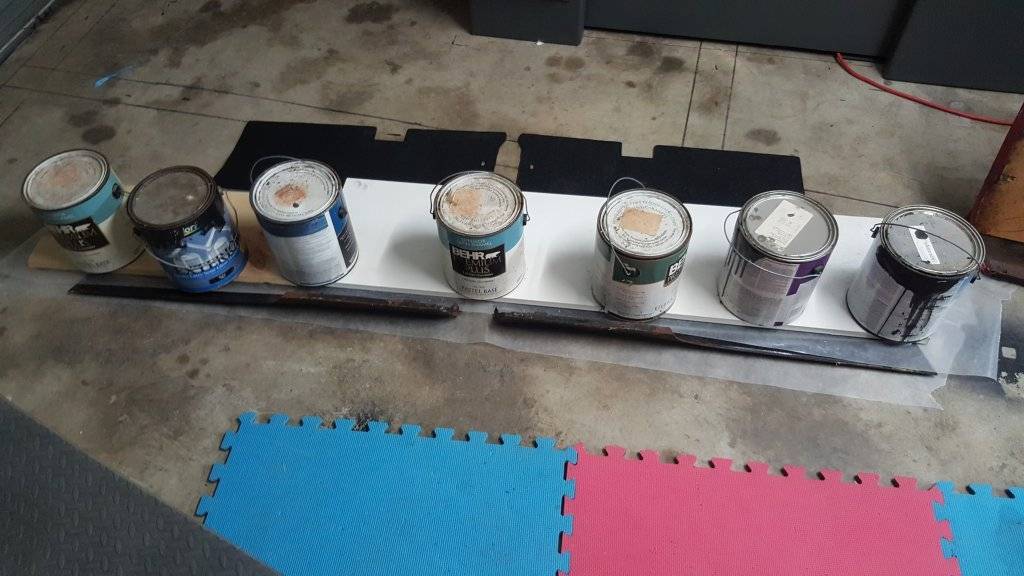

and blam! Loctite PL premium applied under pressurized conditions :)
there is wax paper on the floor, then the product, then wax paper, then board, then paint cans. I don't have pictures of the gluing process.. I'm a one man show and the **** was curing fast....

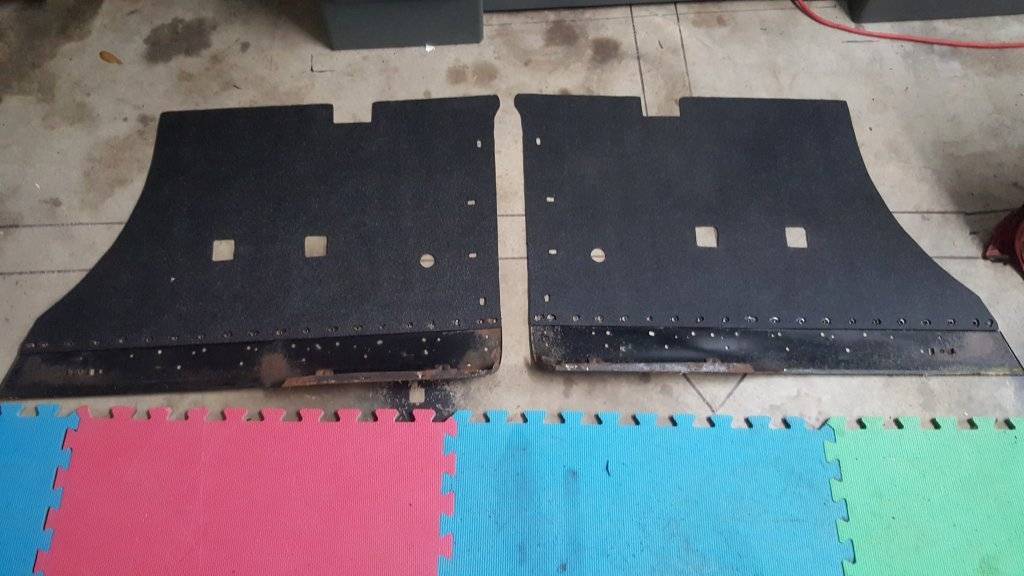

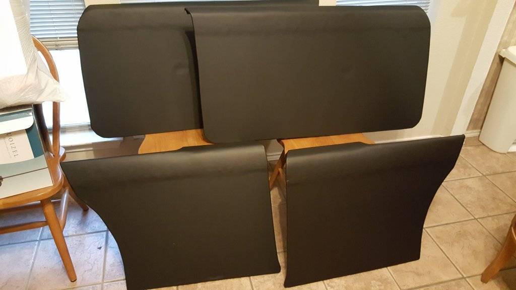

wellp, here we are so far. door panels:
it really sucks you can see the join line from the ABS panel to the metal frame. I blame the foam I used. I think if I had chosen a different foam, I would have been 100%.
so, I'm pretty happy overall, but I feel like I got almost perfect results only to get kicked in the balls by material choosing. to redo it at this point is crazy. I'm going to try to figure out how to hide the join line imperfections. I'm about probably just under $300 into materials. and a whole bunch of hours. if you have the free time its worth it, but if your time is money you should pay someone else to do this.

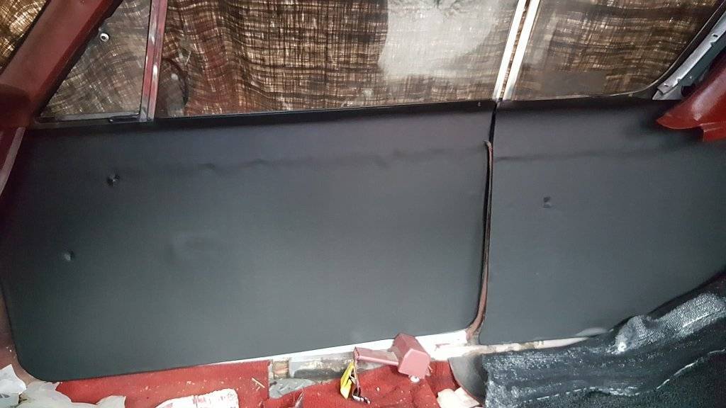

I JUST finished gluing them up a few minutes ago - they will sit and cure and whatever a few more days, then I will have time to hang them in the car and see where I'm at with them. if they sit well, ill put the Velcro on and line up the cuts for the window crank and door handle, etc.
yes for sure. looking at the driver door panel its gonna get more complex around where the remote mirror adjusto sticks thru. im gonna hold here until i can fit them into the car and knock out the holes for the window cranks and door pull and armrest.

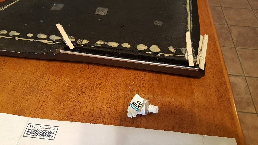

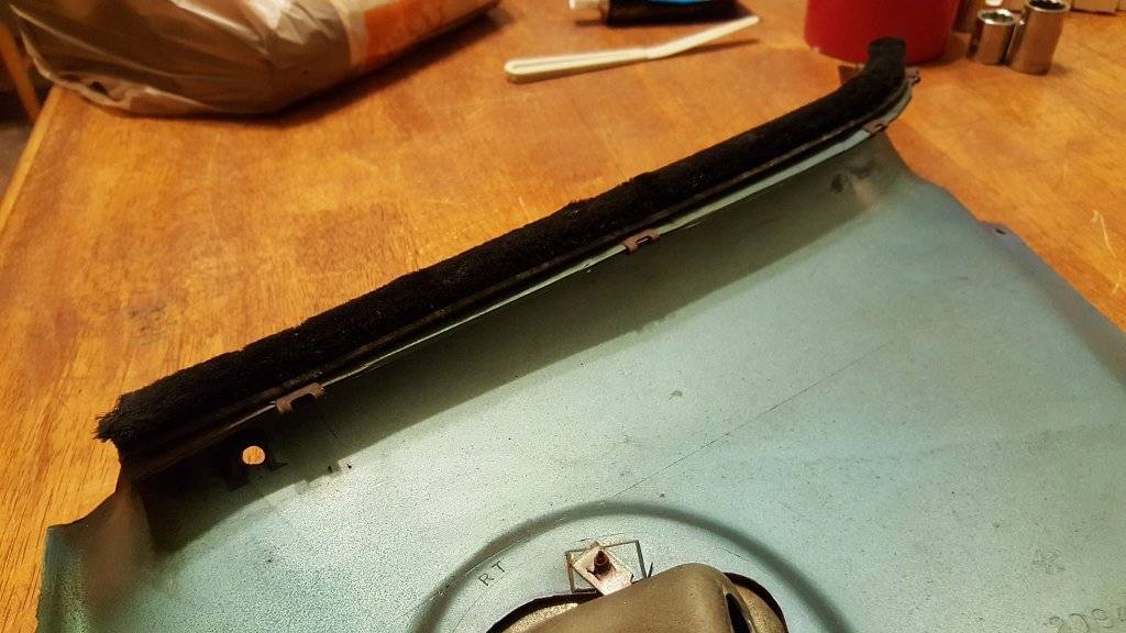

damn i forgot a pic about the door panels. there is window peach fuzz on both front and rear panel. i just happened to have a top cat whisker kit layin around so i applied accordingly. the original is stapled in/on, and top cat sent a bag of staples. but i have no idea how to drive them in thru the whiskers, thru the backing, thru a layer of vinyl, thru the metal, and then make them bend all nice. so i used silicone adhesive, as im a man of the times.

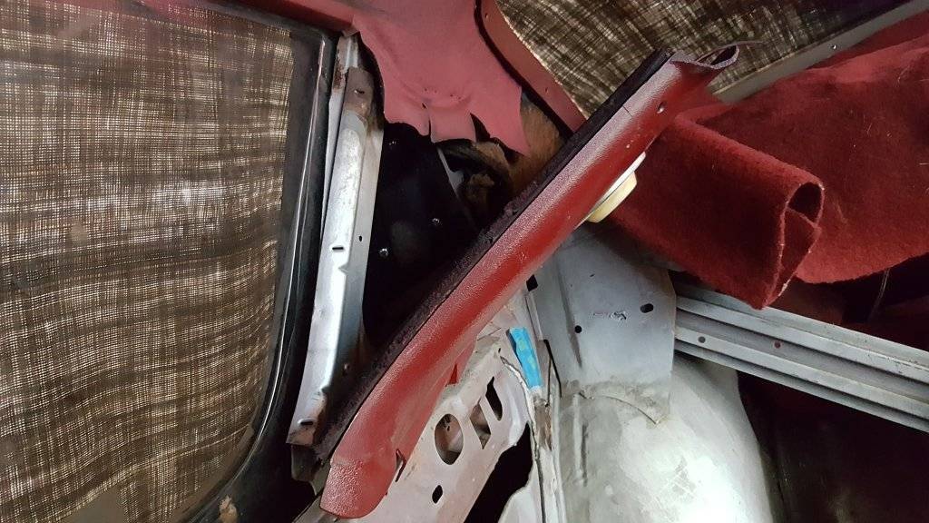

so why stop there right - next on the agenda is these fragile *** dried out gnarly lookin crusty rear quarter panel panels. they are so dry if you grab them too hard they crack. flexing them at all when removing just made them worse.
and they are red (boo) and they have more peach fuzz on them. sigh.
so those red panels.. thay aint red all over :/
these be some recycled panels that got painted red at some point. so between the gone roof and these panels being changed, my car has had a rough life it seems.. its stock codes calls for red interior, but this is not the first one. maybe they were all blue and then painted to color? does not seem smart, but what do i know.
so anyways - pic of the whiskers cliped on to the edge of the panel. very fragile here. i had to carefully pry the clip with a very small flat blade and work these loose off of the edge. next issue is the replacement top cat whiskers are not in a metal clipy bindy thing, somehow this has to come out and the new whiskers got to get in the holder...

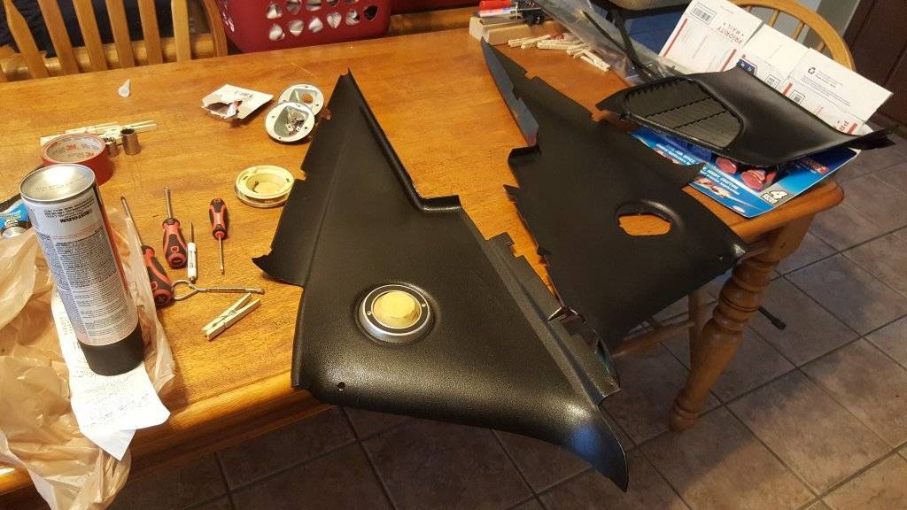

so these fragile panels. i could not figure out how i was going to make them stronger, and i sweated it for weeks. i thought about fiberglass, dipping, por15, spray foam, all kind of crap about how to hold this piece together and give it some strength from breaking further.

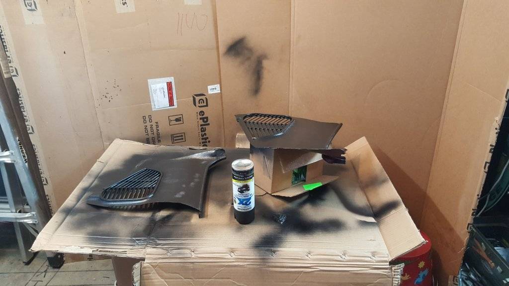

then i was like fk it, im gonna use bedliner again i know that shite is the 3rd strongest thing on my car. so for this i got some spray can bed liner and not roll on goop. i was most worried about melting the plastic. i could not find anything that said DONT do it... so . . .
not too bad for a white boy in a cardboard paint booth

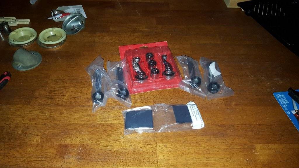

fresh from DCS dales cuda shop !
4 spankin new window crank handles, and a set of new door release handles.
yes, they have no vent window crank handles. i could not find any proper ones at any vendor. so i had to go overseas for those . .
