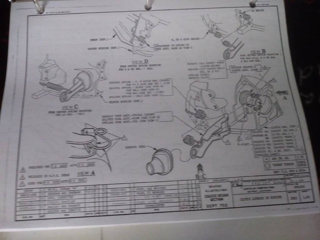

There is no real "assembly" guide.
Next best thing is the factory blueprints.
Still no text,but a pictoral of parts and part numbers.
Yet very helpful..especially if you took everything apart years ago and trying to figure out HTF to put it back together..
