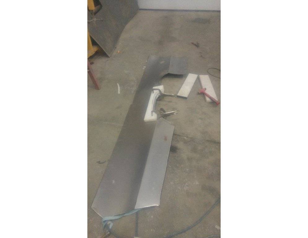

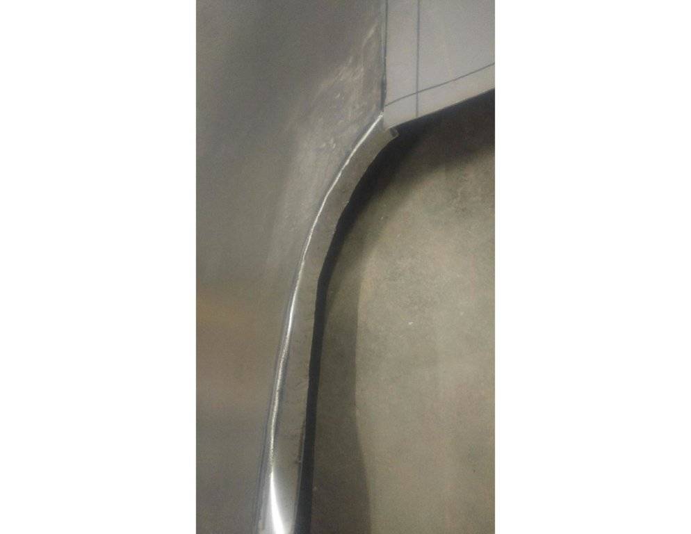

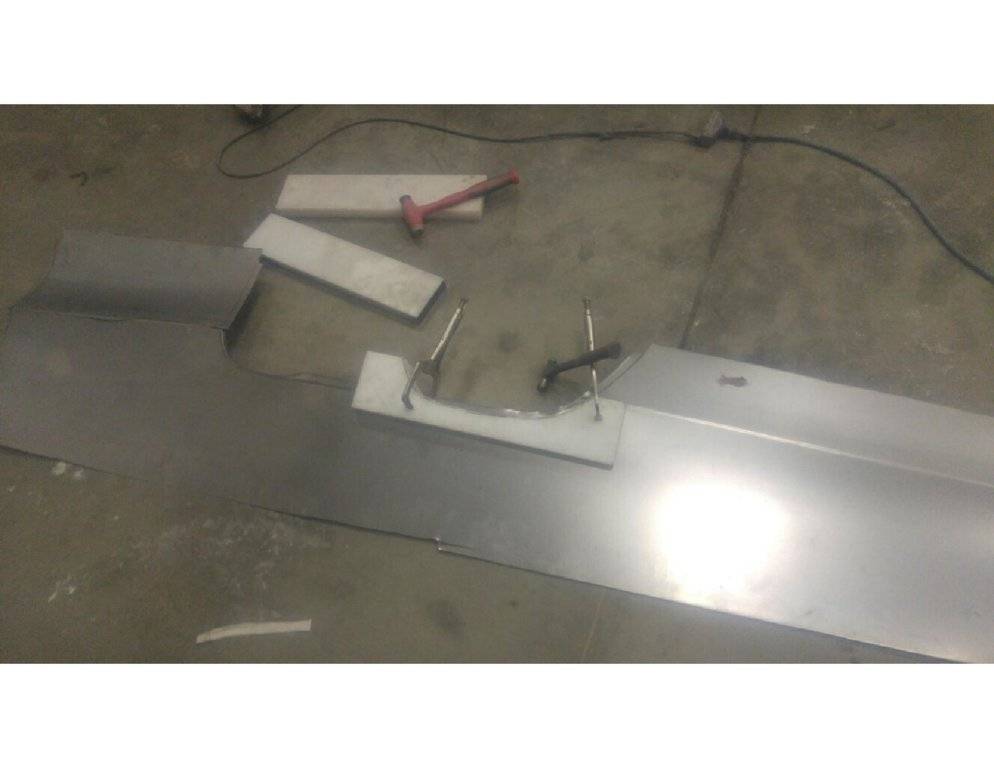

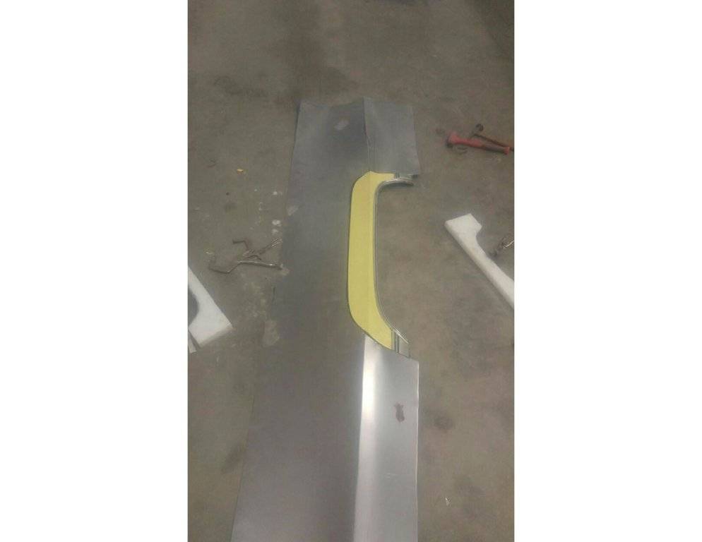

Shaping of one side, hope fully tomorrow the second side will be started. enjoy
