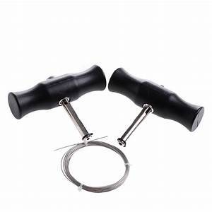

You'll also need to "cut the glass out" from where it is now. This can be laborious, using a thin length of piano wire to do it. THEN you'll need to clean the old adhesive from the glass and car body. More laborious work. When that's done, I believe there's a primer liquid to coat the body with, before the sealer is applied.

you'l want to invest in a windshield removal kit.
one person inside and one outside. you poke a hole through the sealer, thread the wire through and saw your way around the windshield. there are plenty of videos online showing the process.take note of how the sealer looks through the glass. check the distance from the edge as well as the smoothness and uniformity of the sealer.
be careful not to nick the edges of the glass, especially around the corners or it will crack. be careful of your trim and dash inside.when it's ready to come out, start at the inside top and push it out to the outside person. there will be some resistance, but if you think it's too much, stop and figure out where you are stuck.
scrape out the sealer and clean off the remainder. ( i can't remember what i used but i think it was paint or lacquer thinner). lay your ribbon in the same place as the old, pressing the gap together at the bottom. lay in your blocks, set the bottom of the glass and tip it down to the inside person. press it flat until the are no gaps or bubbles in the sealer as viewed through the windshield , like you saw before removal. there is no real set up time for the ribbon , it will stay flexible for years. remove the blocks , reinstall trim and mirror wipers etc.
