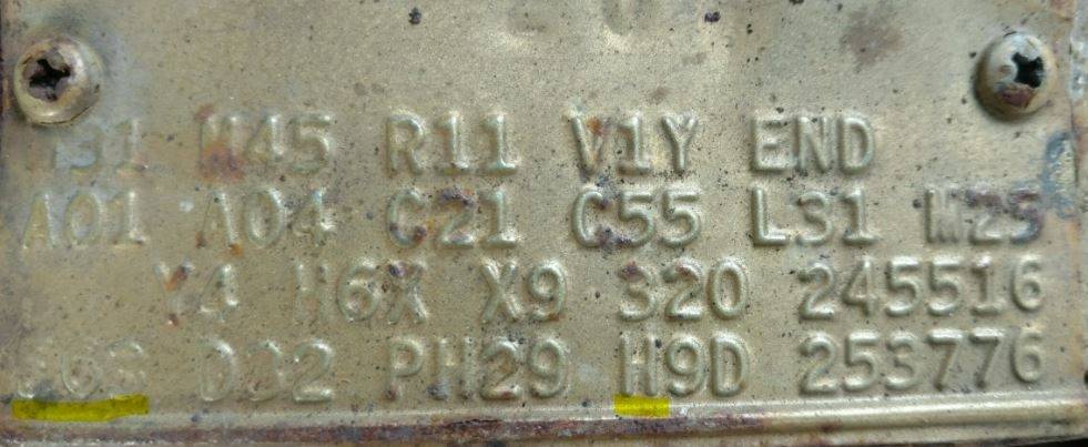

This topic peaked my interest because I purchased a bunch of parts from a 69 Sport Fury that was equipped with an E63 H code 383 and it had the unsilenced air cleaner and other marketing HP cosmetics.

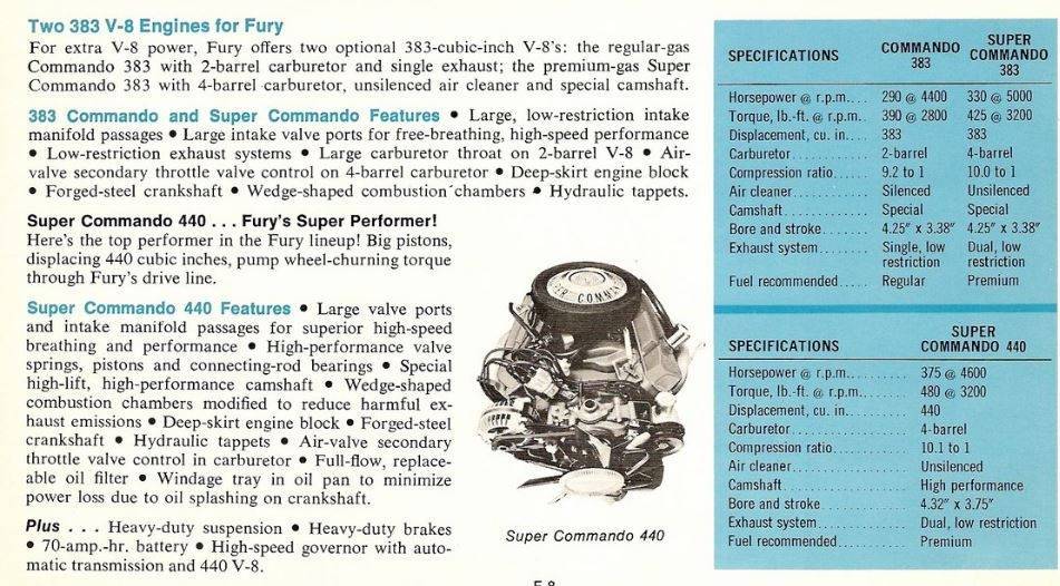

For Fury, they list the 4 BBL 383 as Super Commando with unsilenced air cleaner and special cam but still only 330 HP.
So I'm concluding that if you bought a Charger, Dart, Sport Fury, Barracuda or the like they put the unsilenced or dual snorkel air cleaner and other cosmetics on it to look more high performance?

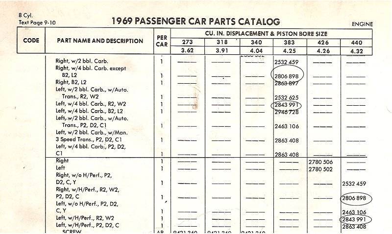

Prior to 68 and in 71, the term HP was used to distinguish the 383-4bbl from the 383-2bbl. Maybe that's where the term HP manifolds comes from. I don't know.
From 68-70, there was an additional 383-4 rated at 335 horse. The actual application, or what the 335 assembly was used for varies each year. For example, in 68 and 69, you could not get the 335 horse assembly with A/C. In 70 you could. In 68, the 335 horse was only available in the Road Runner and Super Bee with either transmission. (There was a variation for the A body rated lower due to restrictive exhaust manifolds.) In 69 ANY B body (Charger, Coronet 500, Sport Satellite, etc) with a four speed got the 335 horse. 1970 has it's own applications also.

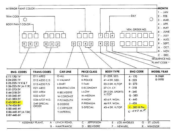

From 68-70, all 383-4bbls have the H code in the VIN. In 68 the engine code is 62 and for 69 and 70 it's E63. These just tell you WHAT the car has; a 383-4bbl. It does not tell you WHICH assembly or HP rating comes with that assembly. (Yes, it's common to see the H code listed as HP. It's incorrect but making a sweeping claim is MUCH easier than trying to explain all of the various applications and nuances for the 68-70 383-4bbl)
Below is a picture showing the various '68 383-4bbl assemblies. All of these will code H in the VIN and all will code 62 on the fender tag but each is a unique assembly designed for a particular application. There are different HP ratings for the assemblies depending on application. The same concepts hold true for 69 and 70. (I'm just too lazy to put together the equivalent picture)
So don't look at the WHAT (H VIN or engine code on the fender tag) look at the WHICH or the assembly based on application. The actual assembly is listed on the broadcast sheet or the fender tag of a car built at the Lynch Road plant for model year 69 and later.
I don't think I've ever come across any factory documentation for a C body 335 horse assembly.
No 335 horse assembly with A/C in 68 or 69.
No 335 horse assembly in anything but a Super Bee or Road Runner in '68.
'69 B bodies with a four speed without A/C got the 335 horse. (so no 69 Chargers with automatics got the 335 horse. If you got the four speed, you got the 335 horse version.)
I need to brush up on my 70 applications.....

The 383-2, 383-4 330 horse and 440-4 350 horse use the same cam.
