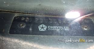

The VIN is located on the drivers side radiator support, and on the drivers side dashboard pad upper left corner visible thru the windshield
Cowl, driver side under the hood seal, may need a wire brush.
Trunk rail near the hinge (maybe 6" back) under the weatherstrip.
