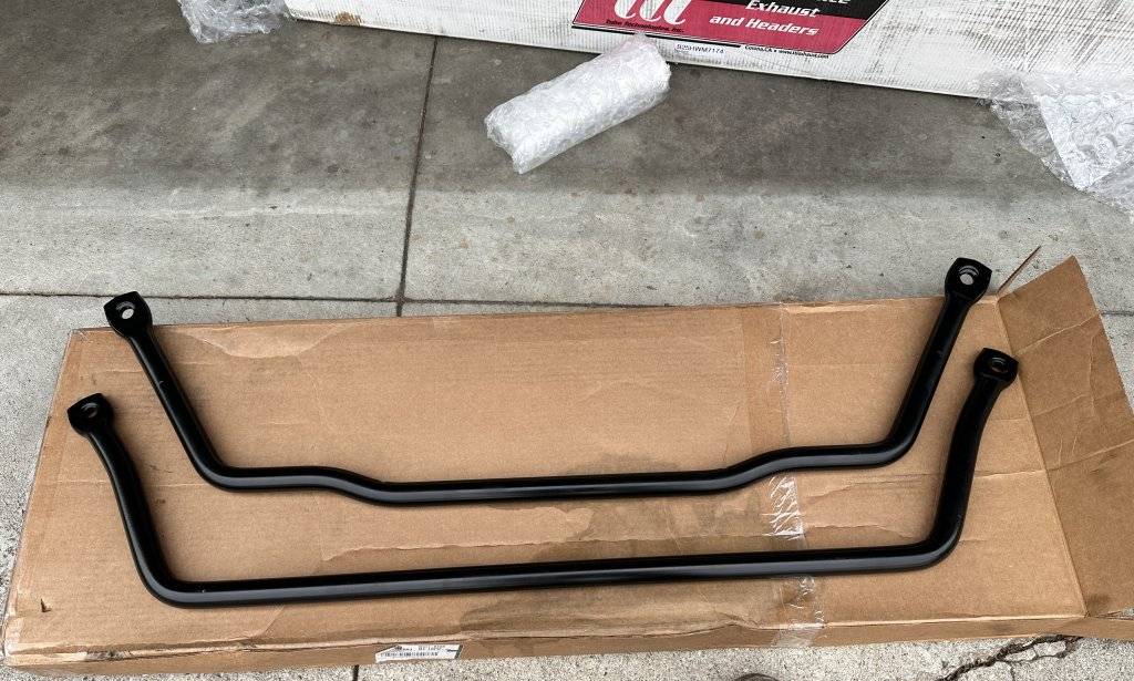

I add the lower control arm reinforcement plates when I add a larger front anti sway bar. 1.25"

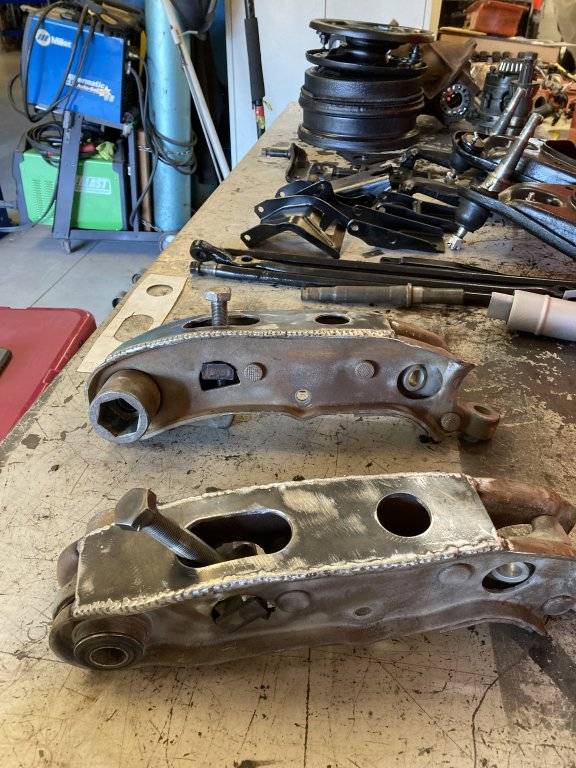

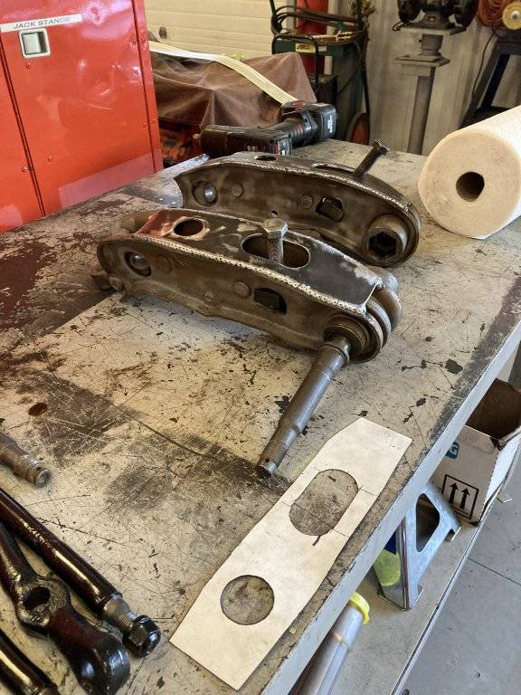

I did the firm feel weld on reinforcement plates from firm feel but went with rubber bushings all around instead for shock absorption reasons. Cant say what difference it made in feeling on the road since my lower ball joints, tie rods, and bushings were shot prior to the full front end suspension/steering rebuild. I will say just make sure you have them aligned properly on the LCA's prior to welding for the torsion bar adjustment bolt to pivot when tightening the torsion bolts. I had to pull mine back out and grind a little off the oval hole for the torsion bar adjustment bolt after starting to tighten the suspension back up.
I believe they are a good upgrade to stock lower arms. You can even tighten the pivot up in the arm by cutting one side of bump stop loose and squeezing the sides tighter on pivot. It's kinda like boxing the rear arms on a GM A body. I'm sure they were adequate in 1960 whatever but tires, shocks, roads, speeds are all different now so it's a worthwhile installation.
The shop that restored my 300 used a paper template to make reinforcement plates. My driver's side LCA was loose and wobbly (sorry for getting technical) after 250,000 miles.
