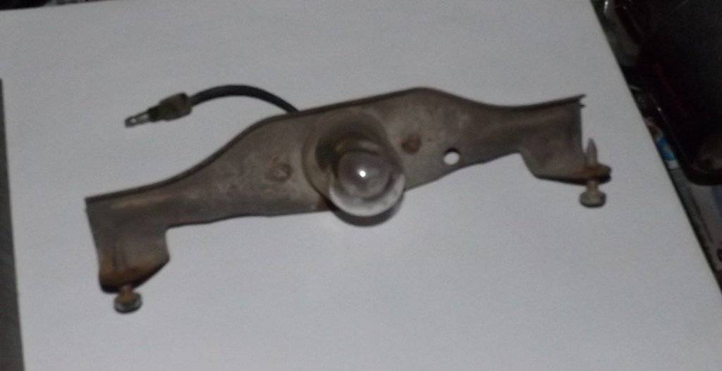

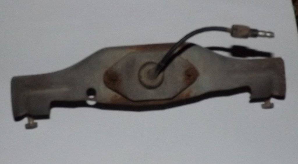

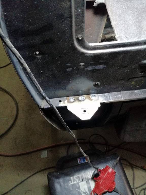

Here are a couple of pics of the bracket, the mount holes are 7.25in apart. Let me know if it will work,.

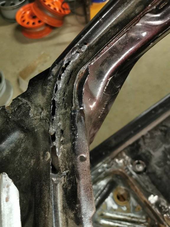

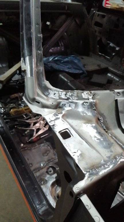

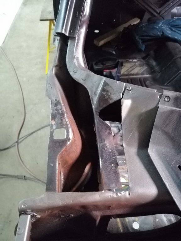

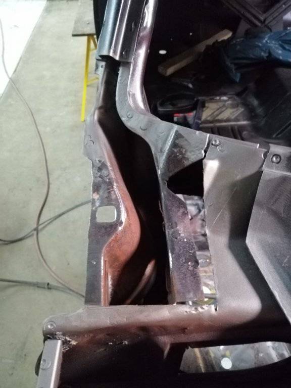

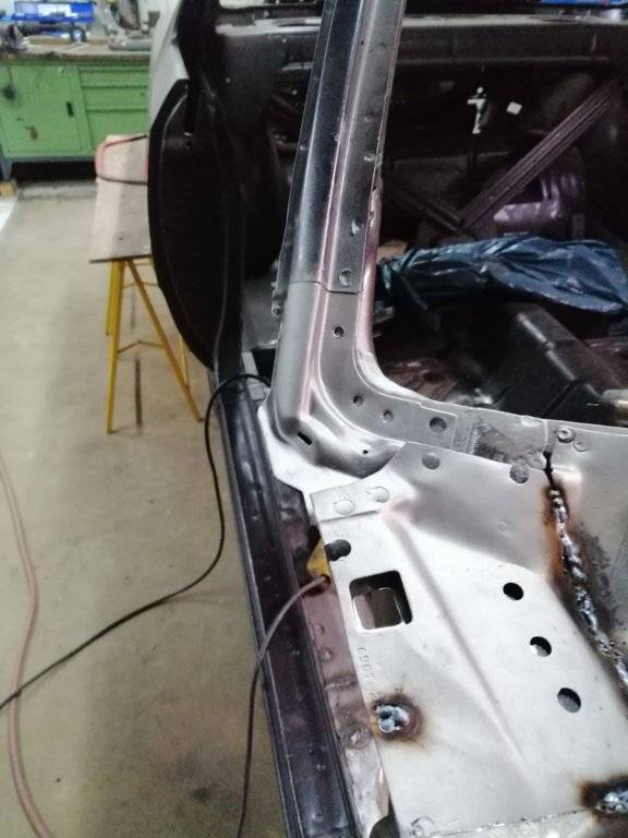

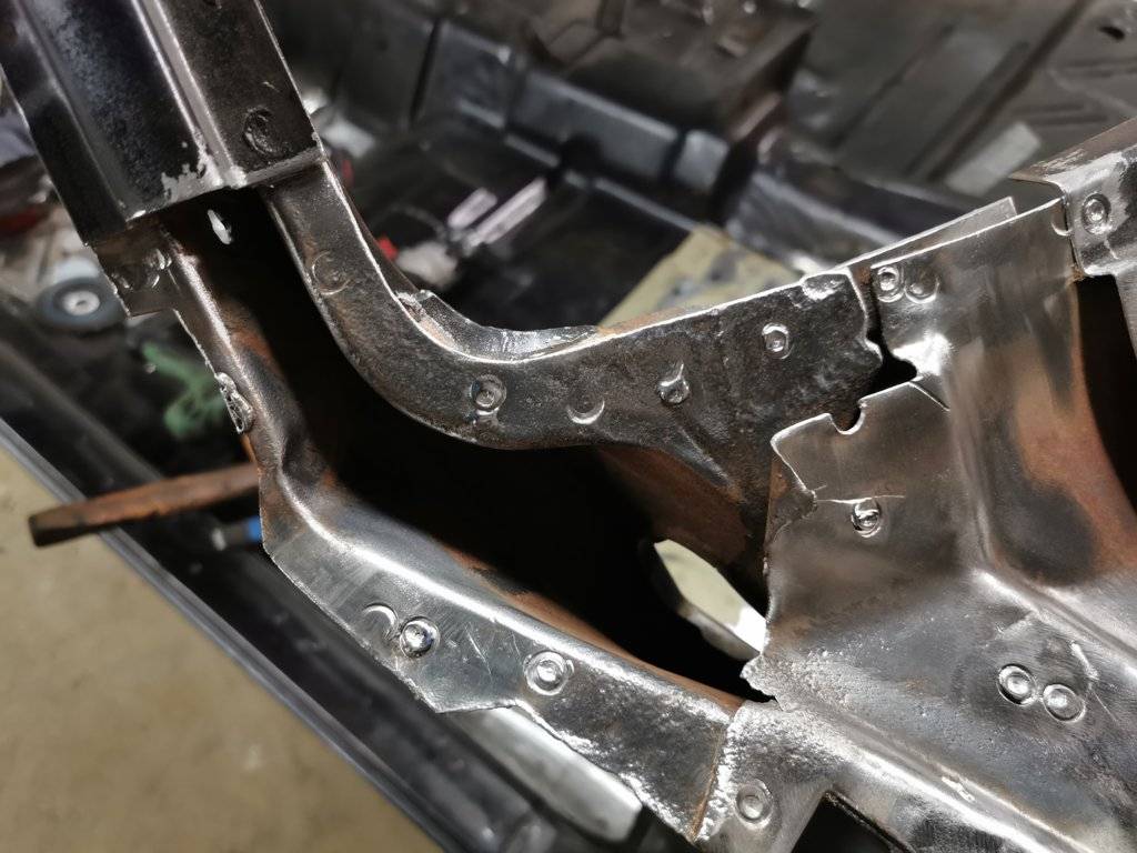

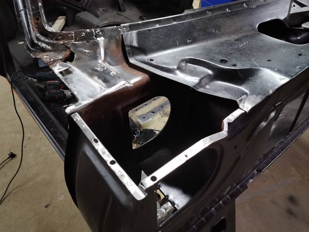

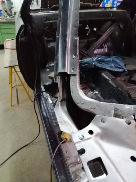

I took apart evenything on my car carefully the last time I was there.
Thankfully I had rust free donor pieces from my 72 donor imp.

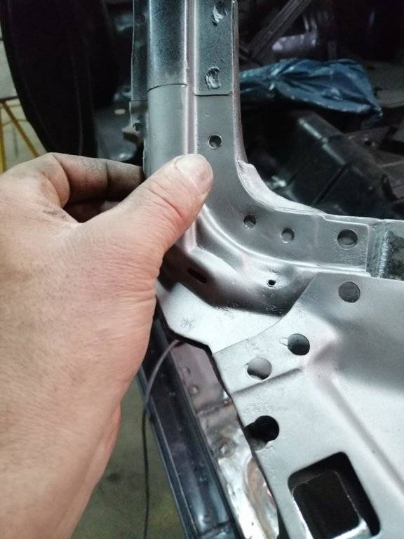

I prepared all the patch panels at home in my shop. Taking this sheet metal layer cake apart without damaging it was a challenging task at its own.

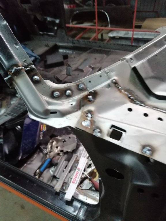

But I ended up with "almost" perfect patch panels. After cleaning, media blasting and applying weld primer to them I mailed them to my friend where the car is sitting right now and he welded them in.
Donor fender support brackets are on the fire wall as well. My original ones had both broken off screws in them and it was easier to replace them as I had good ones from the donor.

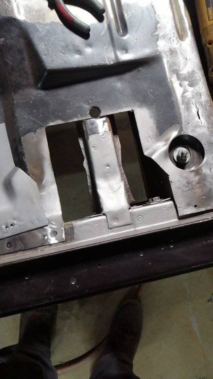

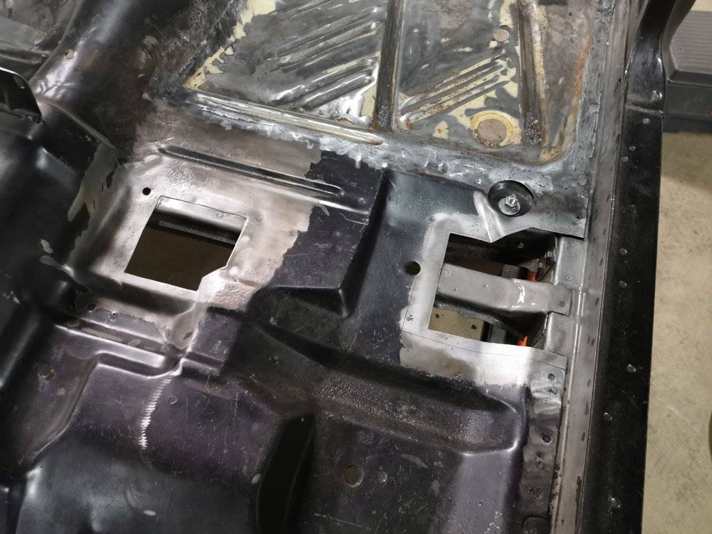

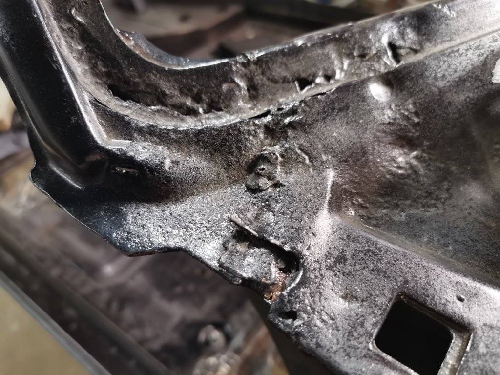

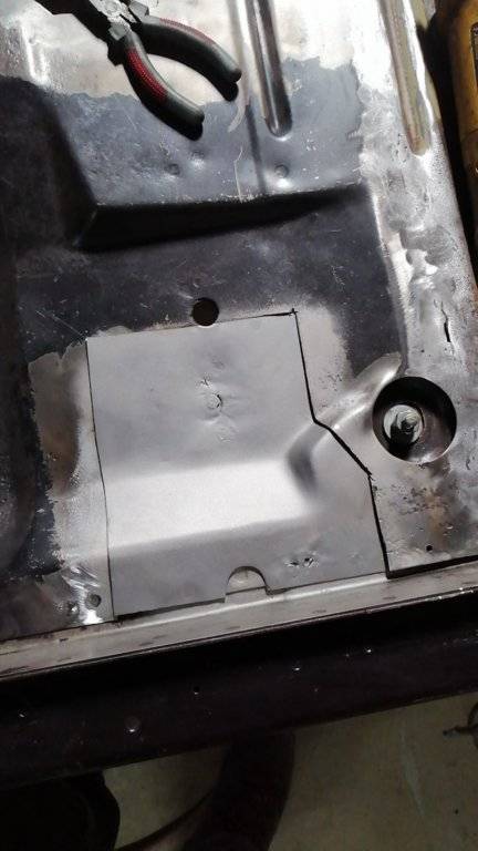

He also did some patching on the interior floor pans. I will post more pictures of it as soon as I have them.
These two panels are welded in now, unfortunately I don't have pictures yet.
