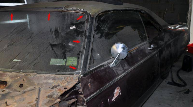

Hello! Sometimes you got to break a few eggs to make an Omelet! Dremel Tool with the small Burr.
I tried to reach the screws from the underside with a cutting wheel, but it's too tight to reach them. I will try a hand metal saw, but I'm not sure if I have the room for it either
Will a compact air chisel get in there?

Can you get at the underside of the bolts enough to get a pair of vise grips on and loosen them from underneath?
