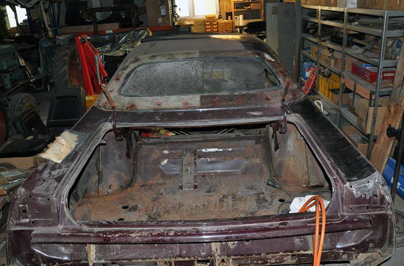

I tried to remove the rear window today. But I had a few problems.
All the screw heads of the lower screws on the fiberglass frame are too rusty to unscrew them... I don't have access to the screws from the underside to cut them and I won't damage the fiber glass with a drill...
Any ideas?

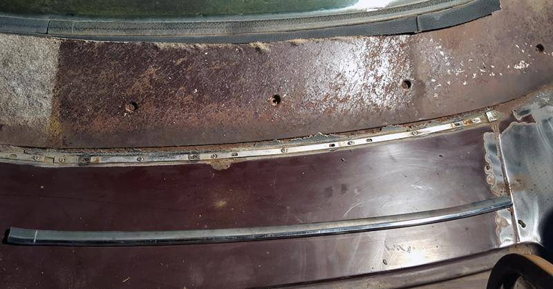

I don't know how to remove the center trim piece... This one is tricky! Does anyone know how to remove it?

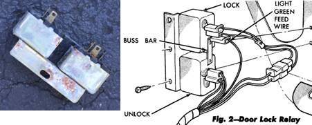

But... If you want, I have a set of door lock relays I took out of a derbied Imperial that I can part with.
Can you get at the underside of the bolts enough to get a pair of vise grips on and loosen them from underneath?

I will get this relays as well. Looks like the one I need for the door locks! Is this the one you have?

You'll need the linkage and the Imperial had switches in the arm rest. The linkage can be made and you will have to source some arm rest switches. There's also some sort of switch on the key lock. I've never seen one so I have no idea what that even looks like. That will be hard to come by.
The Spal unit solves a lot of problems and I'm quite happy with mine. You can lock/unlock both doors by either the key lock or the lock knobs. I can also use my fob. Both locks work together and there's no external switches. Unlock the passenger door and the driver door unlocks etc.
Keeping it original is nice though. If you want the relays just let me know.

Marian: The center crome trim pice on the lower rear edge of the vinyl top should be held in place by screws accessible from underneath the sheetmetal. There must be some access holes, at least that's how they were originally installed (when nothing was rusted out).

The linkage is attached to the solenoids, but the biggest challange would be to find the door switch panels and the door locks! Sounds like the better way is to use a modern system...

Hm, that's interesting, because I checked that. But maybe not good enough... I will check that again!

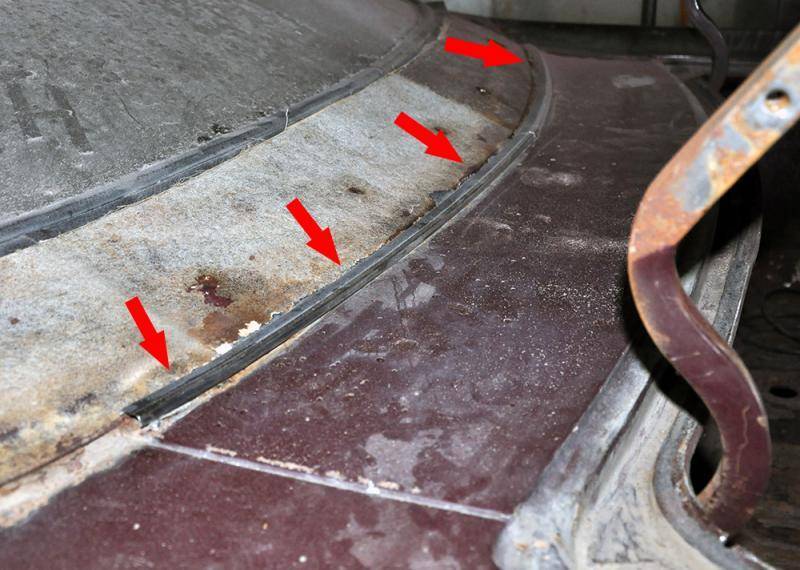

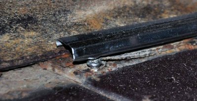

I was sure there is another way, because this is what the start looks like:
Hi Julian, I think someone in the past has screwed the dimple moulding clips up. IIRC those are suppose to be the same dimples that hold the side mouldings on with the plastic clips. The trim on my parts car is gone, I can get a pic for you tomorrow.That plated phillips head screw don`t belong under there.

You, or Marian was right. There were nuts from the underside. Hard to see, but if you stick your head underneath the panel, you can see accessholes and the nuts. The phillips screw was one of the screws that holds the vinyl in place.
But I wish I had never removed it..!

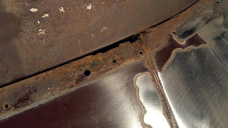

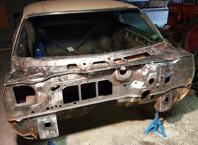

Small update. Still grinding off paint and rust. I'm using a combination of "cookies" and twisted wire wheels but I will have to sand blast some of the small corners and hard to reach spots...
I tried out the window removal toll today. Works flawless! Now I'm waiting for the trim removal tool to arrive.

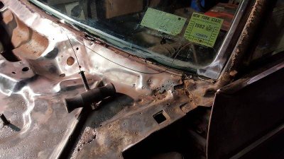

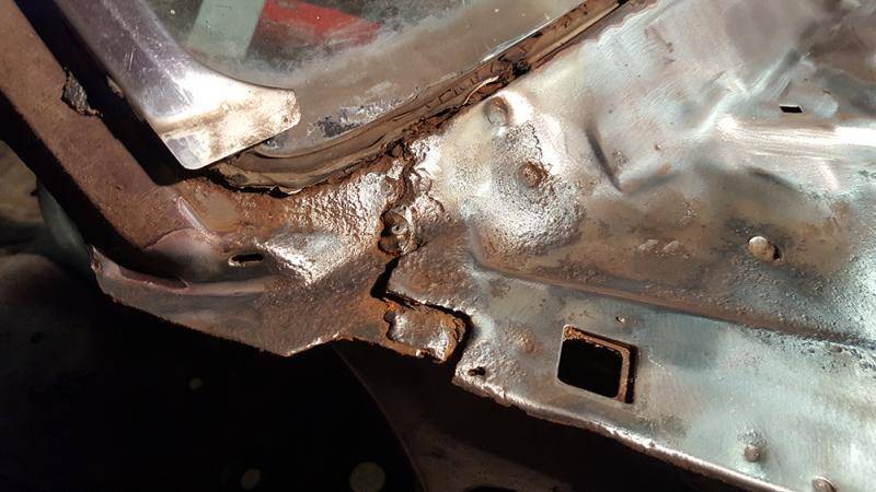

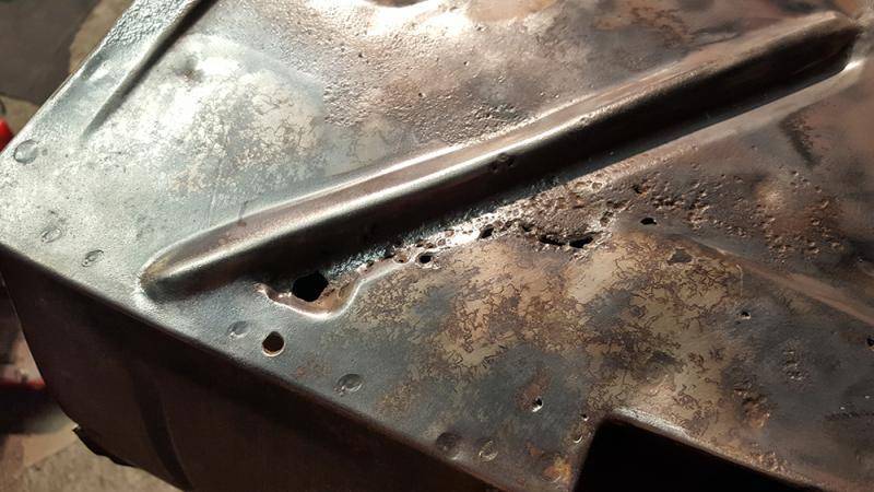

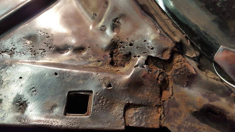

Unfortunately, I found more rust... I need to replace both outer ends of the panel in front of the windshield. (That's it called?)
Does this panel interchange with other models? 70 Imperials and up or even Chrysler models?

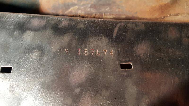

Just a question of interest. What does C9 mean in front of the VIN serial number?
the C 9 is assey plant and model year...
C = Jefferson Ave
9 = 1969
the 187674 is the part number of *THAT* car..... Known as the VIN
Thanks, that makes sense.
Does anyone know someone who knows someone that have a donor car with this panel?
