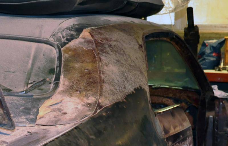

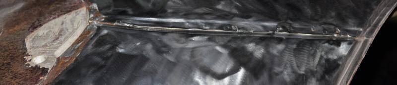

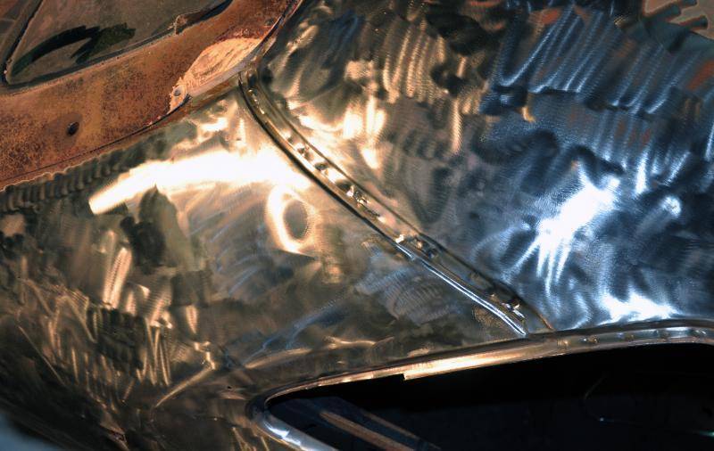

The normal paint is really easy to remove, but the finger thick bondo eats up the cookies pretty quick. But I made good progress today, at least until I had to learn that the protective cover on an angle grinder is there for a reason... The cut is, lets say bad to the bone... -_-

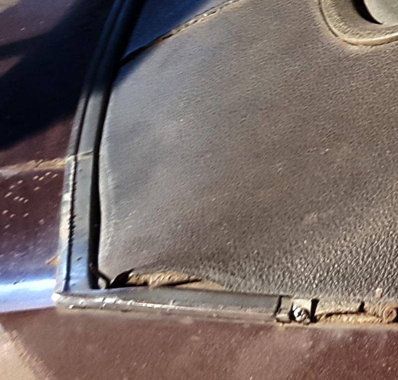

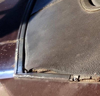

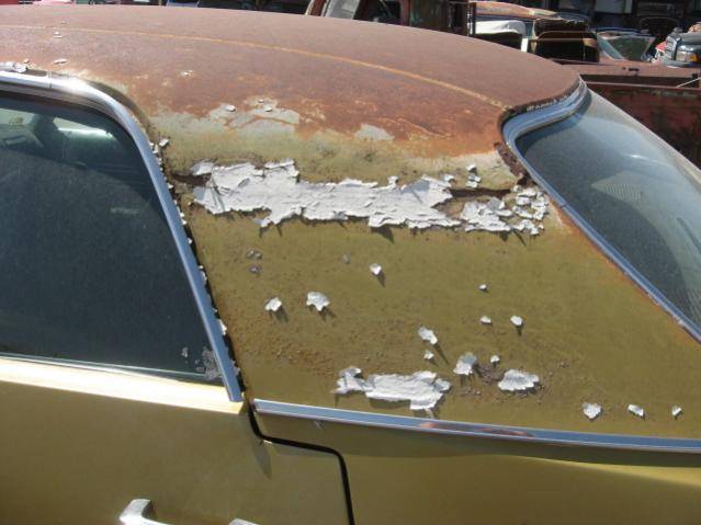

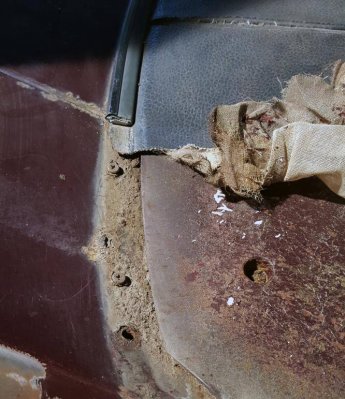

Is this messy butchering job on the roof seam factory work?

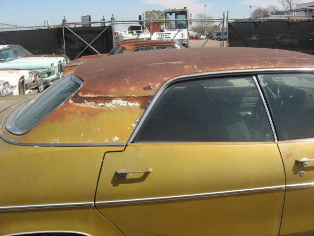

If that is on the upper half of the "C"-pillar, yes, that's normal. That is where the actual roof sheetmetal meets the "C"-pillar which is one with the quarter panel. I would expect it to be leaded from the factory (not bondo), but that's just a guess.
On some cars you can feel tiny knots under the vinyl roof along this seam, that's where the lead (or bondo?) expanded, it is not necessarily rust.
Wasn't there a discussion about bondo being used on vinyl roof cars and lead being used on the rest?
Both c-pillars on my 300 that came with no Vinyl top already have a pretty crappy Surface in These Areas, you just can guess a Vinyl top car with even less effort will look. So I'd also say what you have is what passed Chrysler Quality inspection. . ;) ..
That's good to klow, thanks!
And the bondo work was actually very well done. Absolutely no bumps, dings or anything like that in the vinyl roof!

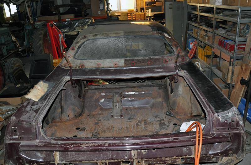

What you're gonna do with that fiberglass ? plug for the smaller rear window ?
The fiber glass is the frame for the smaller rear window. They kept the original window frame from the factory!
I first had plans to delete the vinyl roof but then I had to use the big window. And the interior panels are different too and on the LeBarons, the dome light is in this small window frame, too...

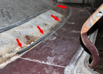

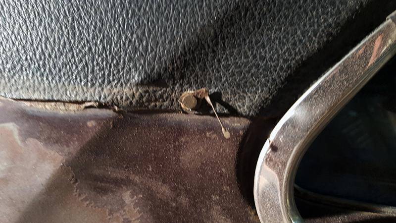

I tried to remove the rear window today. But I had a few problems.
All the screw heads of the lower screws on the fiberglass frame are too rusty to unscrew them... I don't have access to the screws from the underside to cut them and I won't damage the fiber glass with a drill...
Any ideas?
I don't know how to remove the center trim piece... This one is tricky! Does anyone know how to remove it?
Hello!I'm restoring a 1968 Polara Coupe. You've got yourself a real jewel there! Show her some love and make her happy again! I love projects like this, where everything is already there. All you've got to do freshen things up a bit. The task will seem daunting at times but every time you take a rusty, dirty, oily, broken part and recondition it and place it back on the car that's when the "Christine" Magic starts to happen! Good luck!
Hello! You have to have the right trim removal tool! Go to your local auto supply and get the trim kit it has everything you need to do this without damaging the trim.
