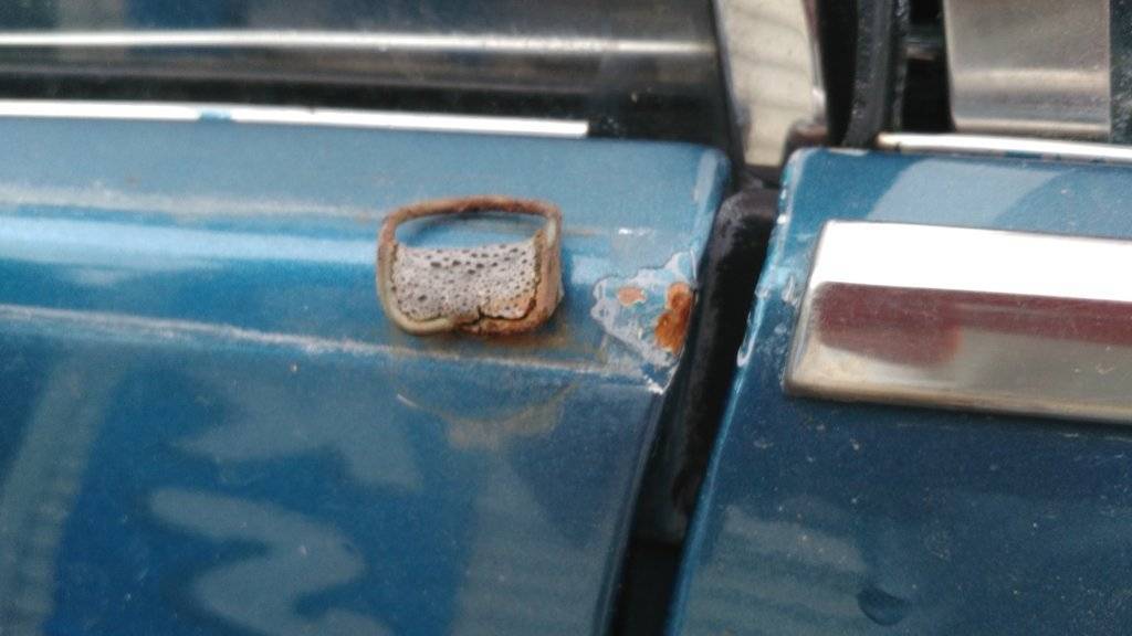

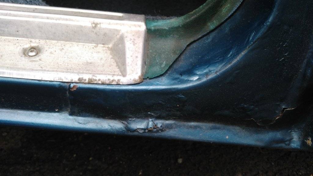

Q1. Original paint or not? (pics 1 and 2)

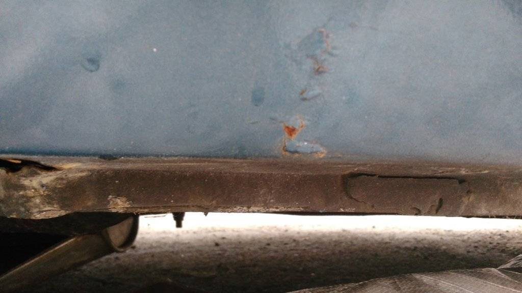

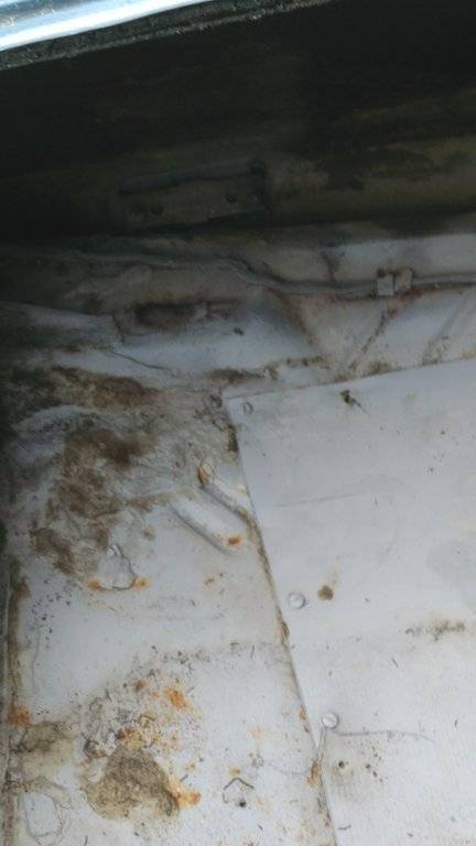

Q2. While I could not get it on a lift, my untrained eyes have questions about rust. What do you think of the attached pics? (pics 3 and 4)

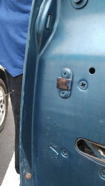

Q3. What do you see in in the trunk? (pic 5)

1. Pic 1 & 2 show not original paint however it seems to be painted B7 Jubilee Blue or close. I like the color.
2. Pic 3 & 4 cracking bondo filler from a previous repair, I would imagine there is other bondo in the lower door panels, and ot fender panels front & rear.
3. Pic 5 Sheet metal trunk patch I am assuming from most mopar convertibles the trunk floor pan is either soft and flaky or essentially non existent and would be very suspicious of the entire floor panels front and rear as well.

That's not original paint and that's obvious. Rust and rust repair has to be looked at critically and overall condition taken into account. The spots shown could be isolated issues, like the typical rocker seam for example. The door jamb just doesn't look like the typical failing Bondo to me, but pictures don't tell the whole truth. It does need more scrutiny before the car is written off as a rust bucket or as worthy of the price.
The patch in the trunk is bothersome, although we all have seen otherwise nice cars with that repair.
