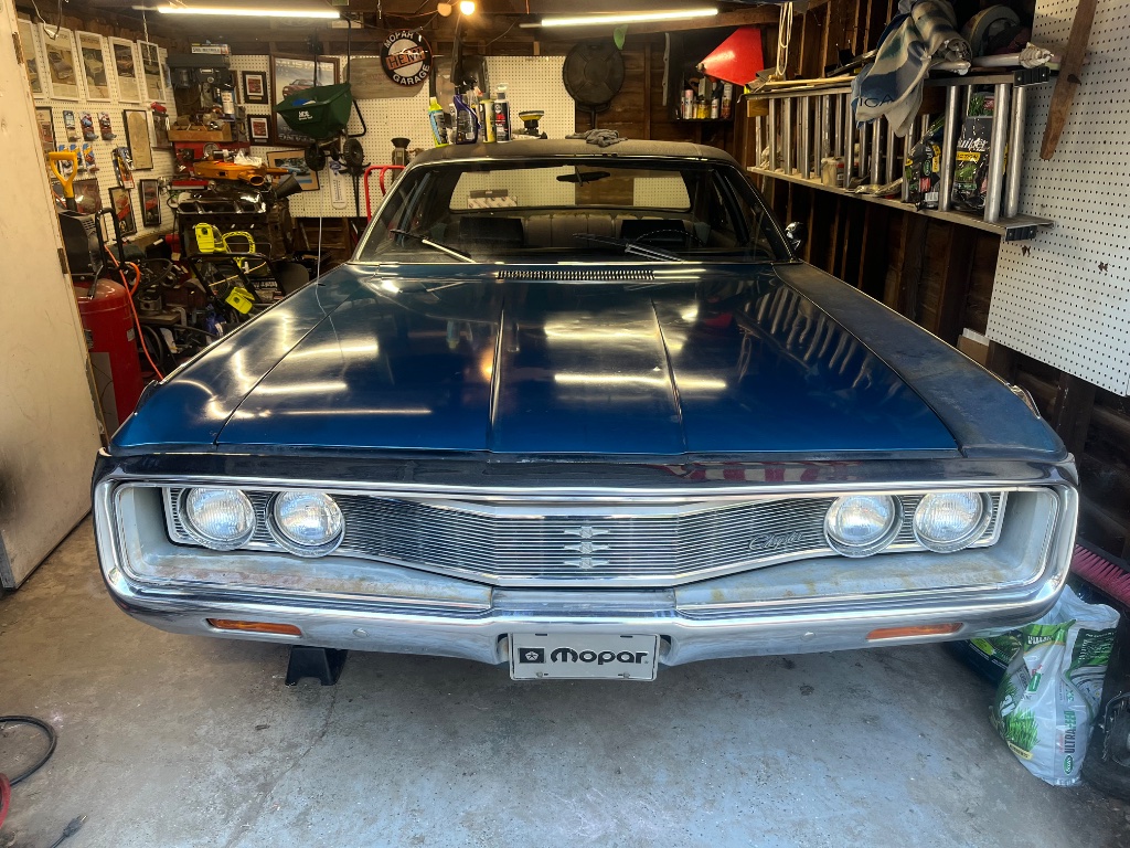

I have a 1969 Chrysler Newport custom 440 build date is March 3,1969.
My question is what date code/quarter spark plug wires to use, I think it’s the 1st quarter, doses that go for rad hoses and belts ext. Thank you for any help.
