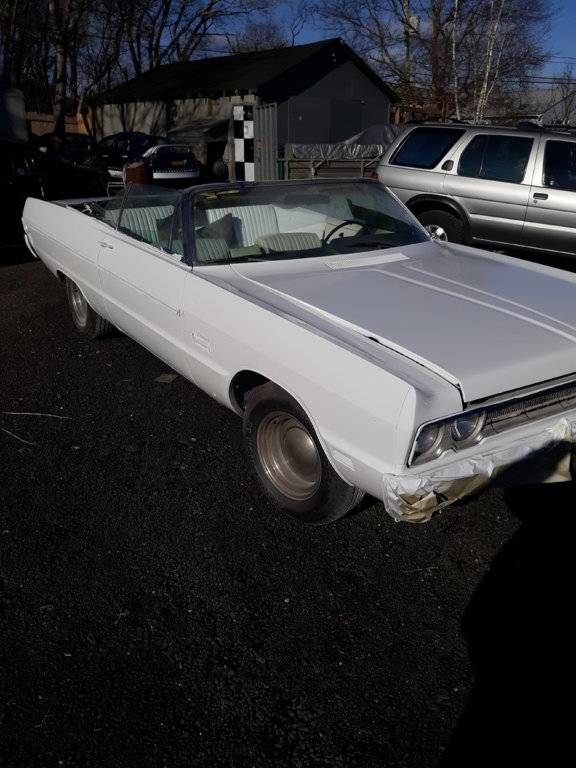

    1969
    1969 Plymouth Fury Convertible
    Climate controlled storage car that was a local town owned vehicle specifically used for it's parade and fair events.
    Not used since '95 and stored with decommissioned police cars from 70s and 80s , it was forgotten about as inventory, records , and accounting didn't exist for these items...life was good back then huh ? Lol
    Needless to say ...in really good condition structurally and mechanically.
    I bought car (and 8 other police cars) and have brought them back to life with every detail not overlooked.
    Car was given to B.O.C.E.S. , a trade school curriculum for students who may or may not have college. It's auto courses are Mechanical and Auto Body respectively. The Fury went through both start to finish
    First ....Mechanic Technical
    Fuel system entirely replaced from tank and sending unit , lines , filters , as well as carburetor
    Brake system completely replaced from Master Cylinder to lines , hoses, wheel cylinders, and all hardware, springs, shoes,drums.
    Suspension refurbished around with replacement rubber bushings, grommets, and alignments.
    Engine was poly flushed , compression tested without faults , new plugs , wires , distributor , as well as oil pan drop , main and bearing inspections , valve guide inspections and adjustments , new gaskets and detailing.
    Transmission was flushed with new filters, gaskets, and valve control moduale.
    Exhaust was completely replaced from manifold back including all hardware and hangers.
    Car turns key , starts , runs and drives as it should ...no ticks , no taps , no smoke , no noises , no B.S.
    Second...Auto Body Technition
    Overall body lines and contouring were straight as car has never been hit or accident...not that many town parades are speedways or danger zones. Lol
    Car was completely stripped down to metal and Dupont epoxy sealed and primed
    As far as rust , rot , or panel repair...the rear quarter bottoms on both sides were only areas needing attention .
    Rear passenger floorboard had new tin put in
    Trunk was poly sealed with fiberglass resin for strength.
    Paint is high gloss , period correct ,
    "High Impact' Alpine White , reproduced by 3M for this project.
    Car was painted completely 100% with under hood , door jams , and under trunk lid included. Under hood has new heat shield matting installed

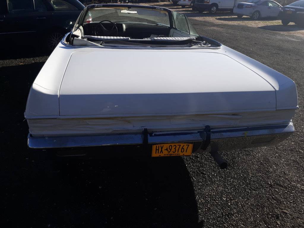

    Oh man they couldn’t even take the masking tape and paper of the car before taking pictures. Fibreglass repair done in the trunk. Big Red Flags IMO

    I agree and disagree with the glass in the trunk. Is it a cut corner? Absolutely. Depending on how rusty it really was it may not be too big of a problem. Treating and patching a few small thin spots that way should hold up fine for many many years if the car is taken care of and not exposed to the elements. But if the trunk floor was toast and they matted the entire thing with glass would be a complete different story. They should have unmasked the car and taken pictures of the trunk repair.

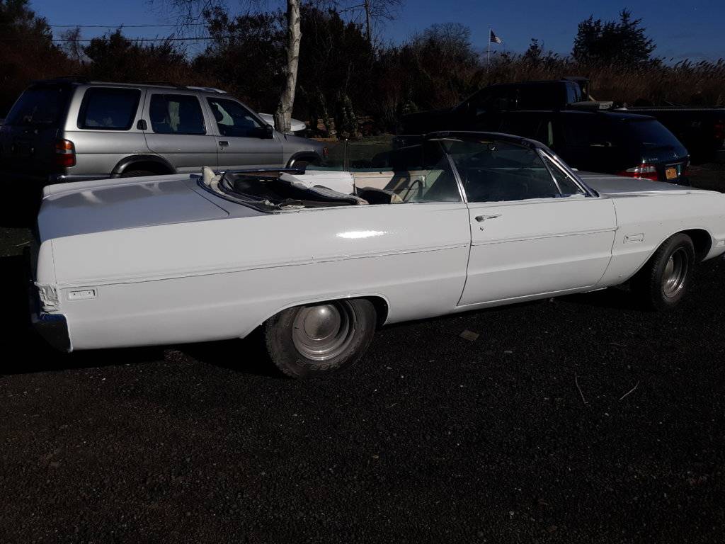

    Some one teaching the paint class needs their head examined, all the chrome should have come off for a quality job.

    They even painted the wheel well trim white

    "Car was completely stripped down to metal and Dupont epoxy sealed and primed "
    Didn't happen... How was it stripped under that chrome mounding?
    "Transmission was flushed with new filters, gaskets, and valve control moduale."
    really??? Exactly WHERE is this "valve control moduale" located?
    "valve guide inspections and adjustments "
    Explain to me how to adjust a valve guide?
    Screw it,, why bother going on... Y'all know this is a total bullshit advert......

    The trunk lid is misaligned among other flaws.
