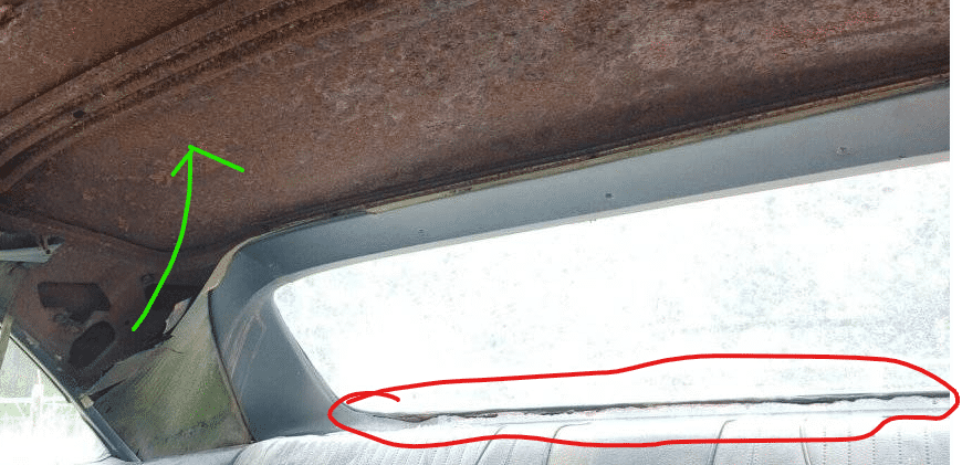

The roof looks very suspect to me. It's rusting from the inside.
On a side note the guy has a plethora of cornbinders. I have a soft spot for those.
I have similar rust scale on my TX9 and the '73 NYB I scrapped. As long as it's not perforated I think it's treatable.

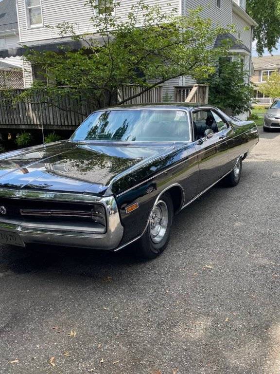

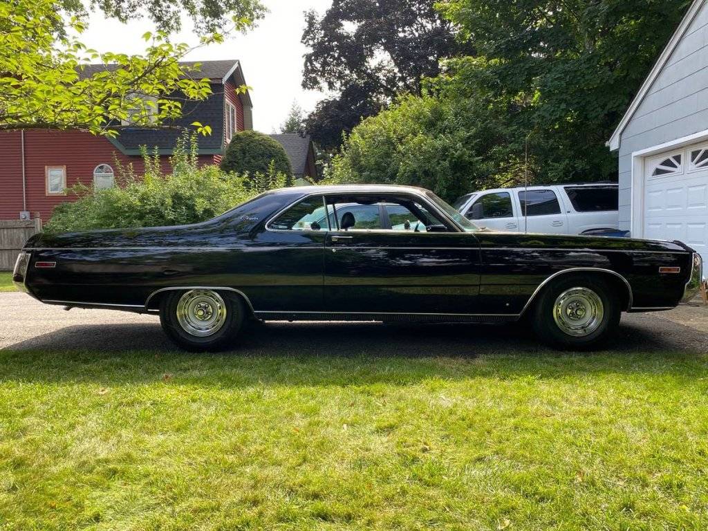

The "for sale" thread marks CM23U0C223008 as "sold", but that is probably due to FCBO rules and a month of no new post: this superb all-black 300 went up on Craigslist with a few new pics and a lowered $27k ask four days ago. Here are a few more pics from the ad -- @69CoronetRT and @cuda hunter , the build sheet is here:

I think that is the most beautiful and desirable Fuselage I have ever seen.
Post pics if you want to prove me wrong.

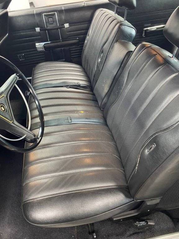

All the money spent on options but got a credit for ordering bench seat!
Slide on over honey as I hit the gas around this corner!"
I don't think Rusty's talking about the green arrow, I think he's talking about what's in red. That bottom piece of trim is metal in 1970, and it's rusting away, there is material missing. The exterior of the roof looks OK due to no VT, but I'd bet that the structure under the Dutchman has rust. A 70 300 I had was OK on the outside, but the laminations of metal for the rear window channel were puckered, and the under-dutchman had some rust-thru. You couldn't see it unless you were lying on your back inside the trunk where the spare tire would be.
IMO, this was a $4-5000 car due to lots of unknowns and obviously needing lots of $$ to restore.
We cannot tell whether it has good bones, or whether it merely looks like it.
