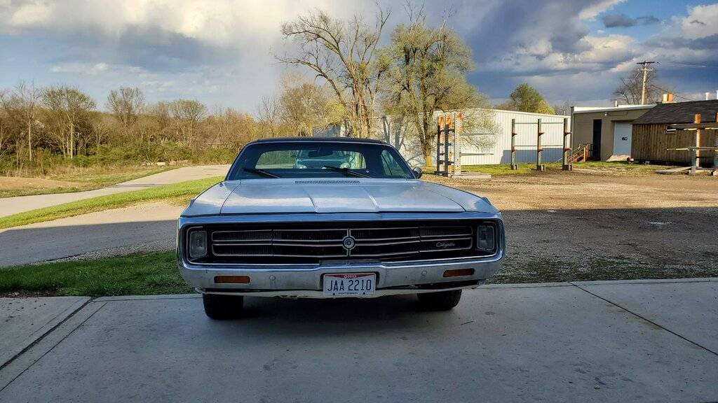

I’m finishing up testing and re installing the factory front light harnesses on my 70 300 convertible and I’m wanting to change out my headlights while I’m at it.
I know there is a way to manually open the headlight doors so that I can do that; the decal is gone that says how.
Can anyone enlighten me on the procedure for manually cranking the headlight doors open?
Knob on bottom.
just turn the ignition on, turn on the headlights then turn the ignition off. the doors will stay open until the ignition is turned on again ( with light switch off)
