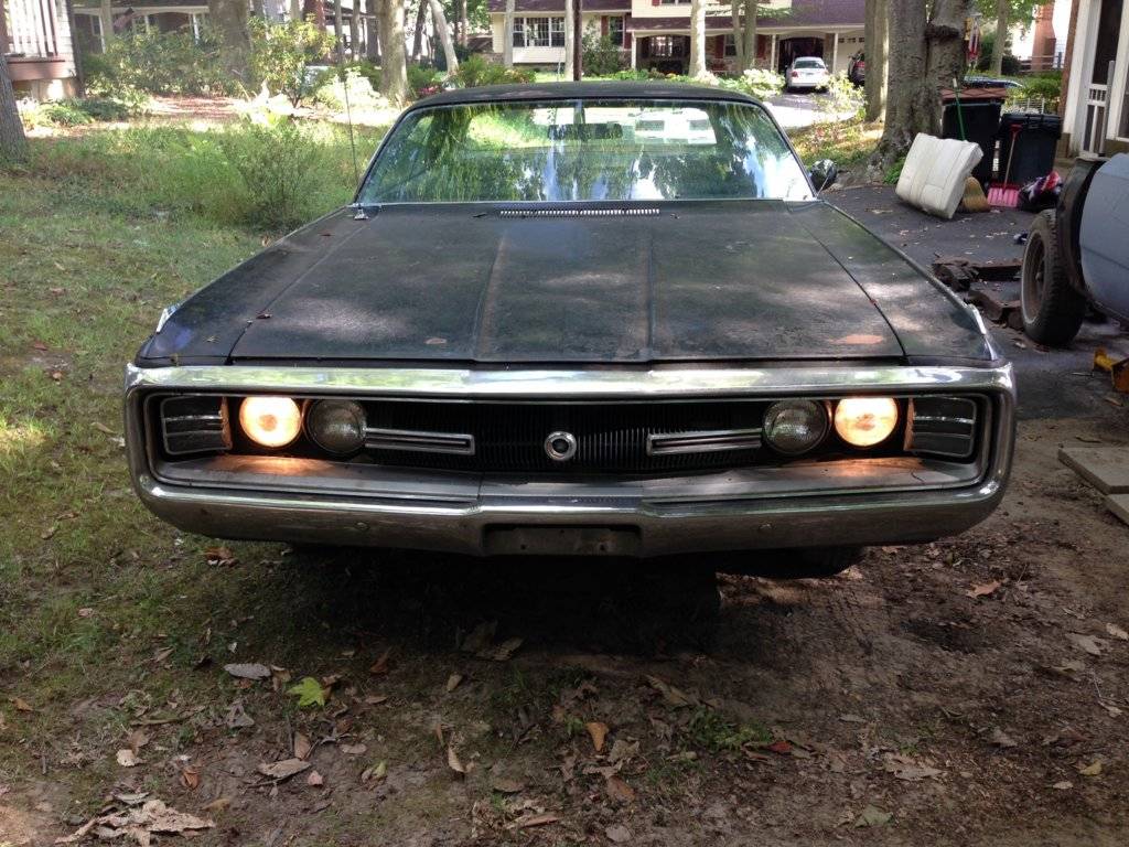

Other than the interior being "baked", what is the rest of the car like regarding options, condition, rust, etc?
The Car needs new Vinyl and as usual the rear window frame is rusted , there is no point to spend any money on this car the trunk floor is in great condition if someone needs a trunk floor

If the window frame is the only rust issue, I don't think that should be a show-stopper. There must be another way you guys can get the parts you need. . . I can't see much of the car from the photos, but it is one of the desirable colors, and its a four-door hard top too.

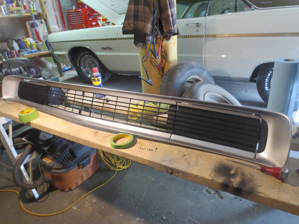

Derek, I'm not trying to "beat you up" or point out errors. I just think items on the car should be correct.
RE: your grill paint isn't right.
In fact, most 1970 GT's that get restored miss this..there should be silver/argent on the lateral "stripes" on the grill, not completely blacked out. It takes much more work to do, but it really makes a difference in the appearance of the car. Plymouth easily could have not done this detail when they built the cars, but they made the extra effort to do so, as part of the design. Therefore, I think it's an important detail not to overlook.
Not trying to criticize your work at all,...I'm just not sure you were aware. Many people are not.
The way to do it is, paint the entire grill argent first, then mask the lateral stripes/ridges in the grill, then paint it black. Like Mick Jagger said.
Just a thought.
Here is a link to YouTube which shows what it should look like.
So if it's for a higher profile C body, it's okay? So it's fine to rob a 440 out of a 300 convertible for my Monaco 500? Or would a Newport be a better donor. I get the saving money, good sheet metal part, but a trunk floor, a steering wheel, and the drivetrain? And the shell is worth $5,000? I need to start smoking some Colorado weed to understand the logic. I should scrap all but one car then due to rusty window channels, what am I thinking? If I did this for any car, I'd get ripped from everyone. Glad you got your parts, but I'm baffled. Guess Sport Fury's are donor material now? I have a dart and a truck need a 440.

I took the steering wheel, Windshield,like new windshield washer bottle, nice road wheels, pwr seat and window switches, booster master combo, 3:23 sure grip and fuel tank and some other little pieces, Critter is getting the whole power train including radiator and all the ac parts he needs for his GT and perfect door pulls.
If someone here in CANADA needs trim parts our something let me our Critter know before i sell the shell to my demo derby buddy.
