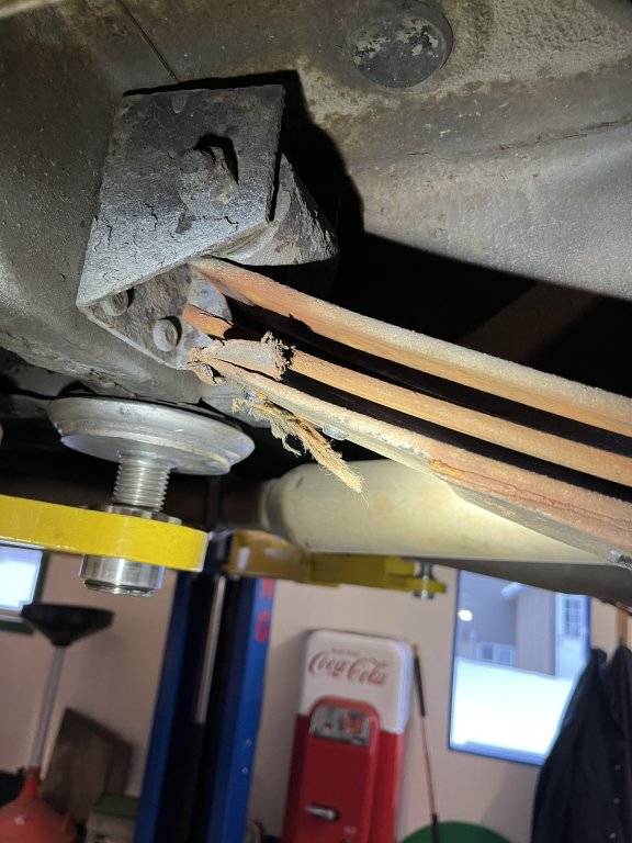

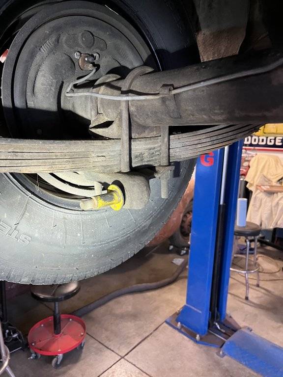

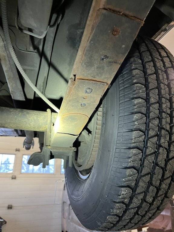

I did look at that with the car on the lift to see if he added a block in the rear, or changed shackles, but there is nothing like that and the springs appear to be original and are in the same shape as the rest of the underside of the car.
That doesn’t mean that the springs weren’t used ones from another car I guess.
You are definitely on to something big John as comparing the photo of your car to mine, the line of the top of the wheel arch is much higher on the rear tire than it is on your car.
I’m definitely going to investigate that rear end further.
If anybody spots something out of the ordinary, let me know but as you can see the spring appear to be the same age as the car.

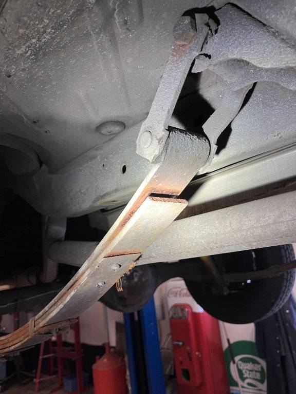

Looking at the second and third picture, the springs have had extra leaves added.
That means that someone has "rebuilt" the springs, and with that rebuilding, the other leaves were rearched and that usually means a higher ride height... along with a lumber wagon ride.
I would suggest new springs and one company I've used is Leaf Springs For Your Car or Light Truck 1940-1990's+ I know the shipping to Canada would be high, so maybe asking some of our Canadian members here can give you a different vendor. @cbarge might have someone.

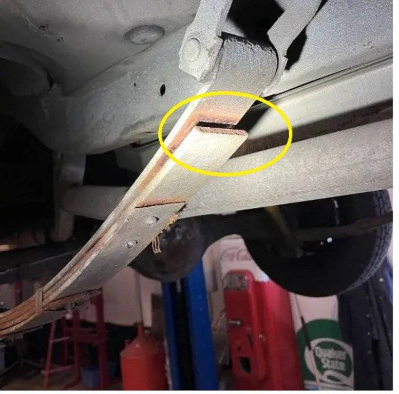

And just so you know, this is an added leaf. The big tell-tale is the rough cut end with no taper. It's also almost as long as the main leaf. Looks like it's been there a while, bet there's holes for a trailer hitch under there.
