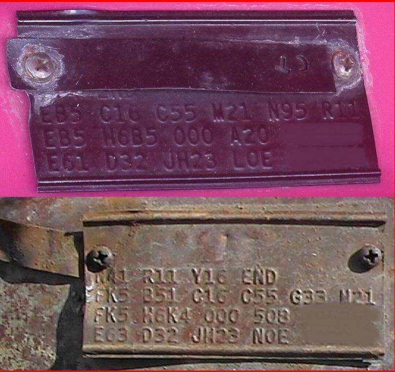

When you bought the JH23L with the E63 pkg you got the 330HP engine.When you bought the JS23N you got the 335HP engine.
Pretty sure the L code was the E61 383-2bbl while the E63 was the N code 4bbl.

My 2 cents. My 70 Challenger JH23N, E63 dual exhaust and dual snorkel air cleaner, painted corp blue, car was built in L.A. . There was red stripe valvle springs in it and same cam as the 335 horse engine. All e body BB have HP exhaust manifolds even 383-2 bbl because the engine sits lower and logs will not fit between the shock towers. If my car was a JS23N it would have been painted red and stamped HP and called 335 horse. I know it it not a C body but Chrysler did not change stuff on a mid range engine to cross car lines.
For the 1970 MY, the B and E assemblies are the same. There are at least six known possible assemblies for E bodies. Cars rated at 335 horse would be orange. Cars rated at 330 horse would be blue. The manifolds had to fit both E and B body cars.
Applications of the engine assemblies vary by a couple of factors; one factor may or may not be model.
There is no 383-4bbl manual transmission 330 horse B/E body assembly in 1970 so any B or E body four speed car would have the 335 horse engine w or w/o A/C regardless of model (i.e. JH/JS, BH/BS, WH/WM, RH/RM)
Automatics with or w/o A/C could be 330 or 335 horse depending on the application.
Again, using simply the N VIN or E63 sales code only tells you what, not which, engine was in the car.

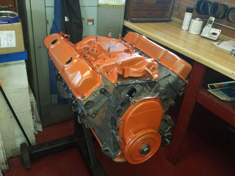

My '71 Challenger is coded E65 which is in the book as HP 300 horse which appears to be the only 383 4bbl available that year. It's an ac car so what color was the engine originally?
My 69 383 Bee engine was orange. It was only 2 years old when I bought it and it was completely stock and untouched.
I love these threads that get deep into what Ma Moper did or didn't do or produce.
No seriously. It's freshly rebuilt and I need to paint it shortly. It hadn't even dawned on me that it maybe should be blue...:sSig_thanks:
Matt, Should be blue the red was for R/Ts, VINs JS which yours can't be as there were no R/T convertibles in 71.
Napa sells Duplicolor engine paint in Chrysler corp blue, it is what I used on the 400 I just put back in my car. It will look a little light when first sprayed but darkens up as it dries.
