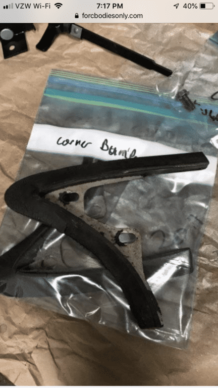

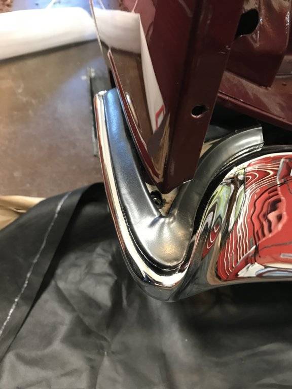

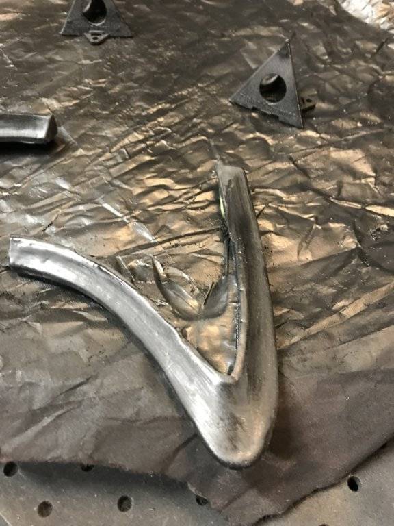

I rebuilt the corner fillers on my ‘68 Polara. A little smaller piece but turned out better than expected.
I clean them good. Sanded them a little and then sprayed with black Plasi-cote. Let it dry, sand, repeat. It may be quicker if you can find some type of flexible rubber sealer that you can trowel on to fill the cracks, sand and then plasti-cote.
