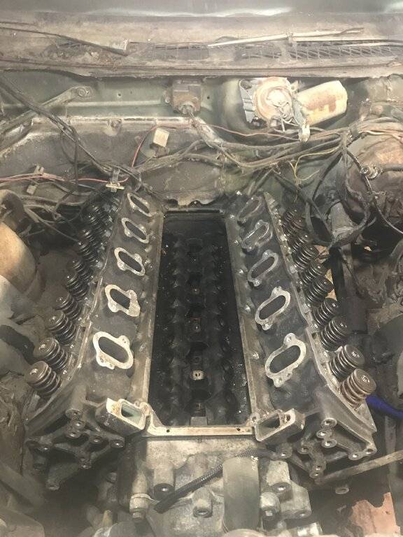

These are the viper heads and I’m pointing out the coolant passages that need to be plugged then new passages drilled next to the head bolt holes to match the block.

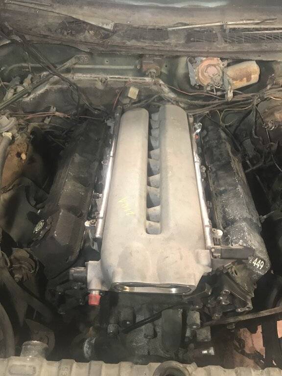

Here is a picture of what the viper/Ram comb engine will look like with a SRT10 intake.

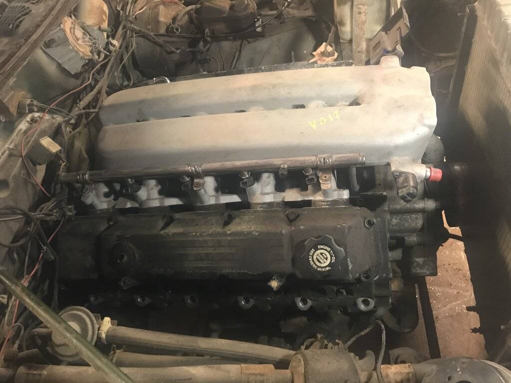

FYI I don’t have viper valve covers yet so I put the truck ones on to give it a more complete look. The value covers cost almost as much as the heads on feebay. Lol

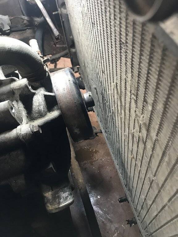

I did get the engine set back as far as I can and it clears the radiator but it looks like I will have to run electronic fans. Maybe have to mount them in front of the radiator.
