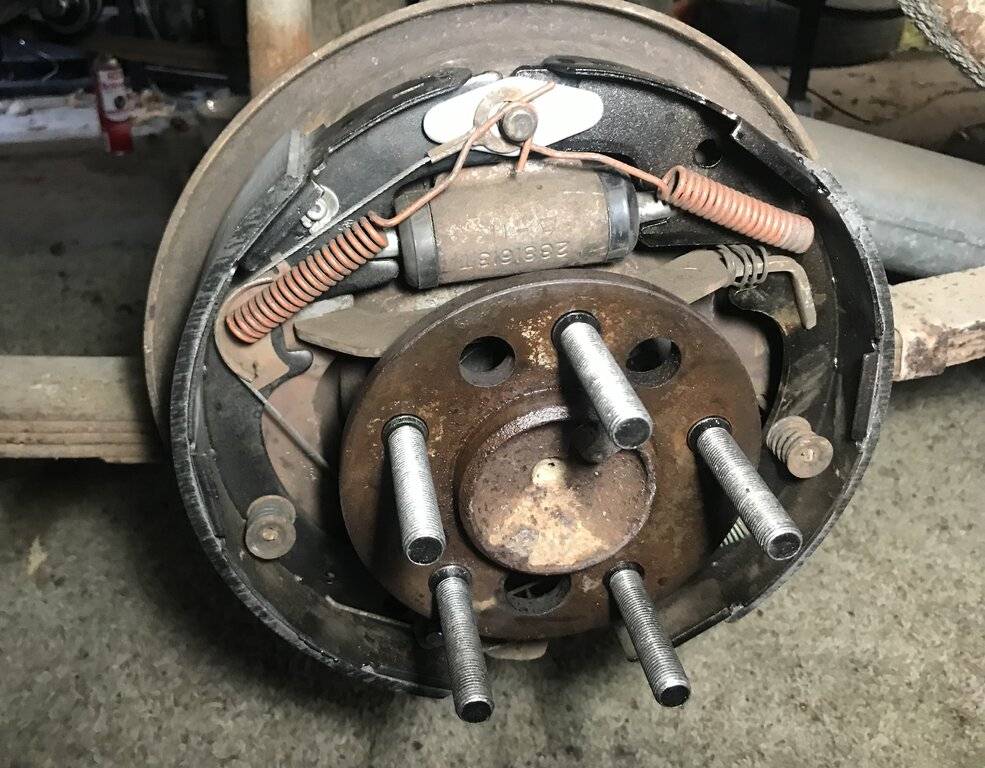

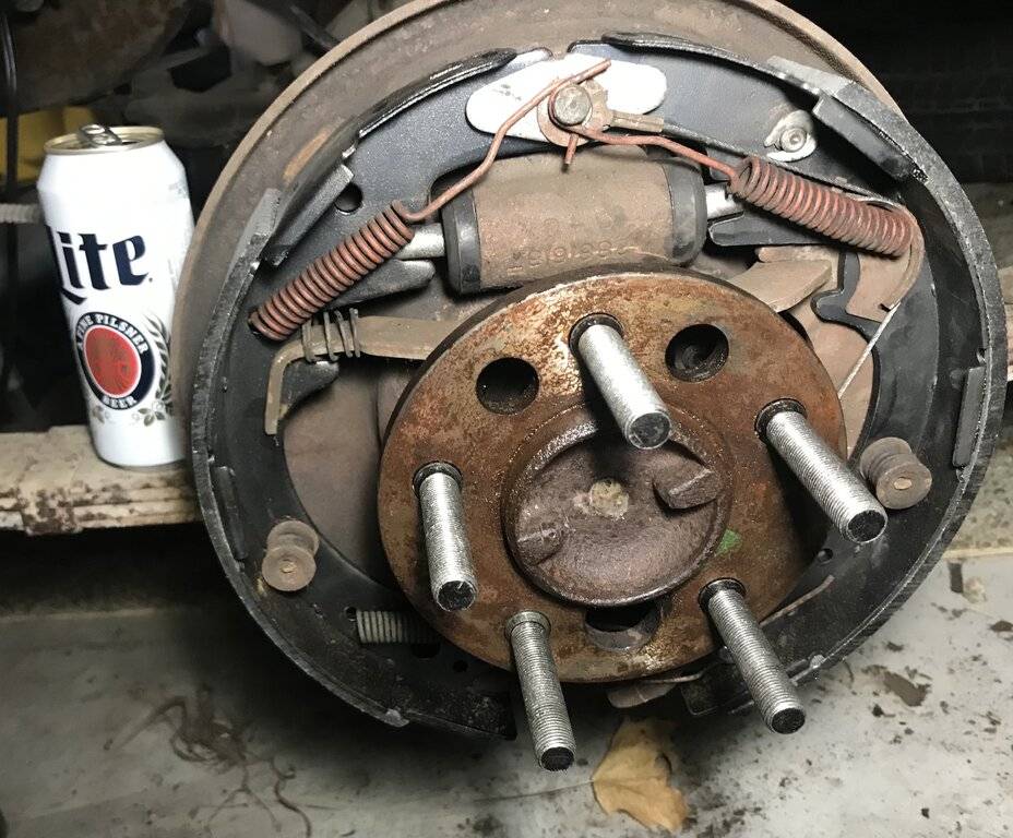

I was amazed the wheel cylinders and all the brake hardware could be reused. The bleeders even opened without any fuss. Very unusual for a car from the north.
I also repacked all the wheel bearings and adjusted them.
Oh and replaced the stock wheel studs with 3 inch RH thread.

Those are some SERIOUS wheel studs, what are you planning on mounting?
Well I wanted to switch from LH to RH studs anyway and at some point this beast is going to run a 1/4 mile at a strip and they will want to be able to see threads thru the lugs in order to pass tech spec. I also want to do a flying mile to see what kind of top end speed I can get. My goal (when I get the Viper/Ram hybrid engine done) is to be able to run a 12 second 1/4 and 150 in the flying mile without changing anything other than tires. I hope to be able to do both test runs with the stock V10 this year, then swap out the engine and run them again.

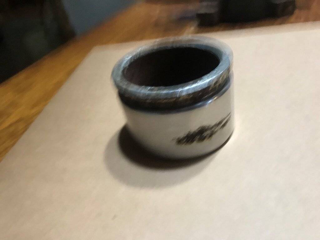

So I got the master cylinder installed with out any problems and started bleeding the brakes. Then I had a problem with the front calipers not releasing. I thought maybe something was wrong with the master cylinder and it was holding pressure so I opened the caliper bleeders and they still would not release. I thought the calipers could be used without rebuilding because when I removed the old pads the pistons moved back hard but were not stuck. I thought wrong. When I got the pistons out they were pitted and rusted just bad enough to stick. The seals were in good shape for being 51 years old and the caliper bore was not bad. I ordered new pistons and seals from summit for just under $60 shipped.

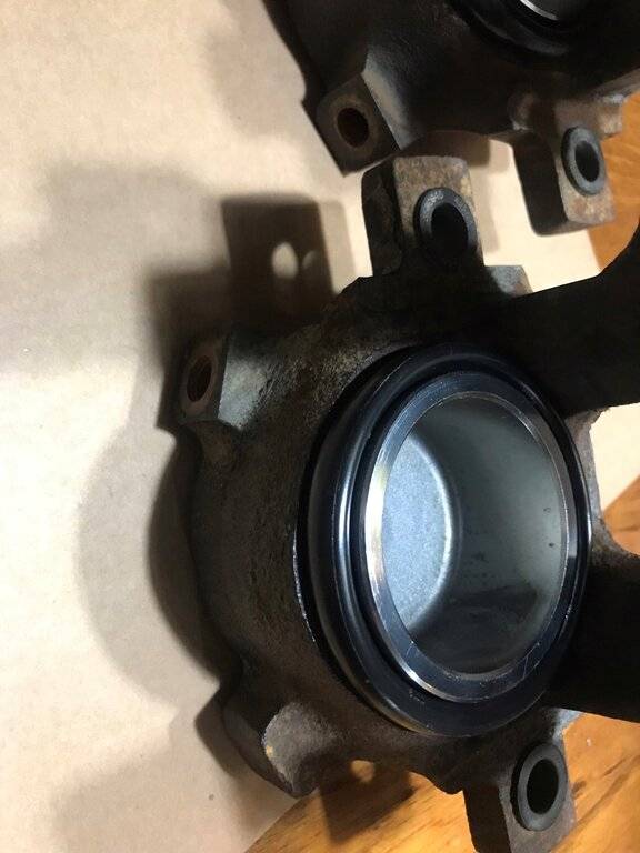

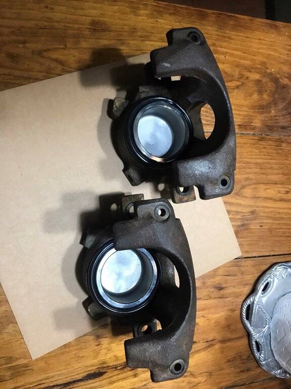

The caliper rebuild went well. Only had to hone the cylinder bores a little. Vary happy with the new Raybestos pistons and seal kits. Sorry I always seam to forget to take pics till I'm done.

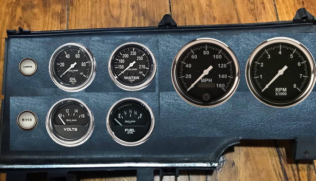

I came up with a design for my dash and gauges. I can't use the stock speedo because it is mechanical and the V10 PCM needs to have the VSS sensor where the cable would go on the trans. I also hate the square design of the stock gauges. lol
I already had a full set of auto meter gauges left over from a project I never did. Going to use electric speedo and tach from speedway as the number font and needles match the auto meter gauges I already have.
Going to swap the stock lights and wiper switches for pull style.
