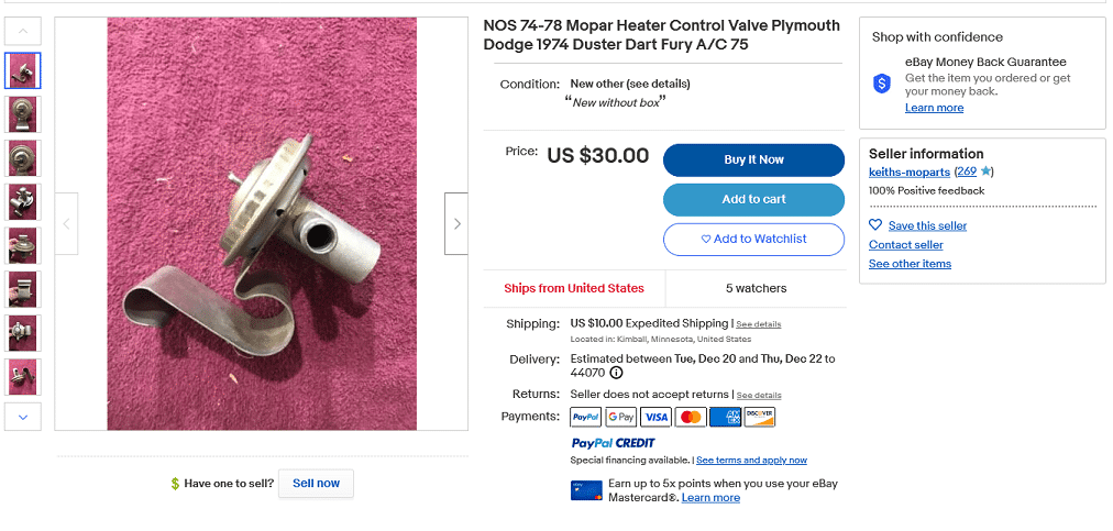

Screenshot 2022-12-15 at 22-32-42 NOS 74-78 Mopar Heater Control Valve Plymouth Dodge 1974 Dus...png
There have been metal heater valves to replace the phenolic-body heater valves, even when those cars were new. I put one on my '70 Monaco 383 4bbl, after I bought it in 1975. THEN I noticed that under certain vac levels, a buzzing noise would come from the temperature slide bar area (a variable vac bleed). Obviously, the larger vac reservoir area on the OEM valve dampened the vac pulsations a bit better than the smaller one on the metal valve? Moving the temp lever a bit would usually stop the buzzing. Never did put the phenolic valve back on the car, back then.

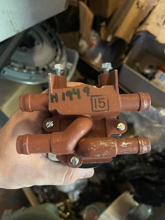

Oops, I just noticed the new metal ones are only 1 pipe. The 1970 is 2 pipe. Anyone know the part number for a 2 pipe or how to hook up the 1 pipe? (pic not mine)

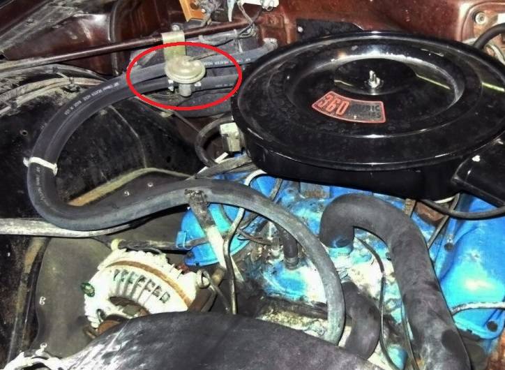

I'm thinking of buying a new one like this. I guess it goes on the flow going to the heater core, correct? This is for a 1975 360 but Ebay says it will work on all 1974-1979 V8 mopar engines. It should work on a 1970 440 with A/C and ATC correct? Why did the 1970 models use both heater core hoses? I don't want to ruin my heater core. Thanks.
Wondering if you might need to add a vac reservoir to the system, as GM and Ford used, to dampen the vac pulses and stop anyu possible buzzing? Most of the GM items were round as Ford used what looked like grapefruit juice cans (painted black with vac connections/valves on their top). GM and Ford reservoirs had check valves to prevent/lessen vac loss on the supply side.

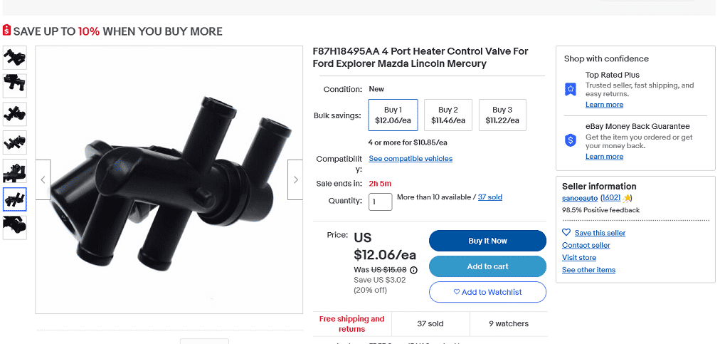

I read that I need to use the 4 tube bypass version since the coolant needs to continue to flow back thru the top of the engine or heads or something vital like that. Anyhow, does anyone know why Mopar went to a 1/2" heater hose for 1 hose while still using 5/8" for the other? Before 1970, they were both 5/8". Kinda of weird but probably a good reason which I don't know.
Anyhow, only a few vacuum 4 tube ones out there. This one is probably a cheap plastic piece of crap but so are the $100 ones I've tried. These are widely used on Fords. The hoses are both 5/8". What do you think?
Screenshot 2022-12-17 at 23-14-35 F87H18495AA 4 Port Heater Control Valve For Ford Explorer Ma...png
Using different heater hose sizes ensures the hoses get hooked up correctly. On the assy line and later on. Chrysler was not the only brand doing that, back then.
I'm about 99% certain that the second "pipe" is straight through with no valve.
Thinking about this, the '74 valve really look like the same valve except it's on a slightly different mounting bracket from the H1949 Everco units. So... I would be willing to bet that it works the same.
$30 plus $10 to ship... Willing to gamble $40? Worst case is it would work backwards, (cold would be hot LOL) I'd try it.

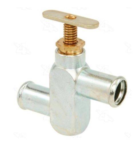

One other thing... I added one of these manual valves (find it on eBay) to the line not regulated by the valve to completely block hot water from the heater core. Since the heater rarely gets used, it's not a big deal to open the valve if you need heat. In fact, I've used manual ball valves to replace the vacuum heater control a couple times until I found an affordable heater valve! Just gotta open the hood to get heat.

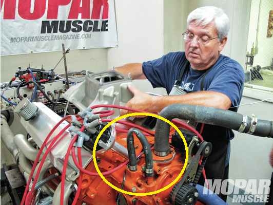

Why did engineers add expense of a 4 port than a simple 2 port? Maybe they found added pressure on the water pump when using a 2 port since it cuts off flow or adds backpressure? Or coolant is starved to the engine? Maybe they changed this defect after 1972 on all 440's? I don't know.
(To change to cable, I'd have to rip the dash apart. Too much work) I really appreciate all your help. I guess I'll play around and let you know in the summer.
Even Dyno testing, they don't just simply cap it off. I don't know.
Screenshot 2022-12-18 at 16-59-13 how does coolant flow in a Chrysler 440 - Google Search.png
This was probably ready to go into a car, so they just did the easy heater hose loop... Don't be afraid to use some pipe plugs to block it off. There's no function except for the heater... I've done it.
Notice that the loop (circled in yellow) is kinked closed. If these are connected and allowed to flow free, it will/can rob flow in the cooling system and can lead to overheating. DAHIK Lindsay
