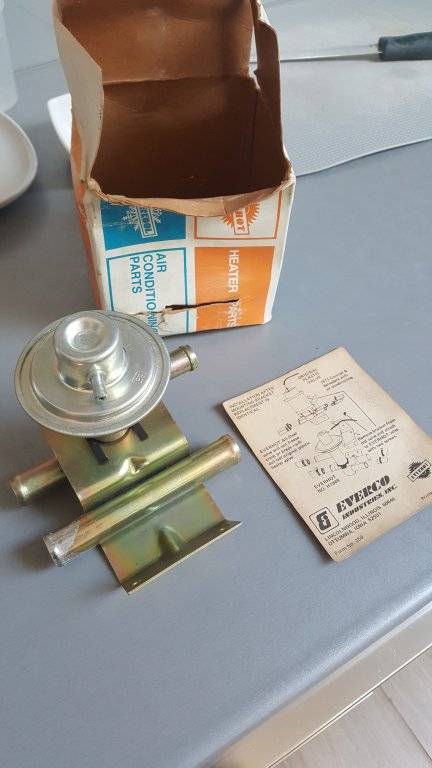

Read a bit more on the topic. And the one i have now from a VW works like most vacuum operated valves -w hen it gets vacuum it closes. That why on the temp bar i have to have the temp set to hot for it to blow cold, and on cold when i want hot air. Also don't have blend. Well i guess the VW wasn't designed to work with a Chrysler ;) The plus side is it doesn't leak, and it's a really small and sleek design. Kinda surprised it survived the baking heat in the engine compartment - really hot in the summers!
