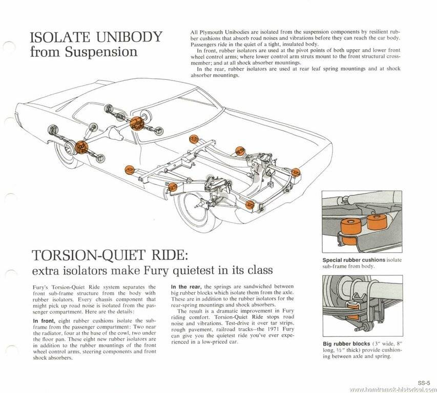

Torsion quiet ride was a huge advertising point across the mopar C-body lineup in '71 even though it was 1st used in 1970 on all civilian C-bodies besides convertibles off the top of my head.
1971 Fury Brochure

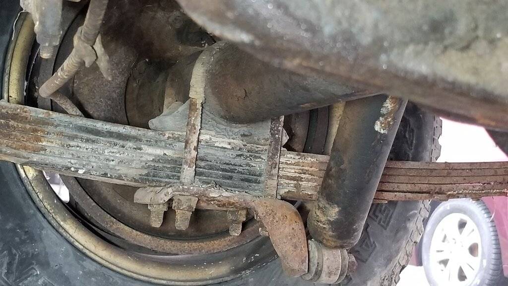

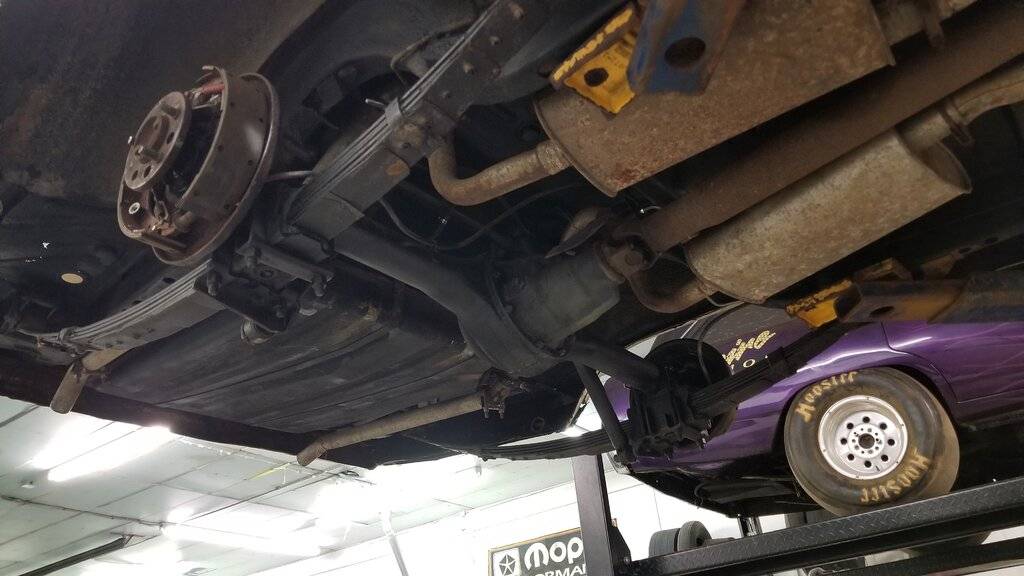

My '71 PK41U does not have the iso-quite rear as expected being a police package. It does have the 7 leaf spring pack. My friends '70 300 Hurst has an isolated 7 leaf pack.
1971 Fury cop car with non-isolates 7 leaf pack
1970 300 Hurst with isolated 7 leaf pack
1971 Fury Brochure
