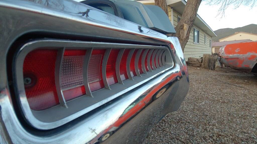

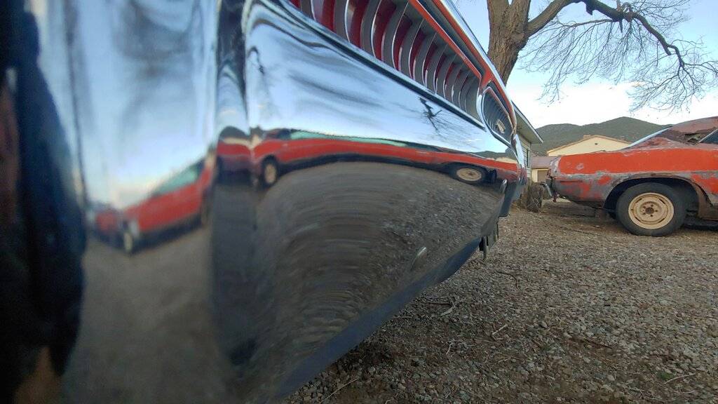

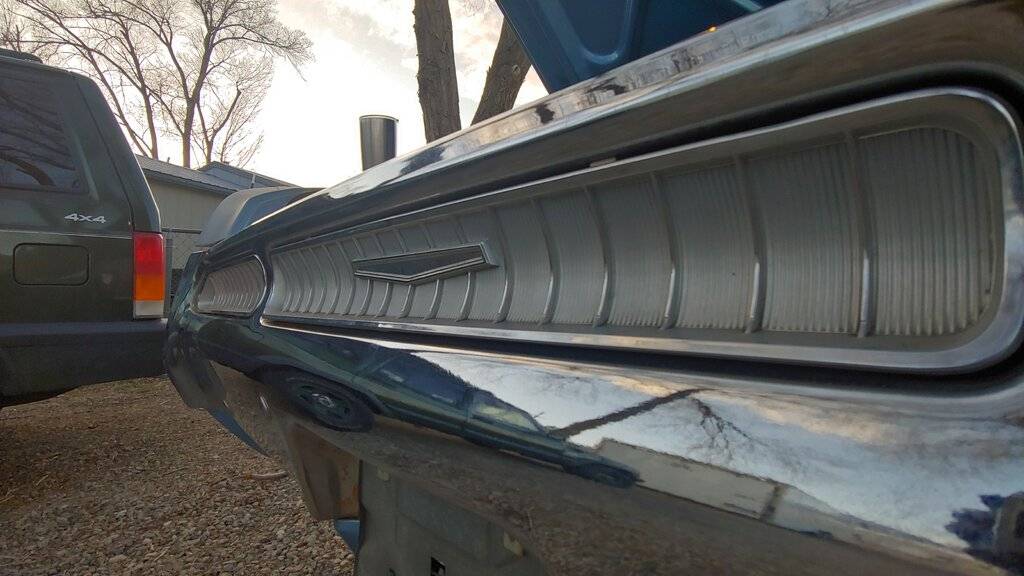

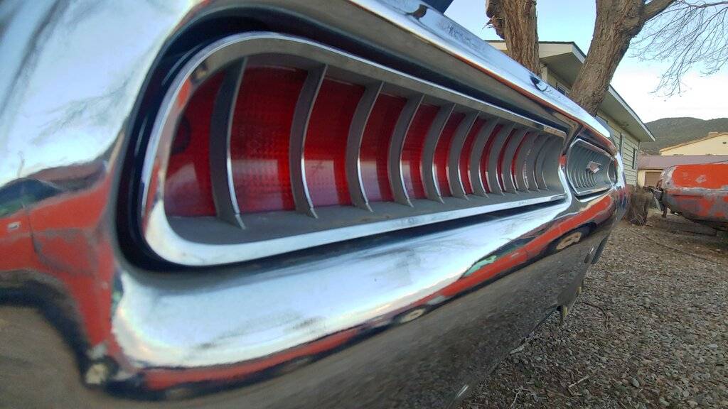

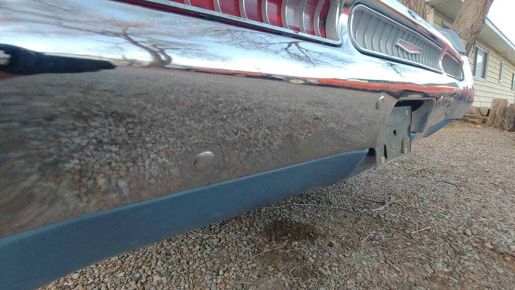

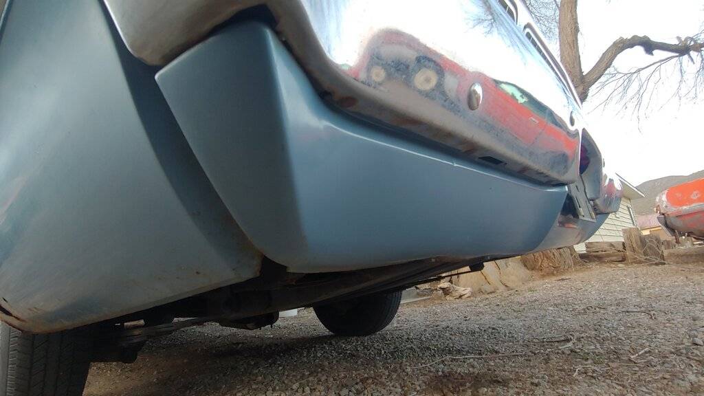

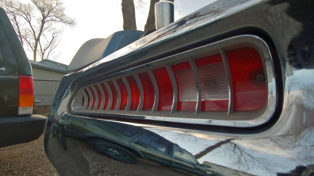

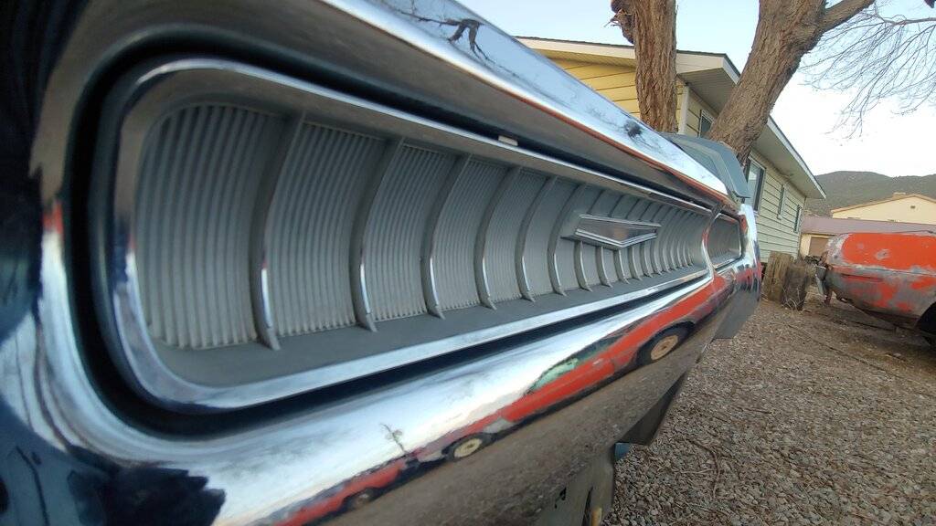

Looks good! Really nice to have the tail light lenses in good shape.. Pretty difficult to find for some of these models.rear bumper is super straight and the lights appear to be in very nice shape. Not very faded.

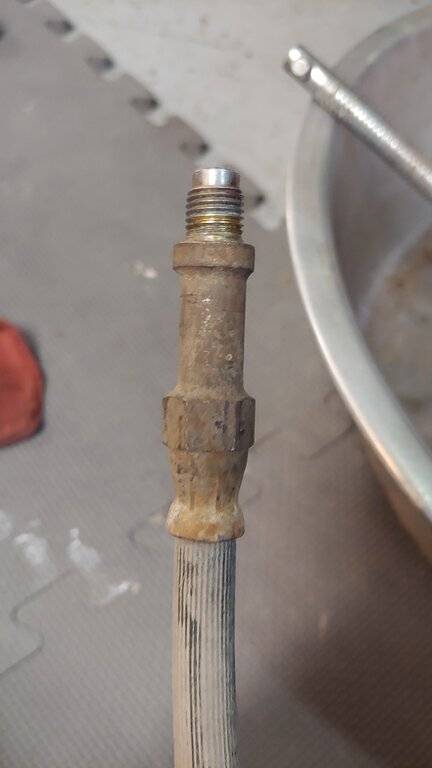

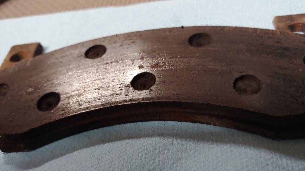

Do you have access to an air compressor? When my passenger front caliper was frozen I clamped it in a vice and with some compressed air the piston popped right out. Turned out that the piston was shot, terrible rust pitting, so ended up replacing both front calipers. I doubt it will free itself with further use.I'm considering cutting the rubber hose side in half at the crimp and tapping in threads for a grease zert. That way I can push the caliper out.
But I'll probably throw it back together first and just see if that little bit of movement frees it up enough for daily around town driving.
If air didn't work I think you could also try to use brake pedal to push out the piston. Remove caliper from rotor but keep brake line attached. Then start pumping the brakes. Can even try with engine running for extra brake boost. It should pop but don't keep your fingers close.Seems to work fine now. The calipers and pistons will be addressed. At least now I can drive it down to the cop shop and get her legal for the street.

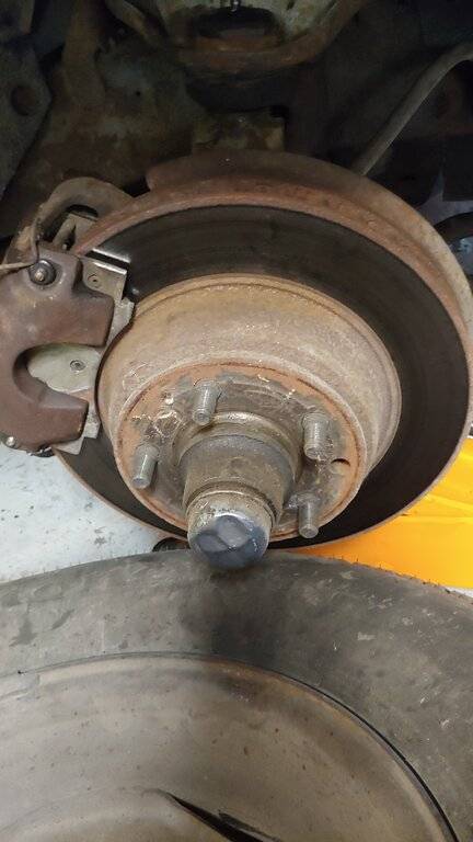

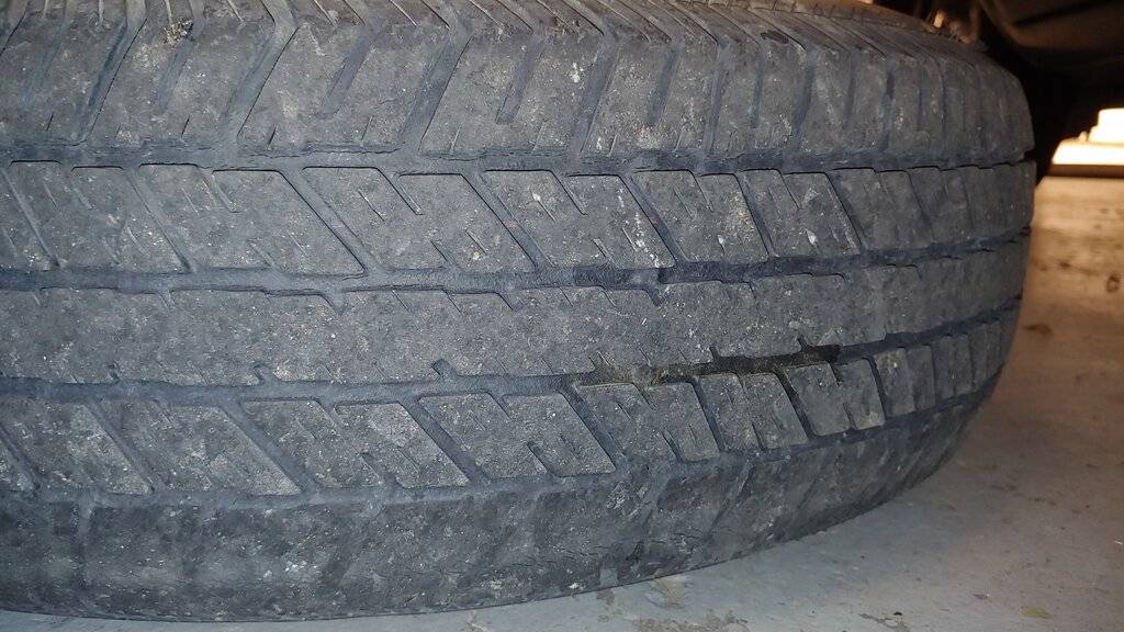

Could be, have you checked the ball joints and tie rods?The car pulls to the right when running down the road. I have to keep my hand on the wheel. The picture shows how the tire is wearing on the outside passengers tire.
Is this a ball joint issue?
