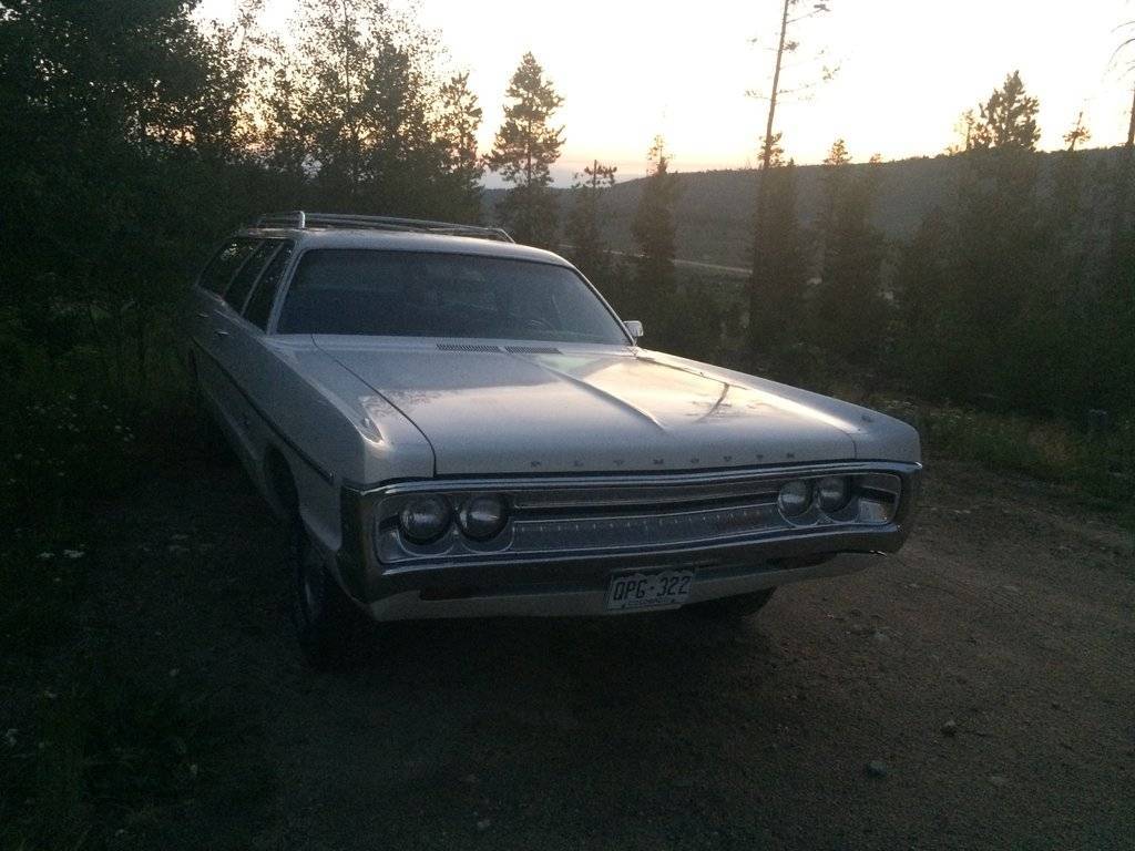

    New alternator, voltage regulator, new battery, New battery terminals. After charging battery is fully i can drive around about a few days to aweek and battery is dead again. Can jump start car and run fine so alt is working proper. Any ideas? Please and thank u.

    It's the 360 engine.

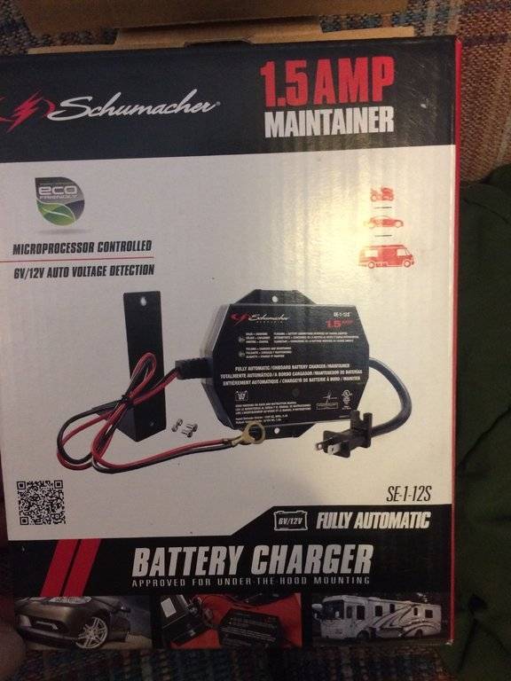

    Thank for the video I will watch n try n hunt it down. Glove I will check rear cargo goes off when door shuts. But I'll check that again. For now I bought a under the hood trickle charger so my battery doesn't sit dead as I know that can be bad for them.

    The battery tender might keep the battery changed, but it also keeps that "short" operational longer, which might not be good if it generates heat.

    I agree the battery should be disconnected when the car is not in use. Those trickle chargers make me nervous. This issue should not be hard to hunt down. Although a multimeter is more precise, there's another way.
