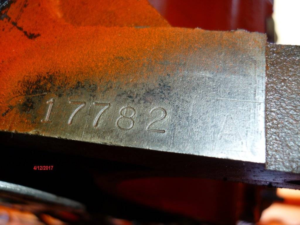

70bigblockdodge said:
What numbers/letters are on pad in front of the passenger side head? Read left to right top to bottom standing looking over the pass fender.
400 was made until, 78-79.
________________________
NO numbers visible on the LH passenger head.
The STAMPED number " 17782 A " is located on the bottom of the left corner of the block above the oil pan.
I would like to know how to DECODE this number.
Thanks again,
LG,
Mike
On the block is a section of machined pad (same as deck surface that the head bolts to). It will have the info on it. It is hidden under the distributor/behind the alternator. The numbers on the passenger side rail above to oil pan is the sequence number, or last digits of the VIN the A is most likely "A" line. Later cars did not always put the whole VIN on that pad by the rail.
The one up by the dist will give you year, date, irregularities, HP designation
