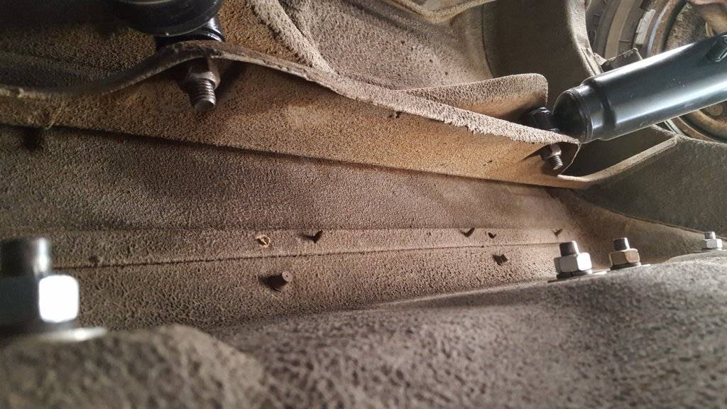

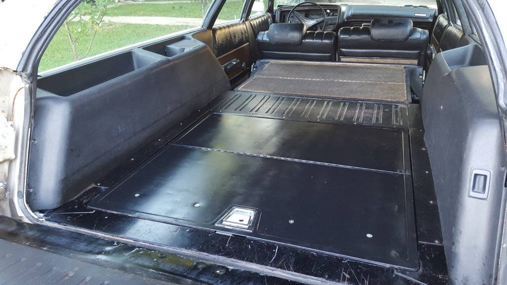

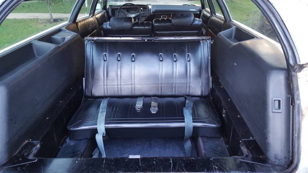

Got the floors drilled for the seat belts. Side panels were cleaned up and reinstalled. Things went back together nicely. The kids like riding in the back, we are all happy with the results. Thanks again Mike (Wonderwagon) for selling this seat!

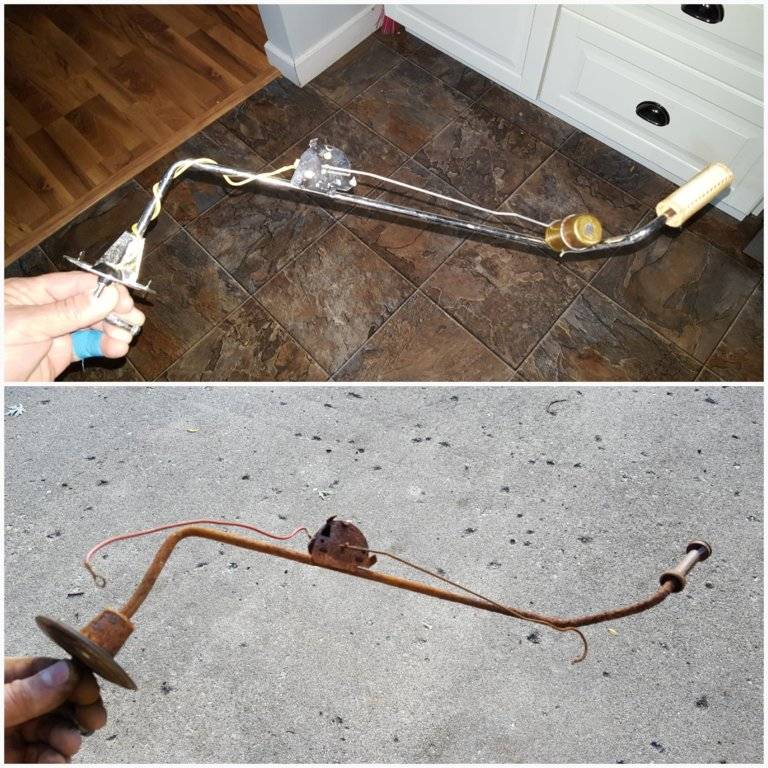

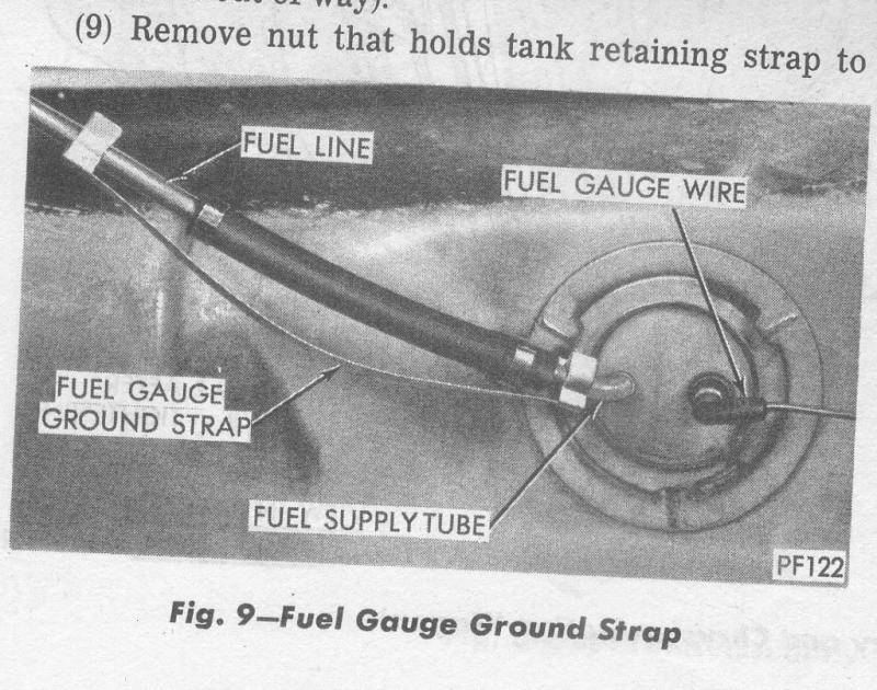

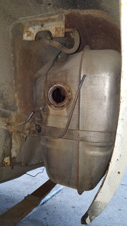

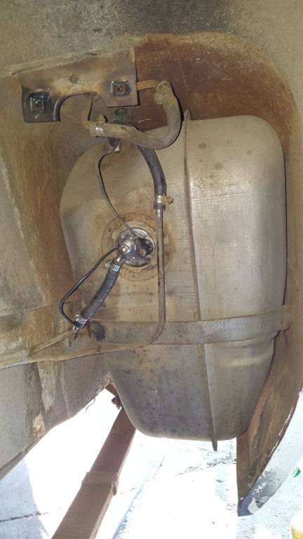

Is anyone in the position to share a picture of where the fuel tank sending unit on a fusie wagon should be grounded? Im replacing what appears to be the original, and there aren't any ground straps in sight. I thought I remember reading that there should be at least two.
There should be a metal clip that jumps the gap from one side of the rubber hose to the other to ground the sender.
Lol dang man you are quick!
Hmmm, no that strap is AWOL, will have to remedy this situation.
Thanks again Sir!
Those straps are available reproduction, but you could just use some hose clamps and a piece of wire for the same results.
Thanks again Jeff, I ended up soldering a ground wire in place. No more red "FUEL" light and the gauge works...what a relief!

Is anyone in the position to share a picture of where the fuel tank sending unit on a fusie wagon should be grounded? Im replacing what appears to be the original, and there aren't any ground straps in sight. I thought I remember reading that there should be at least two.View attachment 221445 View attachment 221446
Who's sending unit did you purchase?

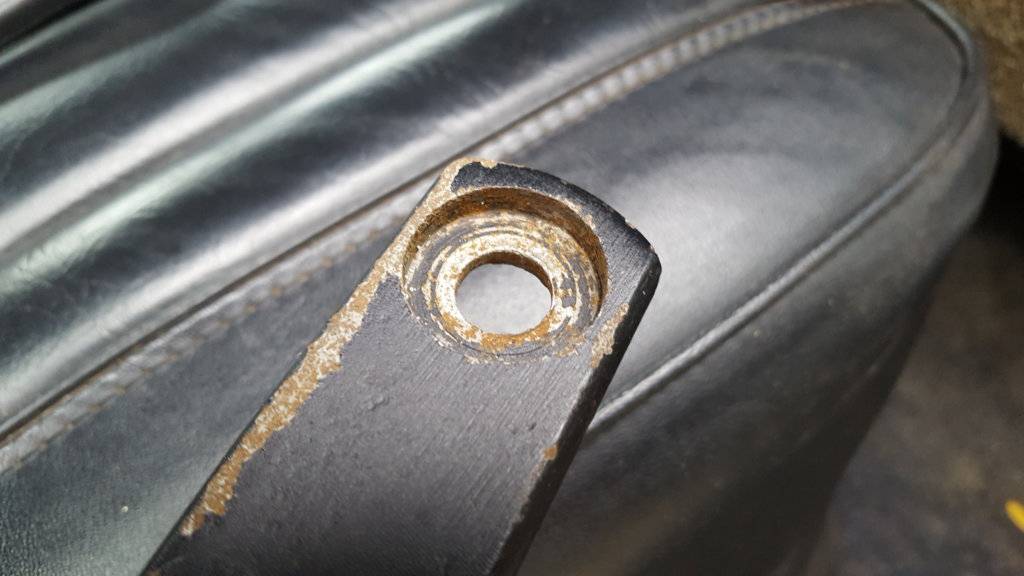

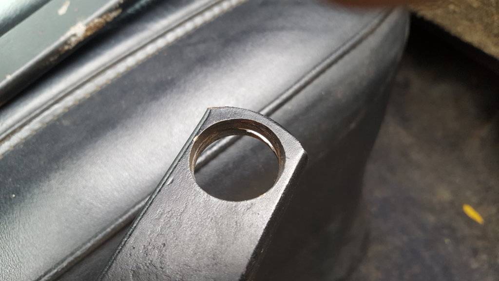

While out junkyarding with Manny last week I was able to find a good seat bracket for the middle seat. For whatever reason this countersunk hole broke through on mine.

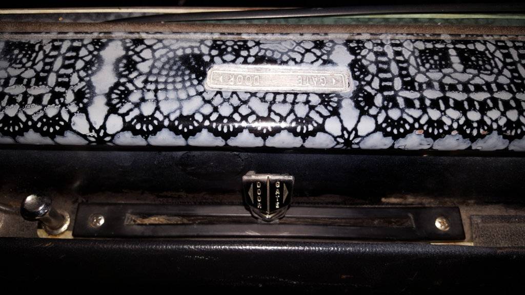

Picked up a good plastic cover for the tailgate lever. Also installed the proper stamped GATE/DOOR tag

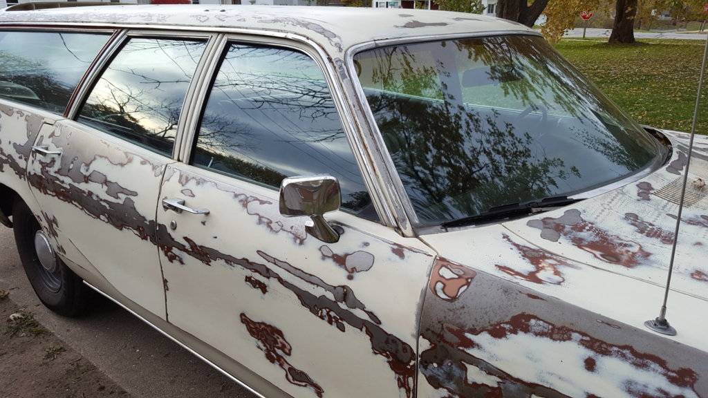

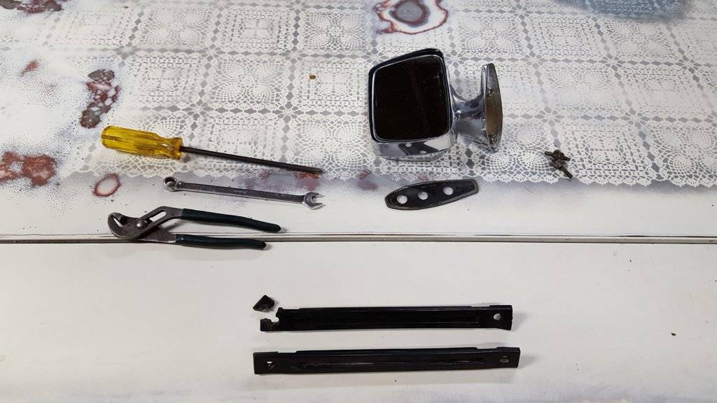

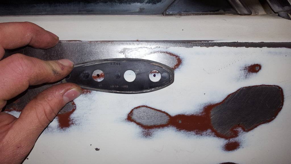

Let me mention that a 71 Polara mirror is different than a 72 mirror, found out the hard way. Good thing I also grabbed one from a 73 Monaco...its the same as a 72.
Installing a right mirror is a huge upgrade for me, it's so much nicer backing in and out of the garage. Highway commuting is easier too.
