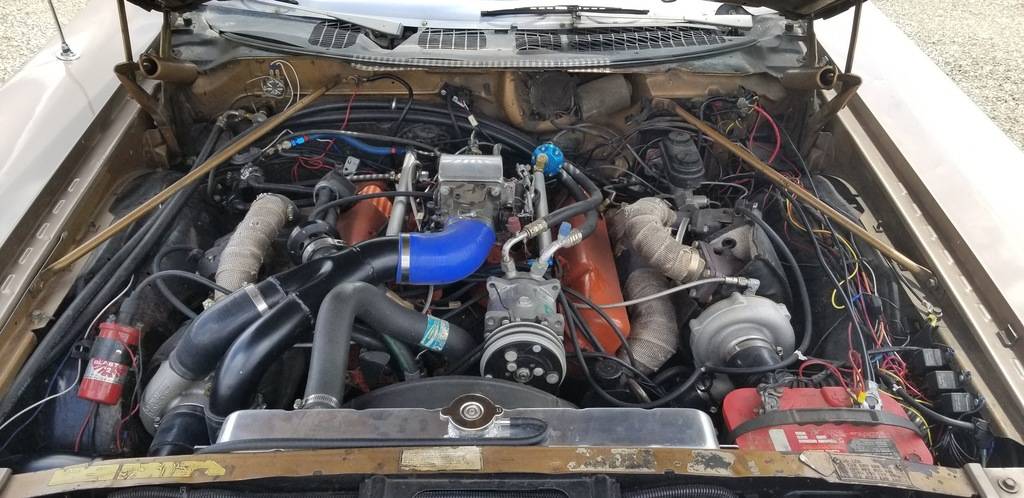

For the cost of those headers you could have the hard parts you need to make the turbo manifolds....
Or use the upside down chasis/van ones I did.

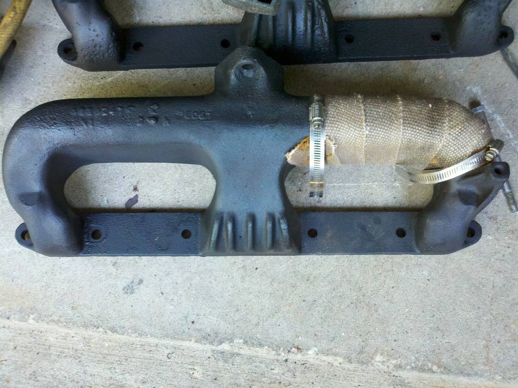

these
iuHe3UGaVmhYlHccICbEpKqadlFiruLD9gJ2bfscM11OWDAOsJfofC7SGL64DfnSAfCMOVqjmy5DvrWYf=w1634-h1225-no.jpg
found on vans and various chassis, tho only on one side. I turned them upside down
ooguQR5i9AZFU3fIh_JwkToNA0AHkKlfRHvU_2A2b1csRvz89AihP0vXzQbx-KcuQkyQDHk6u2hdd0Hpq=w2213-h1076-no.jpg
I see now. I found your intro post and saw that pic but didn’t understand what I was seeing. Did you use the same manifold on both sides?

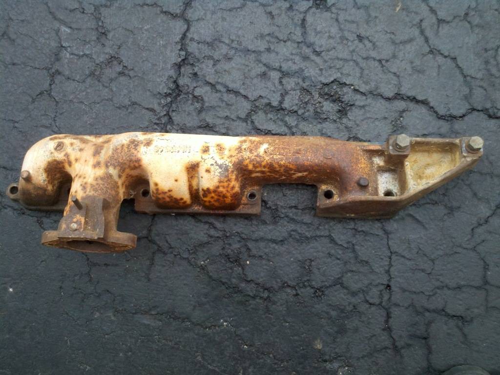

Yes I did. I looked at a bunch of combos of manifolds, decided on 2 upswepts. If I was doing a single turbo I would use this one probably plus a log on the dr's side. It's an early BB manifold with provision to mount the generator, great place to hang a turbo!
ZBcDNlD4Lu8EBtxkqd_ZUtRANLQYAEqvJuMH2YR4OVj56v0ewddaWV5bM61A5H_5ZjMDmQOK5ZC0hoPBO=w1634-h1225-no.jpg
