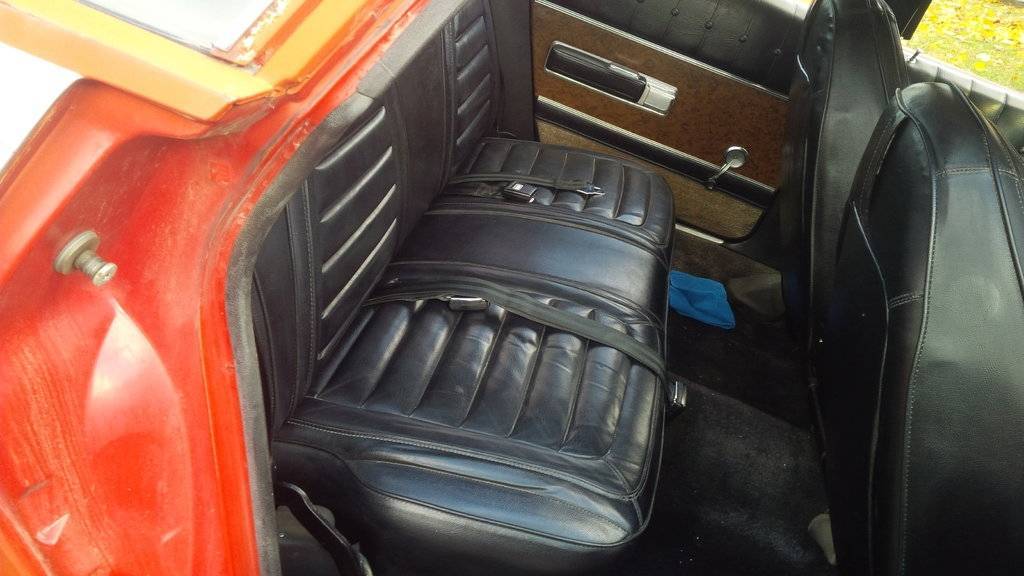

The carpet on my door panels should be black....they are just faded. Has anyone had any luck dying carpet?

I have found that vinyl spray actually works very well on my carpets, at least the black ones. The spray cans even mention that as one of the applications. Even lightly sun bleached carpets look like new again.

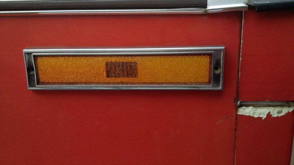

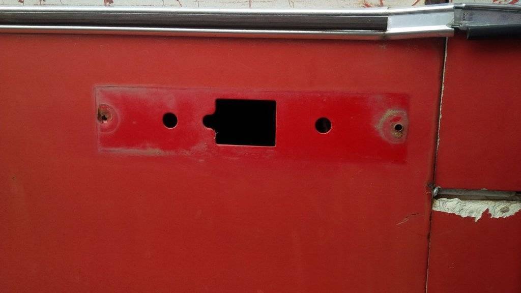

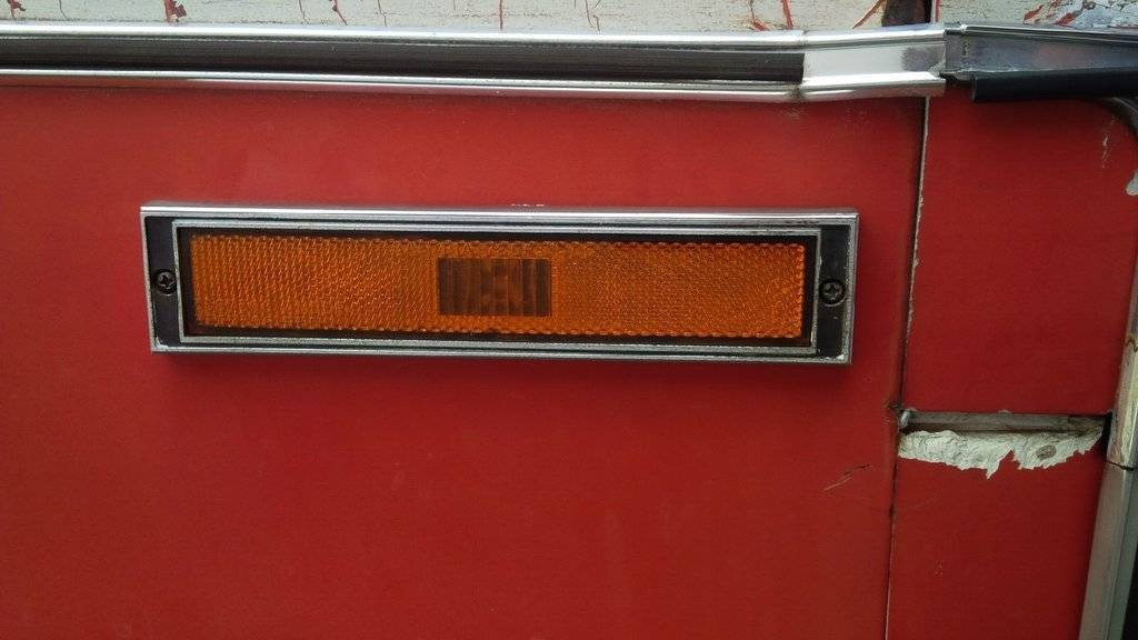

Went to a Mopar Show on Saturday and got a couple of small parts for the Monaco...winning lol

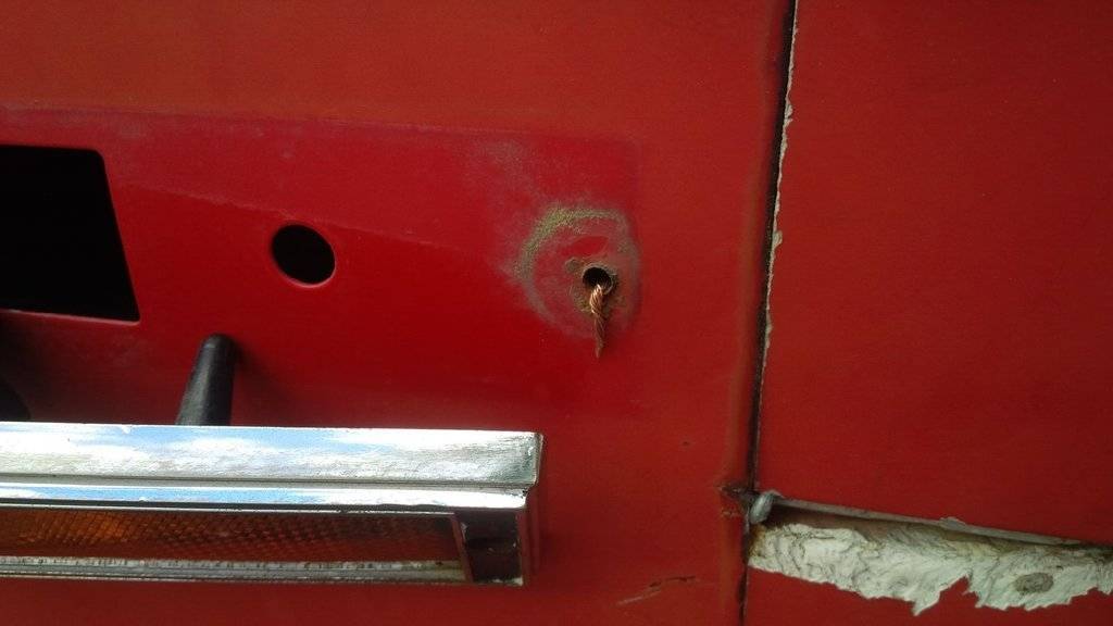

Nice thing about this car it is soo original but someone still managed to strip out a marker hole. My fix is just to add a bit of scrap wire in the hole and then screw in. Doesn't have to be overly tight. Micky Mouse I know...what do you guys do?
Is that a spray dye you have been using? If so what brand?

I use SEM - it seems to be the best, longest lasting for me. A backup is the Rustoleum brand usually available at Pep Boys if you have one in your area. I just needed black last time for my carpet, and it worked great too.
Dave
Whatever works. Maybe put a small piece of wood behind it held in place with your fingers another piece on the front and gently tap with a small hobby hammer to flatten the metal around the hole, if you can do it without damaging it further. Depends on how 'wallered out' it is, I suppose.
